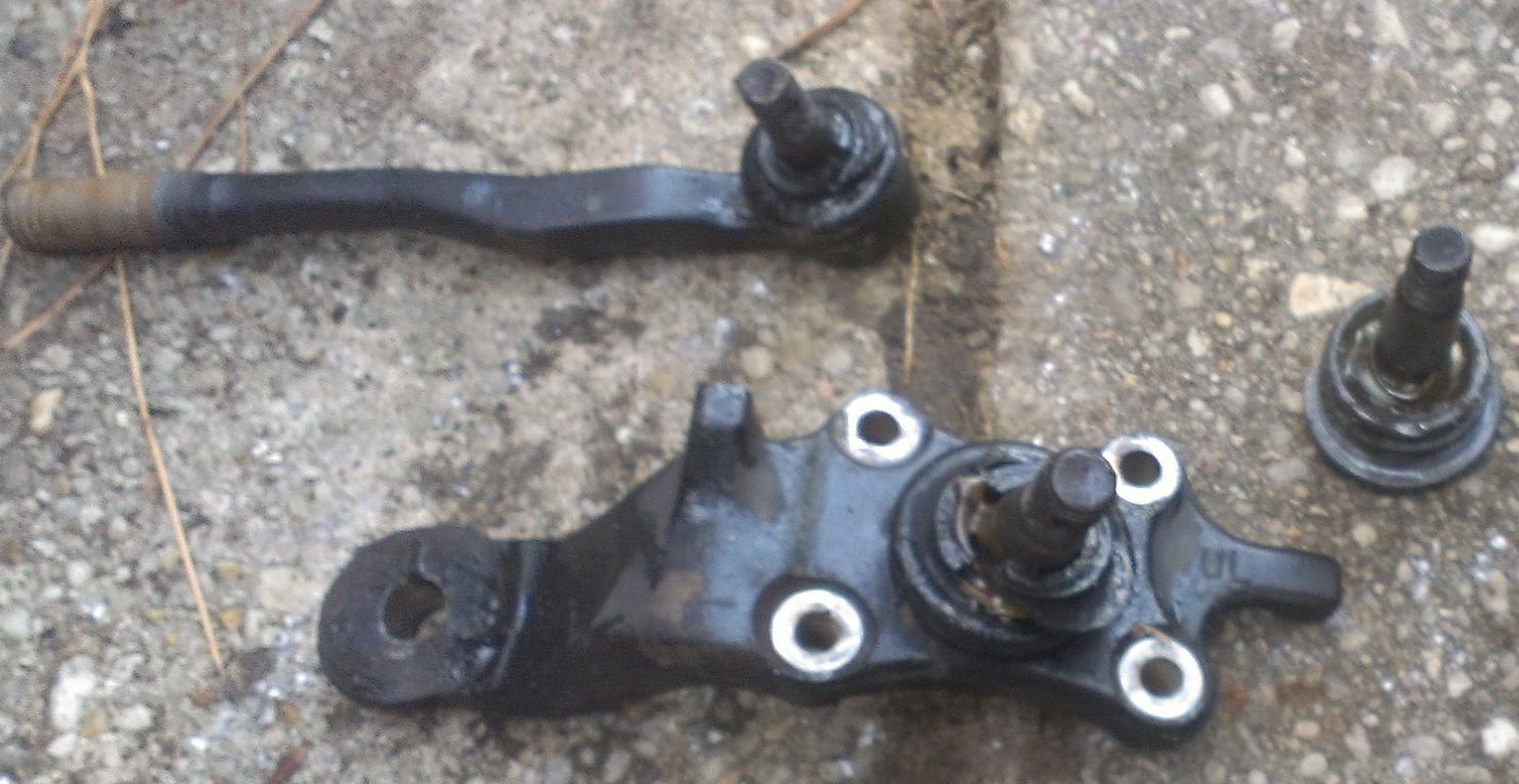

i have a 97 also and just recently did my lower and uppers the lowers were so bad that they were about to fall out of the sockets and the only tension left in them was from what was left of the rubber boot. The uppers were trashed as well tie rod ends could have been better but no where near as bad as the ball joints. Don't believe them they will go bad and possibly fail
