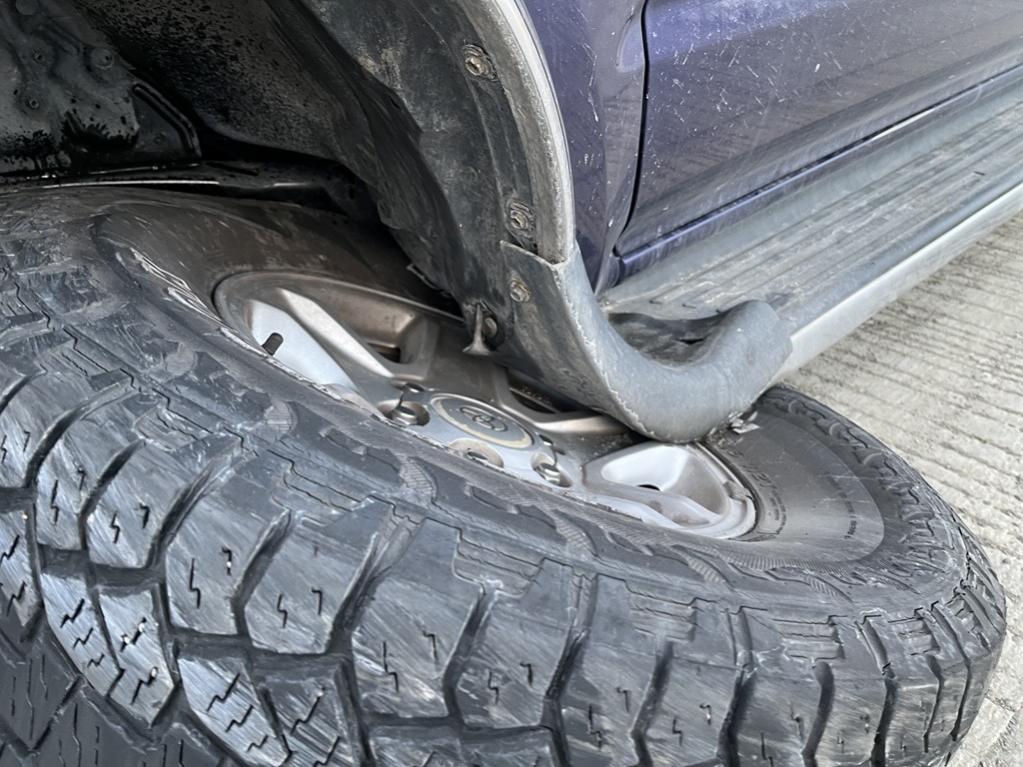

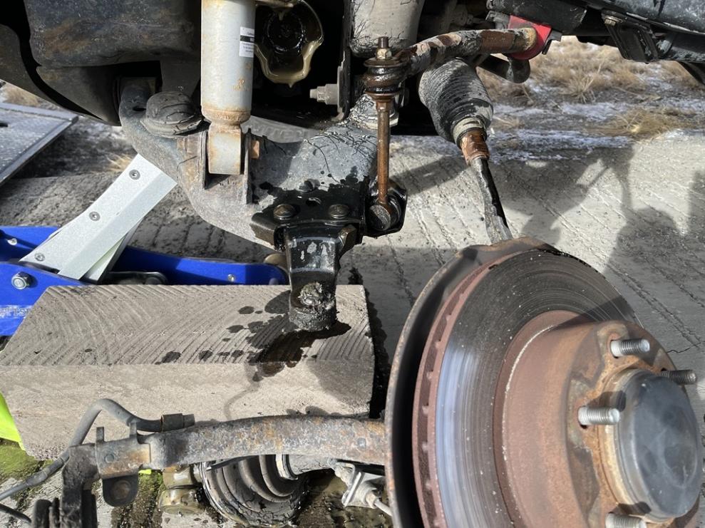

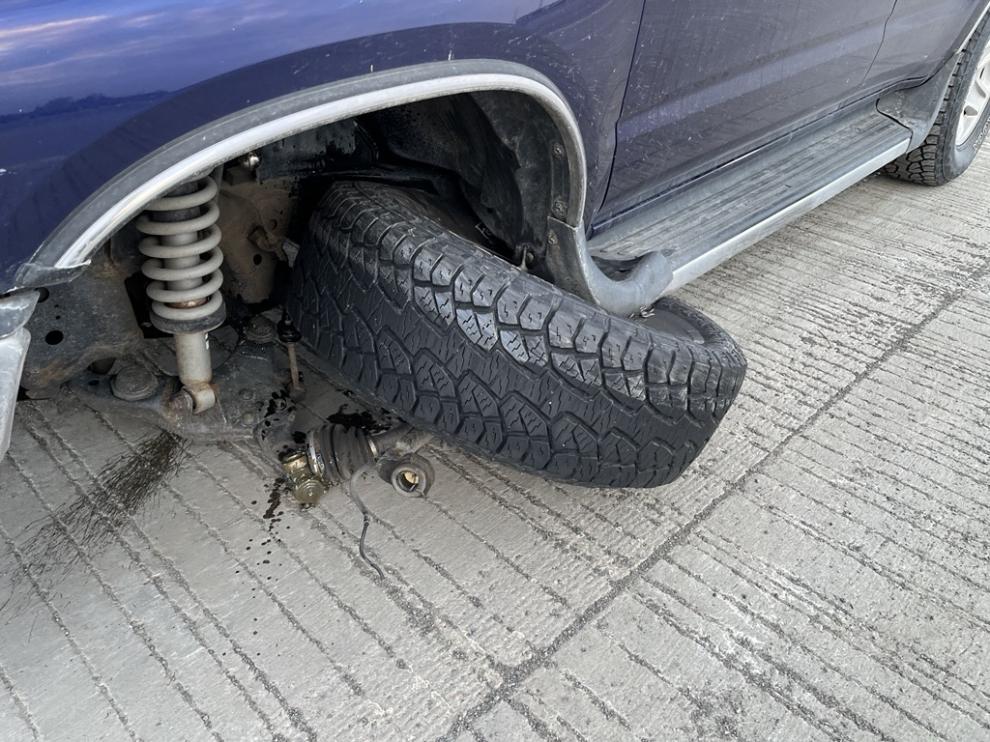

Lower ball joint failure story 2025
Greetings, first post.
I wanted to share my story of a failed lower ball joint on a 2001 SR5, stock, no lift, 218k miles. The driver's side lower ball joint failed while traveling on the Interstate at 65mph. KABOOM!
Somehow, the tire/rim/assembly wedged under the front running board (like a ski). The brakes failed, too, so I had to dodge morning rush hour across two lanes, pull out of a spin and glide to a stop in a place suitable for a wrecker. I was very lucky.
The lower ball joint recall from Toyota on this vehicle was performed in 2006 by the dealership.
This is evidently still a problem for post-recall vehicles which almost put me into a ditch and ruined the vehicle (or worse). If the tire/rim had not become lodged like it did it is my opinion that things could have turned out quite differently. The only part holding the tire, rim, and brake assembly was the steering linkage (!).
PLEASE BE AWARE OF THIS DEFECT ON POST-RECALL VEHICLES AS THE PROBLEM EVIDENTLY PERSISTS.

Well, they didn't change the ball joint design. Oh, and they aren't lifetime parts - your lower ball joints were 18 years old with probably >150k miles on them... If the boot was damaged and allowed some grit to get in there or corrosion to happen, this will be much more likely to happen.
Glad to hear the damage wasn't worse, and hopefully you used OEM parts. The aftermarket ones last about 1/10 as long as the OEM lower ball joints.
-Charlie
That's nuts, but glade you are safe and the 4runner isn't damaged that badly. Yeah ball joints are a wear item and need inspection/replacement over time. Have the ball joints been replaced after the recall was done? 19 years is a long time for ball joints.
