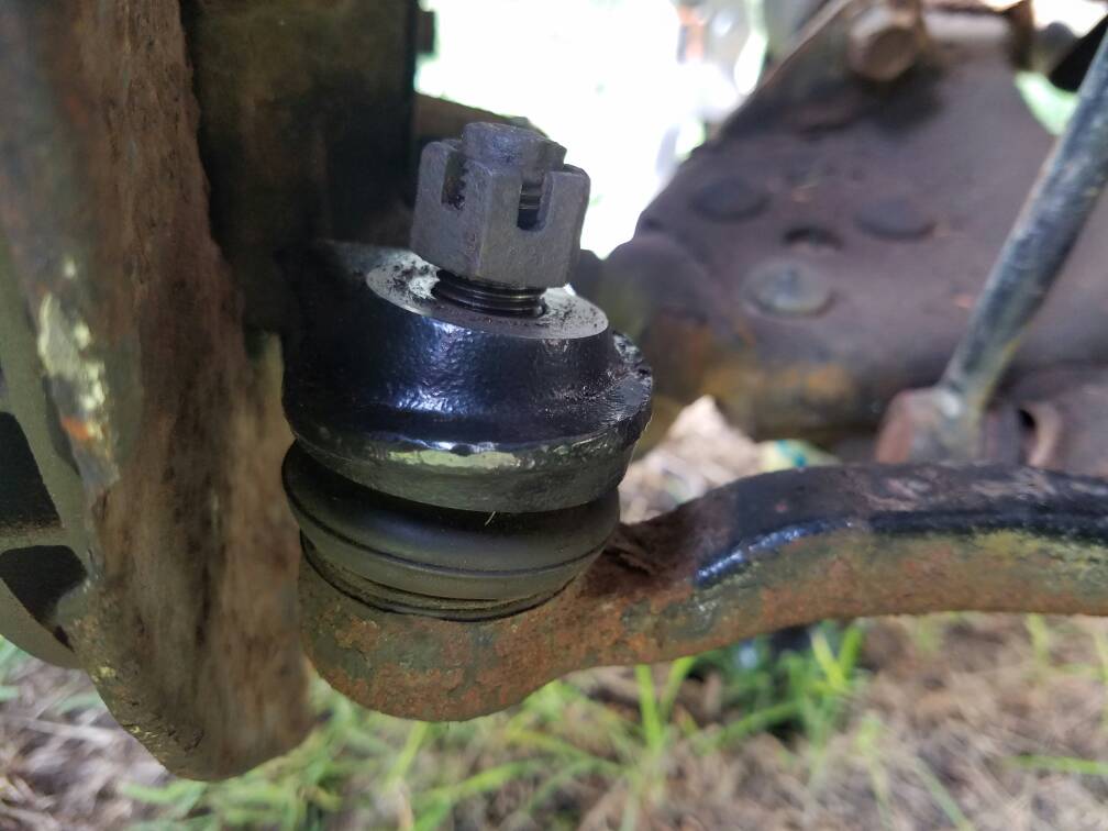

It felt like I was able to freely push it all the way up to the tie rod boot

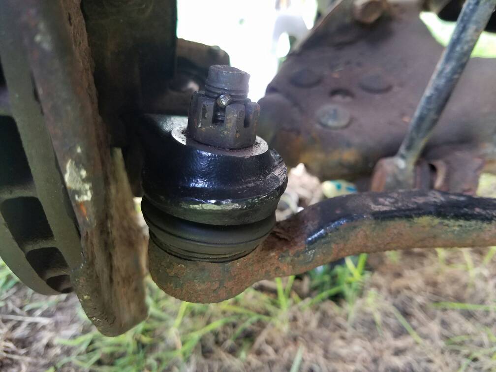

Alright guys, I was able to take another look today. The castle nut did not bottom out like I thought. There was plenty of thread left on the bolt. I took jayrolla's advice and gave the tie rod a little love tap on the underside. It worked like a charm. The bolt bit right into the metal and held the tie rod ball joint in place for me to torque down. From my original viewing angle it was hard to see the threads. Once the bolt started spinning I though it had reached the end since the hole for the cotter pin lined up so perfectly with the bottom of the castle nut slot. After a little hammering I was able to torque the nut down and I'm good to go. I've only changed 1 LBJ out, I might do the other side tomorrow.

Before
After
