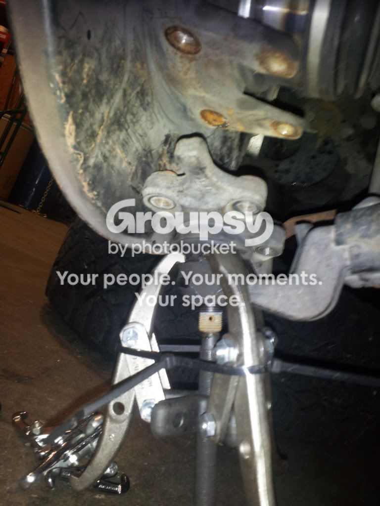

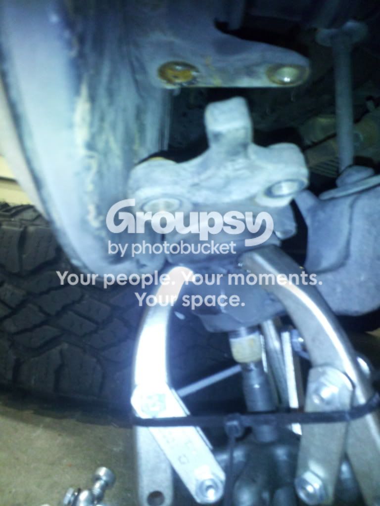

yeah a pickle fork should work since you're tossing everything anyways, i managed to use the jaw pullers with some zip ties to get it to go. you got to fool with it to get the tension right and everything lined up before you start wrenching on it, also if you think these maybe used again go get a good pair from northern tool or something of the sort.

Pullers worked for me as shown above. Except mine is a bit smaller and my larger one wouldn't fit. I think it's a 5T, and my larger is a 7T.
