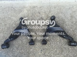

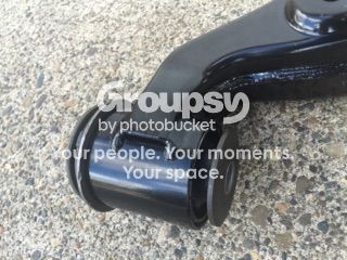

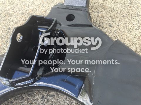

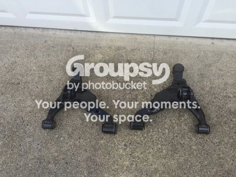

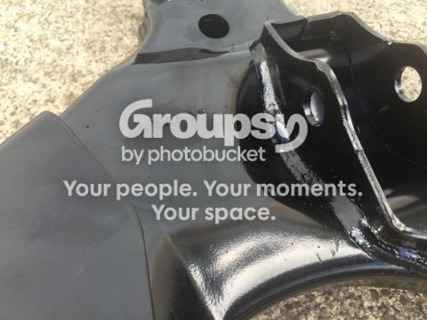

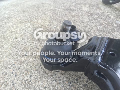

From what I can tell, I don't feel the 1A Auto's *look* like they are a "cheap" part. I'm certain they will be fine LCA's.
Pics of the 1A arms:
