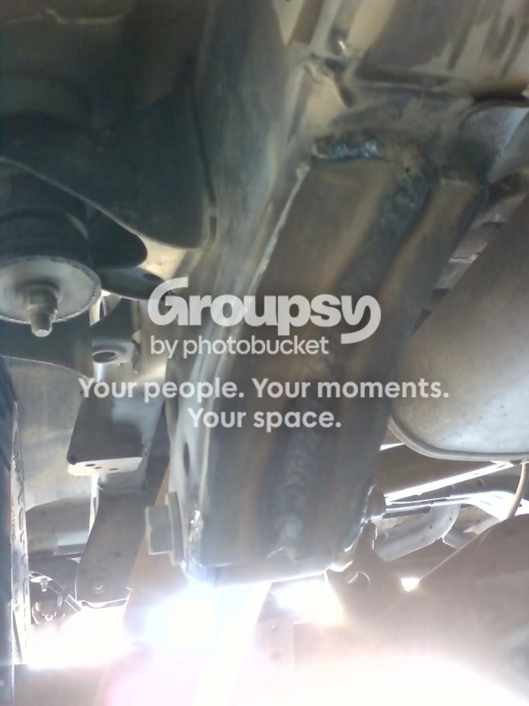

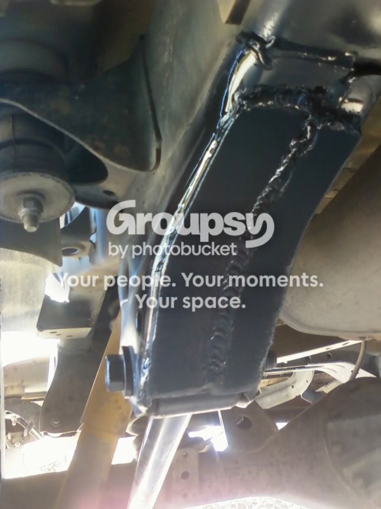

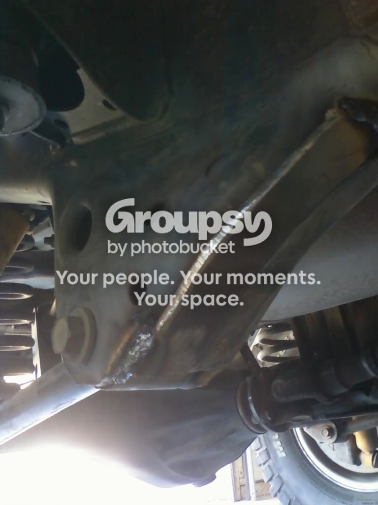

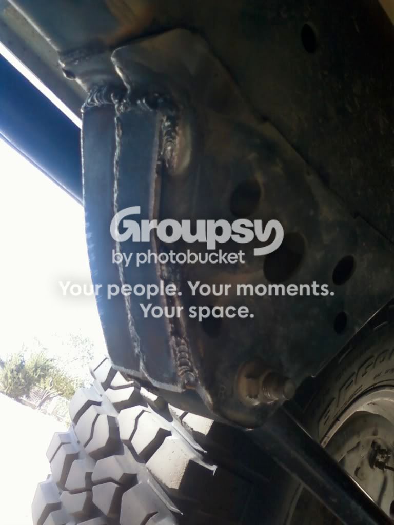

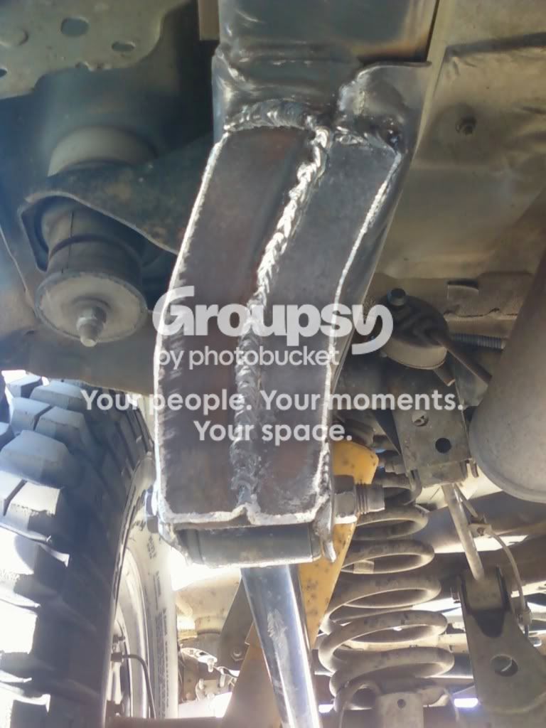

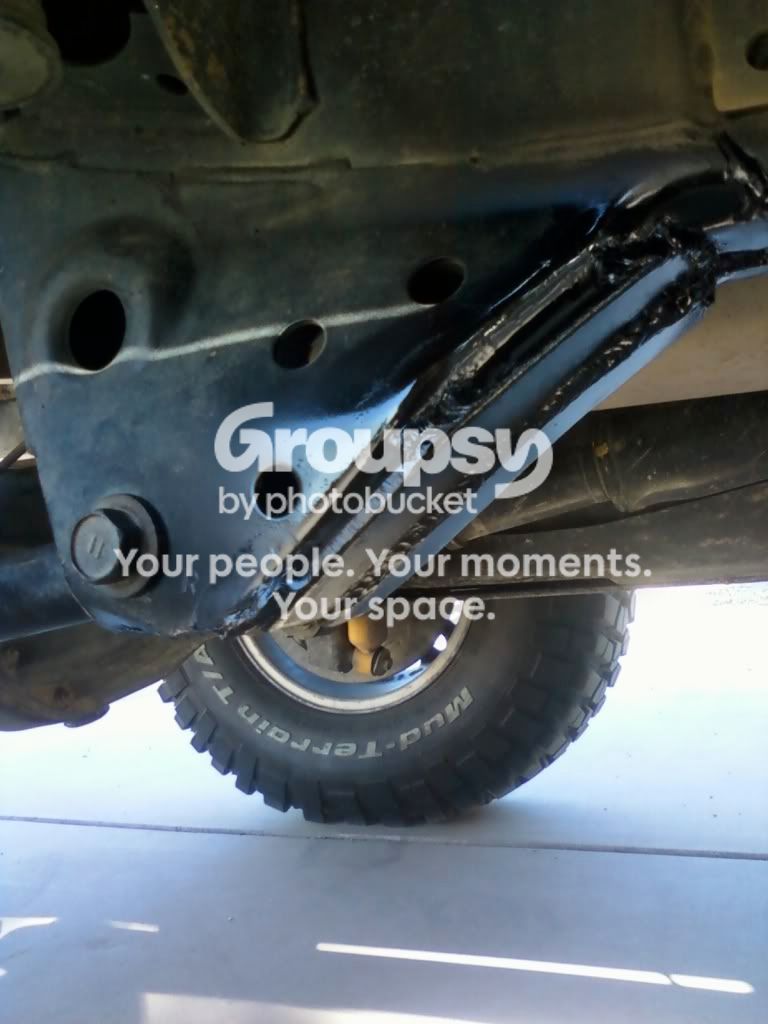

Here is my take at a skid for the lower control arm. Brian2sun's 4runner is going to get some in a week as well
I made strips out of 1/4" and just welded the strips to the LCA mounts.

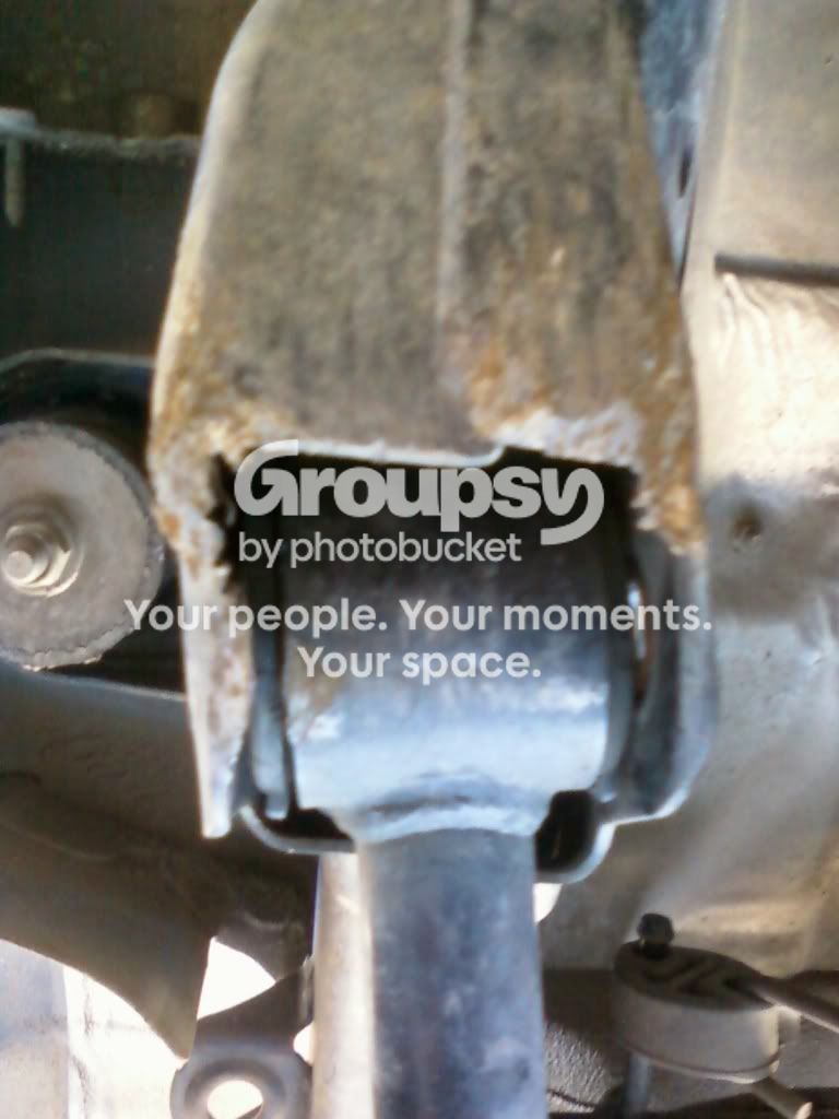

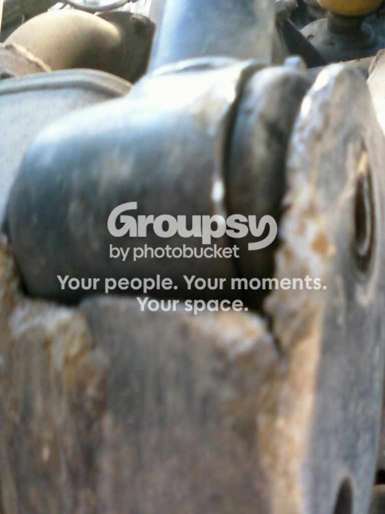

Here is a before Note the crack!

sorry this one is blurry

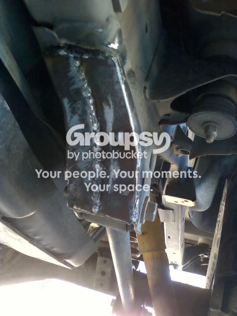

In the process
1009101559.jpg~original
BOOGER WELDS!!!!!!!!!!!!!!!!!!!!!!!!!!!!!!!!!!

FInal product. Spray paint covers up booger welds quite nicely.....
1009101602.jpg~original
1009101602a.jpg~original
Sweet, I've didn't see this thread yesterday. Looks good in those big pics (a lot better than on my little phone's screen). Those welds don't look too boogered - especially for stick welding!
well the side next to the gas tank is the ugly one. I was concerned about sparks and the tank so i rushed. I was kinda shaky too, well i was welding in a tee shirt and getting burned lol
A tee shirt, so you had full protection then! :biggrin2:
