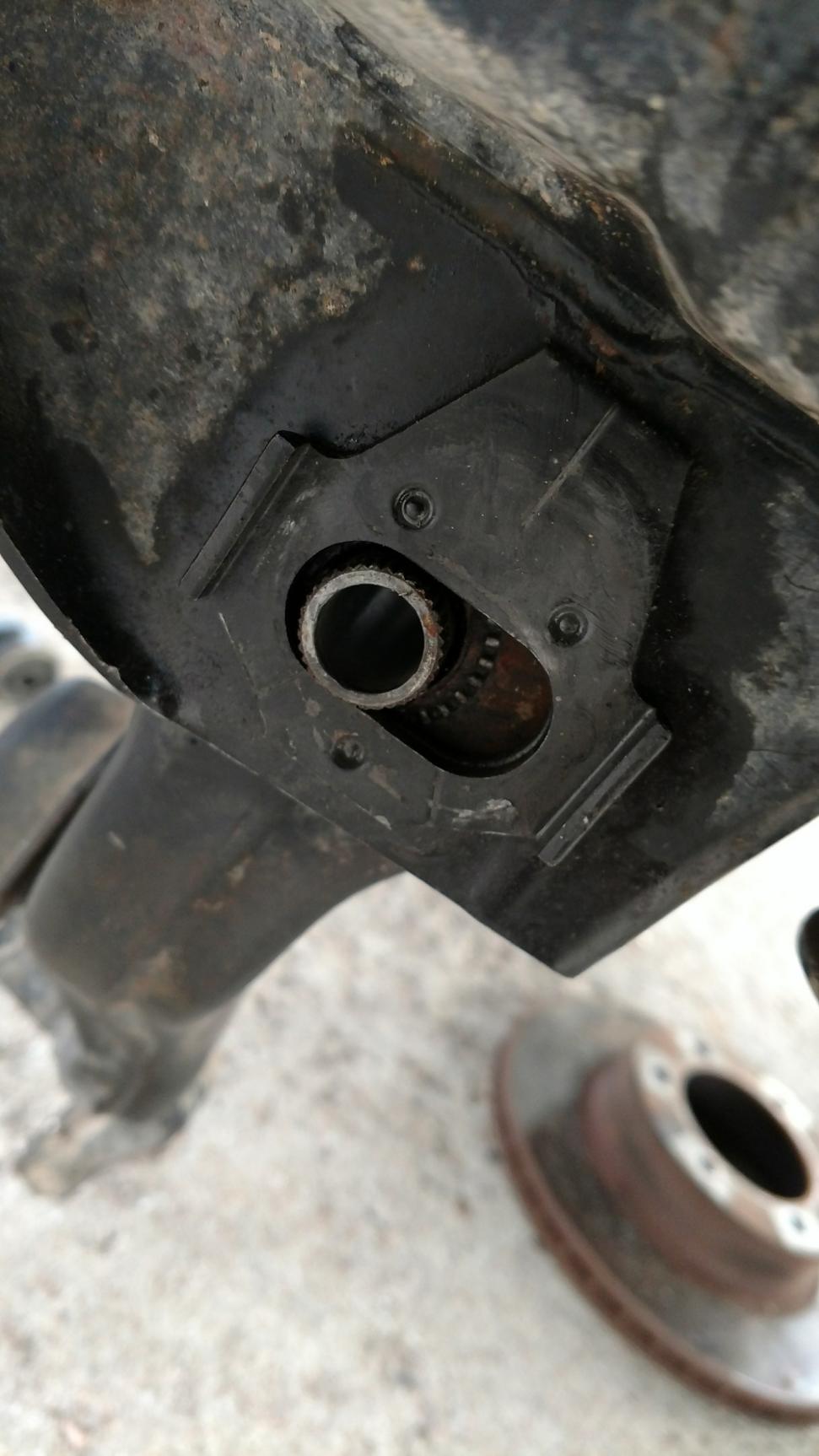

I've spent the better part of the day trying to remove my lower control arms. The cam bolt sleeves are seized to the inside of the bushings. I've tried a BFG, bottle jack, sawzall, torch and so far they have not budged a millimeter. I've got another set of LCA's with Whiteline bushings ready to go in so I don't care if I have to destroy these in the process. Any ideas I haven't thought of yet?

Sorry to disagree, but PB Blaster ain't going to do shit when these cam adjusters are really rusted in there. These things can get seriously welded in there and your only choice is to cut them out. [MENTION=144752]MarkamisPrime[/MENTION], [MENTION=102606]infamousRNR[/MENTION] and I did LCA bushings for a member visiting from Colorado and both passenger side bushings were frozen. We pounded on those f*ckers and they wouldn't budge and this was after the guy PB Blasted them for a couple days in advance.
I had to go to the local Home Depot and by myself a reciprocating saw. Since I already owned other Milwaukee M12 tools, I bought the little saw they sell. It's not super powerful but it got the job done. You need to use new metal blades. I used 2 blades per bushing - one for each side. You have to cut the the cam adjuster sleeve on each side of the bushing to get the LCA free of the frame.
Get yourself some fresh metal blades from your neighborhood hardware store and go back at it with the Sawzall. Trust me, you may have lost the battle but YOU WILL win the war. It's tiring cutting those sleeves but it can be done. If you find you don't have enough room to get the blade in on one side or another, just grab a prybar and force enough of a gap so you can get the blade between the frame and bushing.

Dude... like Joey Gladstone says from Full House "cut, it, out"
The video we made shows an easy removal... but like Tim & Mark said.
CUT THAT MUTHA F*CkER out of its shelter. Seriously Mark & I slammed on that thing while Tim was at the store buying a reciprocating saw.
Once we started cutting it out, the repair was back on track time wise & my ears stopped ringing from banging on that thing with a hammer!
OP you need to cut it out. Forget any metal blade and only buy Diablo Carbide tipped blades from home depot. Cut mine out like butter. Diablo 9 in. 8 tpi Steel Demon Carbide-Tipped Thick Metal Cutting Reciprocating Saw Blade DS0908CF at The Home Depot - Mobile

Thanks guys. I'll keep at it with a better blade. I was cursing you [MENTION=120071]mtbtim[/MENTION] because I watched your video as prep and yours practically fell out, lol.
Thanks [MENTION=50342]JayRolla[/MENTION] I'll grab those Diablo blades in the morning and report back

You were right [MENTION=50342]JayRolla[/MENTION] that carbide tip Diablo blade made 4 cuts in less than 5 minutes. Now I was at least able to get that corner buttoned up with TC UCA, King coilover, new LBJ and the Whiteline bushings before the ice storm came in last night. I was too cold to put the TBU and SS lines on. Now I just have to wait for this weekend for more 60 degree weather to get more parts on.
