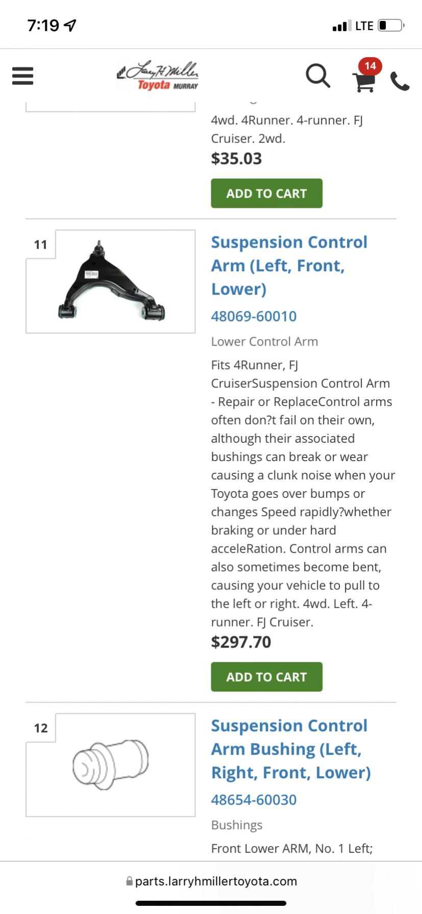

I’ve been looking at doing LCA’s on my 04 after looking at all the options of the rebuild and after market I think I’ll just go OEM at $300 a side it really isn’t that expensive of a repair considering they are roughly 18 years old.

Are you paying shipping on those? Cobb County Toyota here in metro Atlanta has them for $305 shipped (use code FREESHIP). Maybe that saves you a few bucks.
I’m pretty sure it’s free shipping to southern Utah since that’s the nearest dealer to me. But I’m in the middle of getting my stuff for my drivers manifold and rear main seal. I’ll find out then if it is free shipping or not. I just don’t like dealing with the southern Utah dealership I’ve had nothing but bad luck through them. Much better luck through the SLC dealer.
