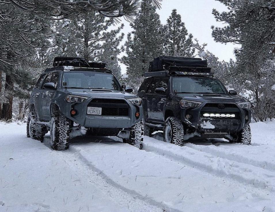

I thought about that also...why not just run your front without the valence?
I thought about it but didn't like all the holes. I wish the TRD OR wouldn't even come with those cheap plastic valances. In fact, since an SR5 is just as good as an OR, I should have got one one of those. LOL
I should have gotten the equally capable SR5...
