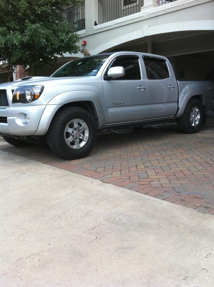

There are some companies like sitting sic, eibach, and DJM that might help you do a one off. Also look up Tundra Racing. My buddie just lowered his 4x4 crew cab taco and looks nice. This is with 2.5 drop in the front and 3.5 in the rear. Other than that you might have to go a custom route.
