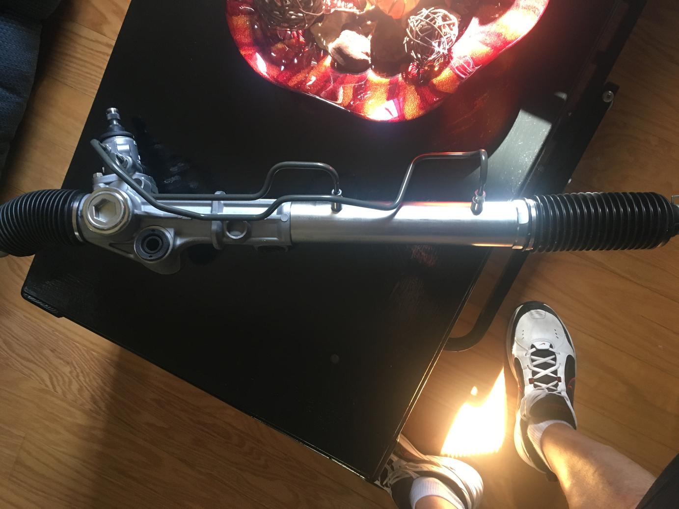

Oh yeah, $505 plus $30 shipping from Toyota of DesMoines, no tax
My OEM rack was $500ish. From mcgregortoyota. Let’s not forget. If you subtract the oem inner tie rods. The rack it self isn’t expensive. Your also paying for OEM inner tie rods ! I also went ahead and got new rag joint. And made sure to use anti-seize on it. When you install it. Make sure your rack is clocked properly. As in the steering wheel turns the same amount of times to the left and right.
