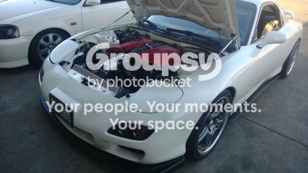

LS7 into our bosses FD3S.
WP_20131222_010_zpsbef5633c.jpg~original
Also, in for epicness.
^ College kids don't have those kind of funds for an LS7.......but one day. Nice car though. I love that hood shock setup. Is that an aftermarket thing cause I really want something similar on the Z.
