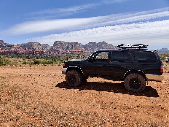

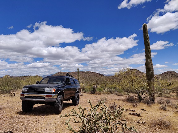

ViaPhoenix's 1997 4Runner SR5 4x4 w/ Factory E-locker
I bought this in Nov '18 because I wanted learned to wrench on vehicles and eventually have a rig to start exploring further offroad than my outback could take me. As well as, having a non-daily driver that I do not care about the AZ pin striping and any body damage that could come. I have lurked this forum a lot and followed Timmy&Sean's lead over at Toyota Time a lot. So much thanks to all of you that have unknownly helped me tackle all these projects and buy way more tools than I thought I'd ever need.
