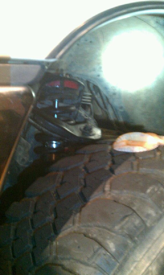

So I'm out here, in the rain...bottle jack is on but the uca is contacting the spring before I can get it drooped enough to bolt in.
Ok, the driver side is assembled. But its at a terrible angle. The ball joint will be toast in no time like this. I tightened the uca with the weight off the truck though, any chance thats what's wrong? Or is it just going to have a terrible ball joint angle?
Travis just sent me a pic via text.
I haven't lifted my truck yet but that looks really tall to me. What's wrong? the spacer making it too high?
This is one major problem with top out spacers (a spacer that is on top of the coil and outside of the top plate). They will allow the wheel to droop beyond the safe limits. This can cause over extension of the CVs and they can actually pull apart when drooping a wheel.

No, the other front corner is still on a jack stand so it has some.weight but not all. My setuo on the front is bilsteins on the highest setting with top out spacers that were already on the truck (unknown brand about 3/4 of an inch thick.
Bilstein's are at 2.5", top outs are lifting it 1.5", so you've got 4" of lift and the stock arms can only handle 3- 3.5" of lift before the ball joint starts to bind. I know you don't want to hear this, but you're going to have to remove the top out or replace it with smaller one.
