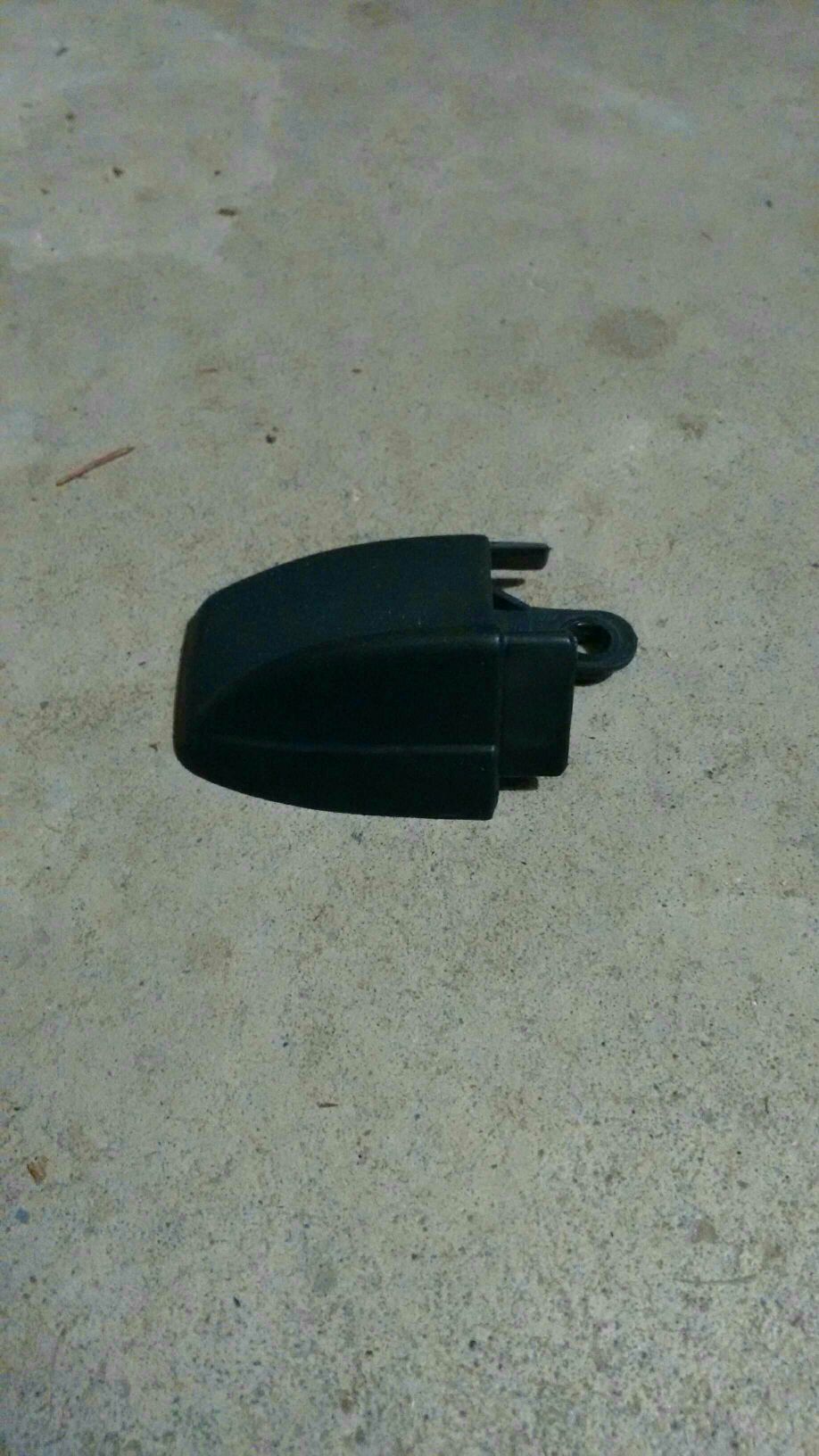

Anyone know where to buy one? I had the rack apart to repaint the rails and wasn't paying attention during the assembly:mad: I broke the tab on the end cap and need a new one. I siliconed rubbered the broken one back on but it needs replacing.

I have broken these end caps a few times. They're not really meant to be removed a lot, but I keep my cross bars off so I can fit in my garage and probably use the rack 3 or 4 times a year. I grind the tab off and space the screw slot up so that it doesn't have to flex anymore.

After you remove the torx screw, you have to sort of carefully wiggle them out. You can lift the tab with a screwdriver a tiny bit to help disengage it, but it's tricky. There's a good chance the plastic has become brittle over time so they might break no matter how careful you are.
This gives you an idea of how much they go into the rail.

My 2015 TE has black end caps with silver rails. There are 2 screws each on both ends of the rails on the bottom side of the rail right next to the end caps. Alldatadiy says you have to pry the caps off to get to the mounting screws which are under the caps. The caps are definitely not one piece - they are the base and then the "cap" folds over the top and appears to snap on.
I got them off tonight, and yes as I feared I cracked the first one getting it off.
After that one it became readily apparent how to do it and how NOT to do it.
Pictures tomorrow (on how to do it and how NOT to do it) and $51 down the tubes. :-)
