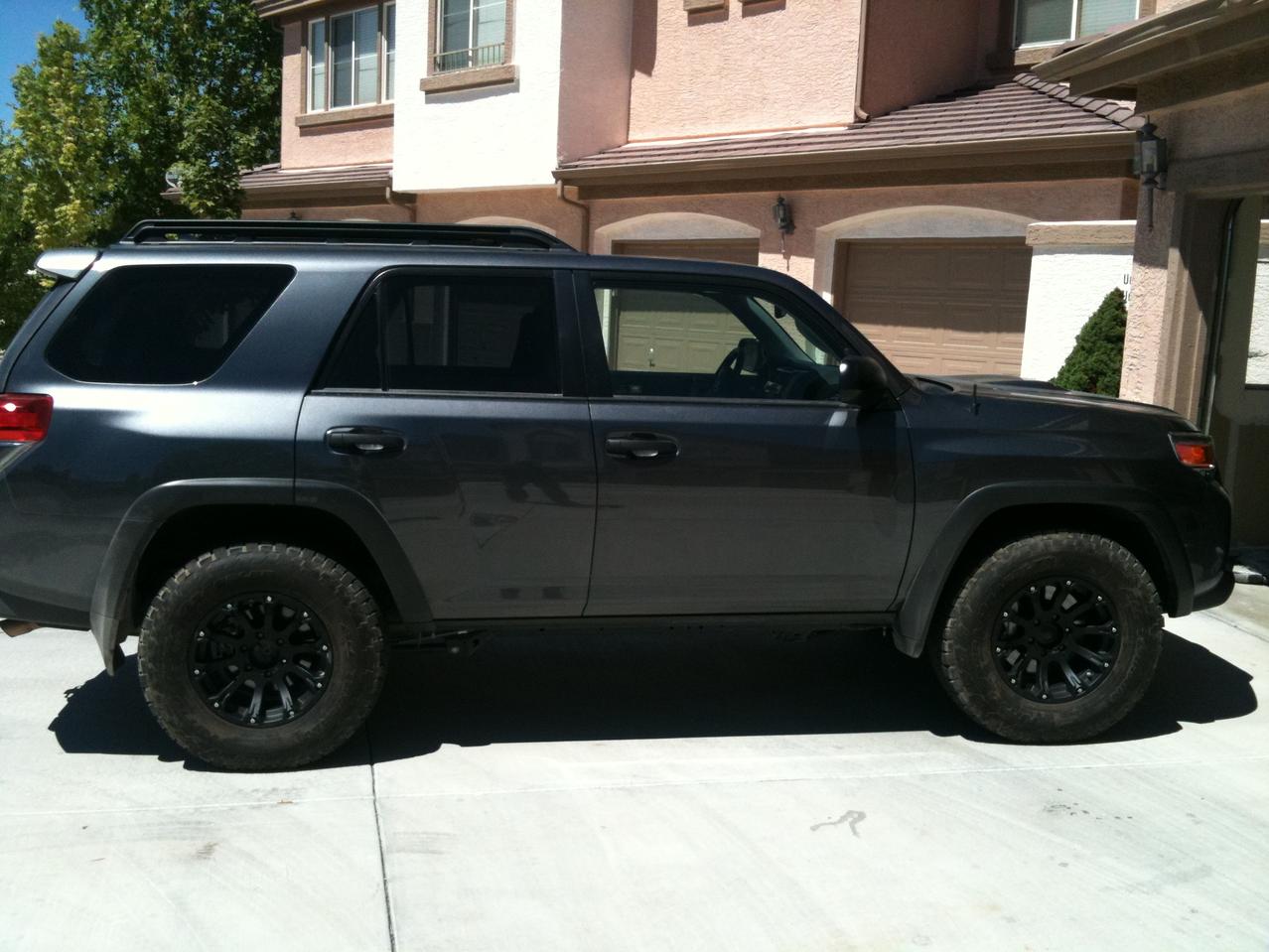

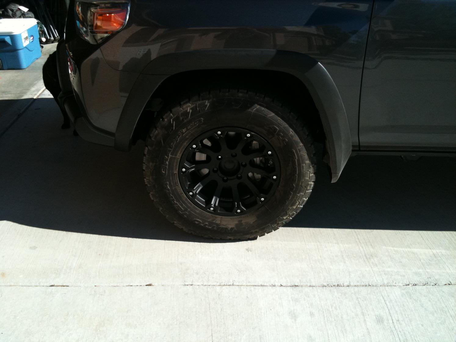

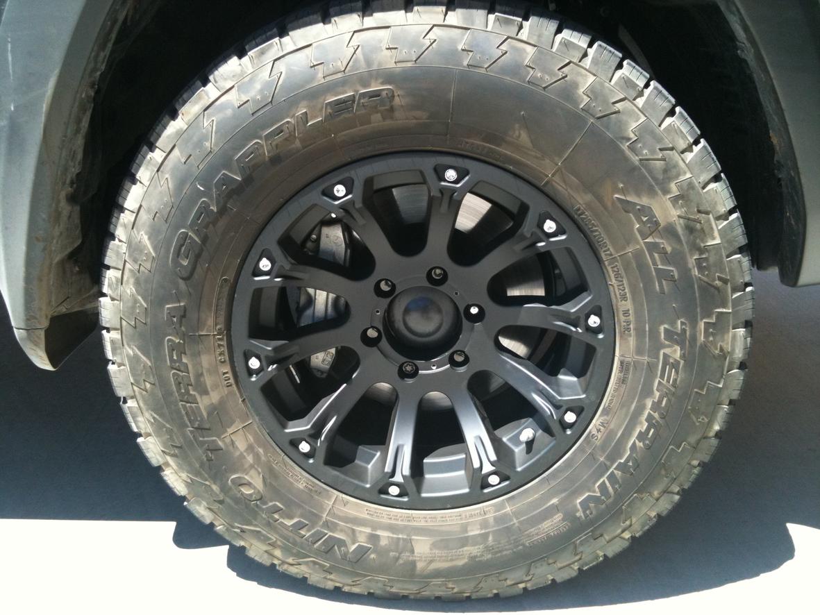

one of the members is running 285 70 17s on stock suspension and these black rhino wheels. says very little rubbing. I was thinking a leveling kit would do the trick.
check out the pics. very good looking.
