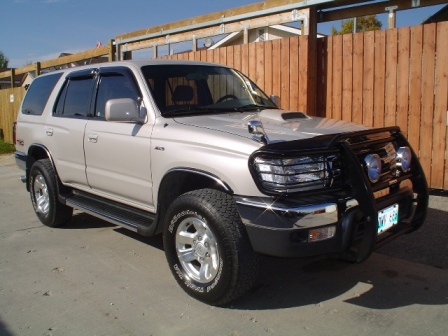

I have paper filter on mine,when i got it diagnosed, the toyota tech said it was the maf, i tried cleaning the maf with an electrical cleaner twice,the cel would come off(after resetting the com) but would come on after a few mins of driving then off, im thinking the maf is working interminently or something else is broken and not the maf since it looks fine when i cleaned it and my t4r is well taken cared off and no offroad driving with it. here are some pics.

u forgot to put the pix??
Sorry. Here it is. The check engine light just came off and didnt come on since the third time i cleaned the maf sensor. LUCKY ME..
