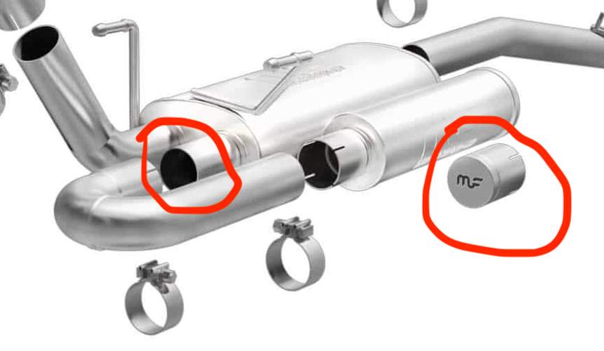

I'm looking at their exhaust picture, but I don't understand what the loop back part after the muffler is for. Can anyone help me out?
I'd guess a resonator set up. Sure looks strange though and I'm not sure I'd want the exhaust gasses dumping under the corner of the truck.
I was thinking that, but it seemed strange to me too for the resonator to dump exhaust separate from the exhaust exit at the rear. I thought resonators were still inline of all the exhaust flow to function properly as well
It's a resonator, there's no outlet at the other end of it. I've seen both OEM and aftermarket exhausts use "J tube" type resonators.
According to the instructions you can bypass the resonator by inserting the cap at the muffler outlet if you want more noise.

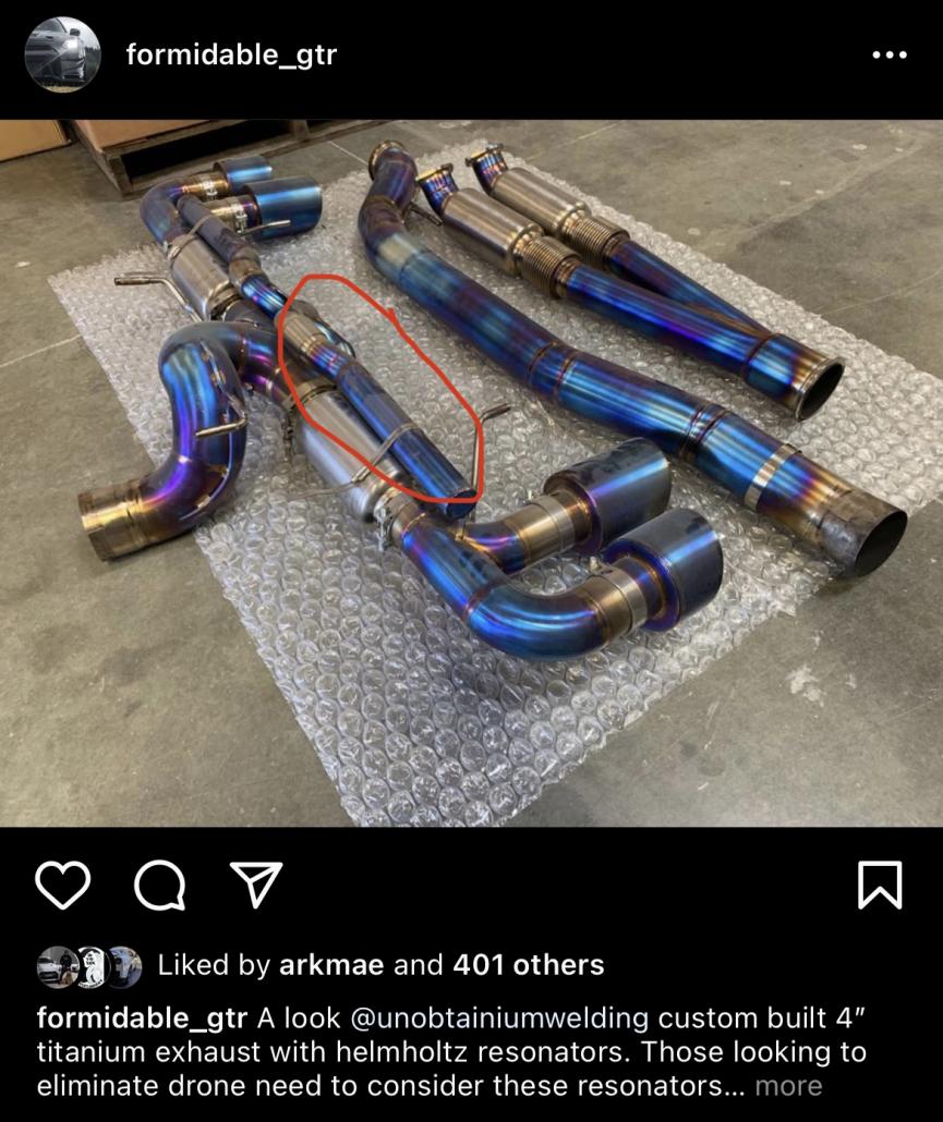

It’s called a helmholtz resonator. Essentially the sound frequency can be “tuned” to eliminate drone by increasing or decreasing the length of the resonator /end pipe to bounce a specific wavelength back to the front of the vehicle essentially cancelling out the same frequency.
I have these resonators custom made on my GTR. Mine have been tuned to reduce drone at 2500 rpm... which works great at 65-70 mph highway cruising.
You learn something new every day. Thanks guys! Such a strange design but you can't argue with results. I wonder how rust/corrosion resistant these will be
