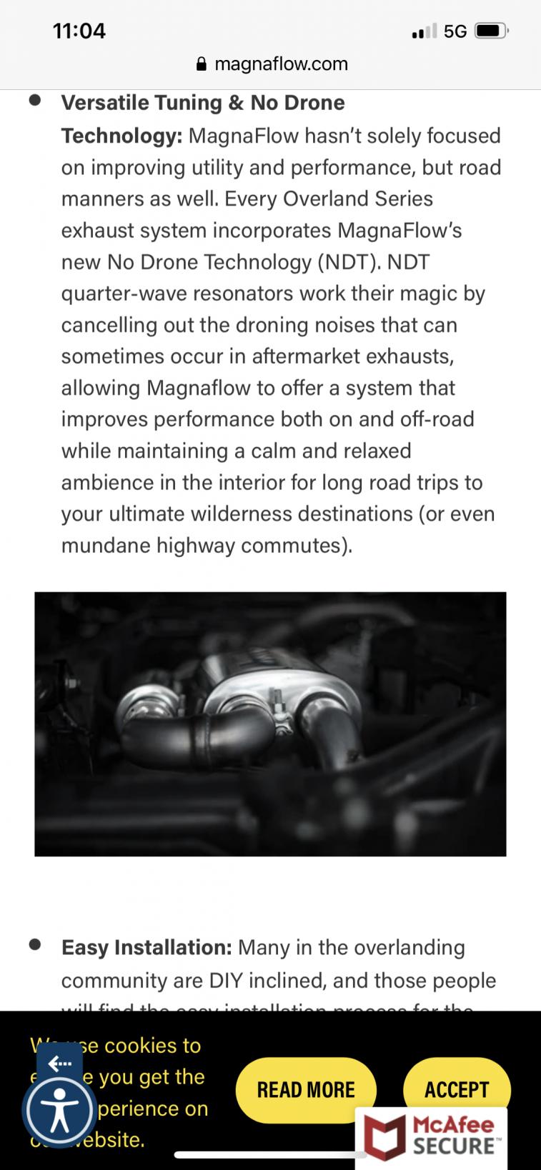

Tech Talk: Overland Series Exhaust Systems
Heres a quote from them-
Versatile Tuning & No Drone Technology:MagnaFlow hasn't solely focused on improving utility and performance, but road manners as well. Every Overland Series exhaust system incorporates MagnaFlow’s new No Drone Technology (NDT). NDT quarter-wave resonators work their magic by cancelling out the droning noises that can sometimes occur in aftermarket exhausts, allowing Magnaflow to offer a system that improves performance both on and off-road while maintaining a calm and relaxed ambience in the interior for long road trips to your ultimate wilderness destinations (or even mundane highway commutes).

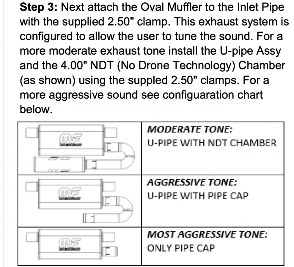

699 Bucks MSRP...thats an awesome price for a Maggy system!!!
Also its a V6, short of a narrow angle DI injected engine...they will really never sound "good" with an aftermarket exhaust system AND NOT drone at some point lol.
Interesting design. I like that you can modify the sound with Helmholtz resonator. I also like the minimalist look with no tip.

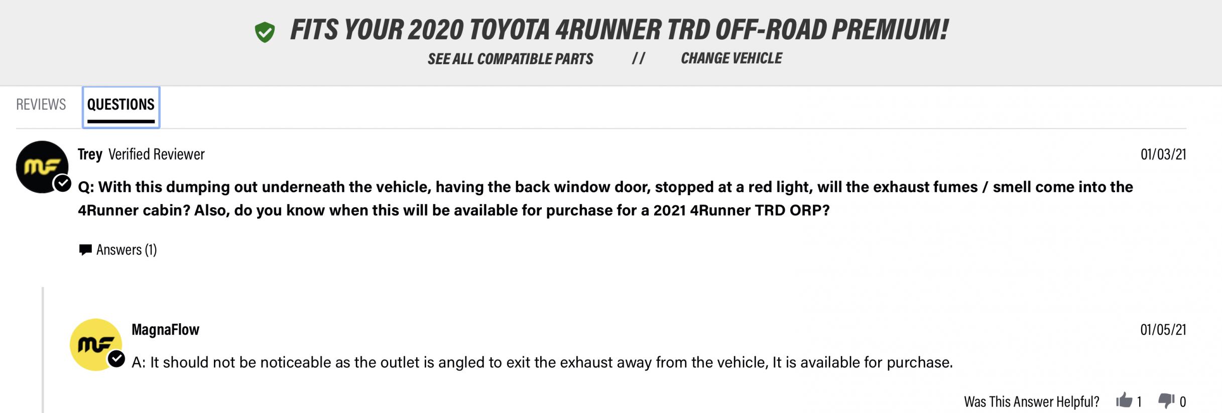

this thing is just begging for fumes to rise into the cabin.. pass
This was also my first thought about it being so short and tucked. It looks like a nice exhaust otherwise. I do think fumes would be a concern with this?
That was addressed in one of the press releases, they say not to worry its routed up and out to the side
Opps, no it was in a Q&A section, found it
