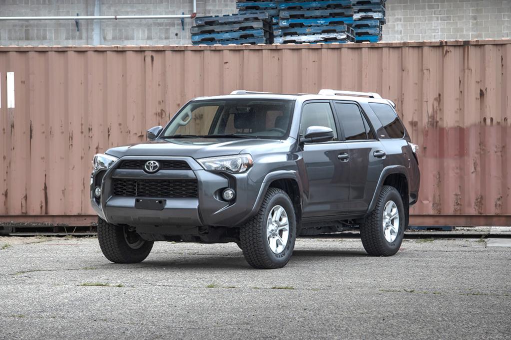

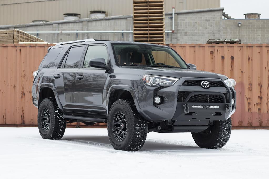

Just got the lift/wheels/tires installed a couple weeks ago! Here's the current before and after.
Falken Wildpeak AT 3 | Mamba Offroad Wheels M23 | 3" BDS Suspension | Victory 4x4 Blitz Front Winch Bumper | Victory 4x4 Strike Sliders

Looks great and simple! I like the look of this a lot.
unique style you've put together with a lot of functionality. a set of Matte Grey SCS Ray10s book-ending those sliders would look so good, just saying
yea Ive been playing around with the idea of bronze or a dark silver wheels, but think I should continue to buy the stuff I actually need first lol

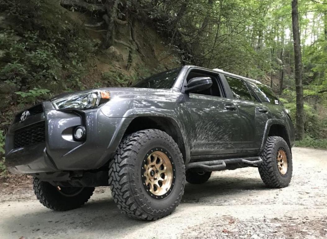

Anyone running bronze wheels with MGM? I’m thinking about ditching my SCS Ray 10s in black for 17x9 F5s matte dark bronze with the -38mm offset to fill out the fenders and improve the stance.
Black F5's look so good. I've not been able to get on board with other colors like bronze, gold, or copper. I do like the gray and silver Ray10's.
And this would be false...those gold Ray 10s are bad ass! Do it!!!
Nope, still gaudy. If you're into bling bling rap... be my guest. Just make sure you have adequate space for your pimp cane. Also, can you get the gold wheels with spinners? That would be dope as hell.
You’re blind....

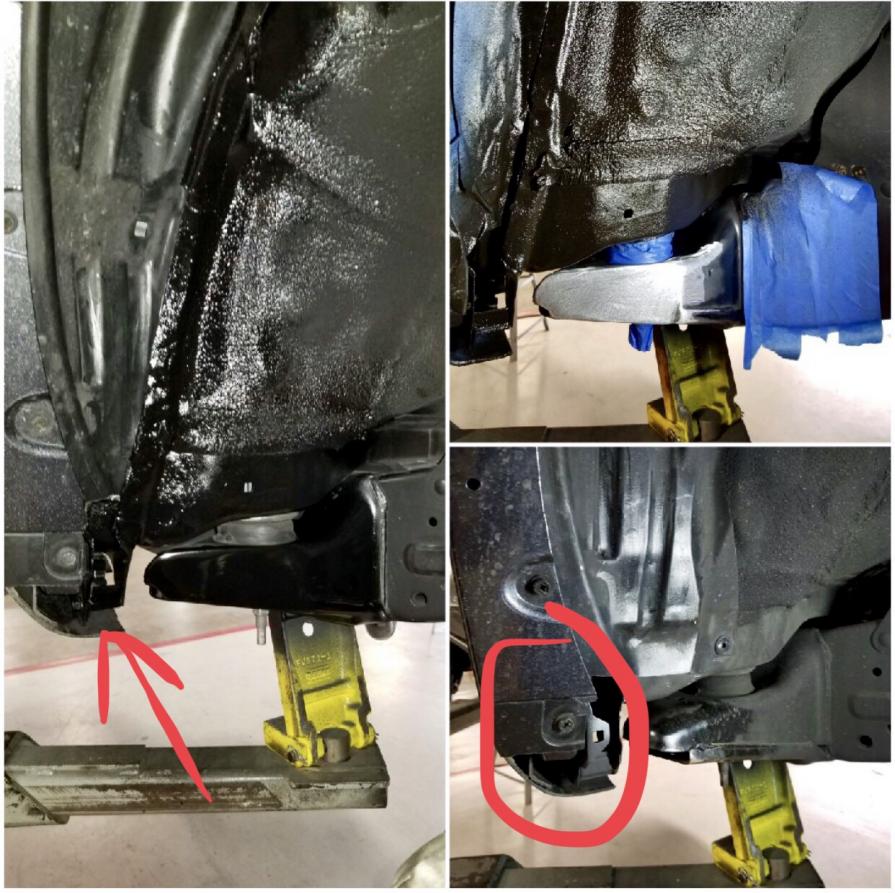

Do EEEEIIIIIT!!! but keep in mind though, if u plan on going to 295s or 305s, you will probably have to do something about the pinch weld hidden under the fender cap that is near the body mount if you haven't addressed it yet. If you stick to 285's, you should be okay.
Way ahead of you brother :sad:

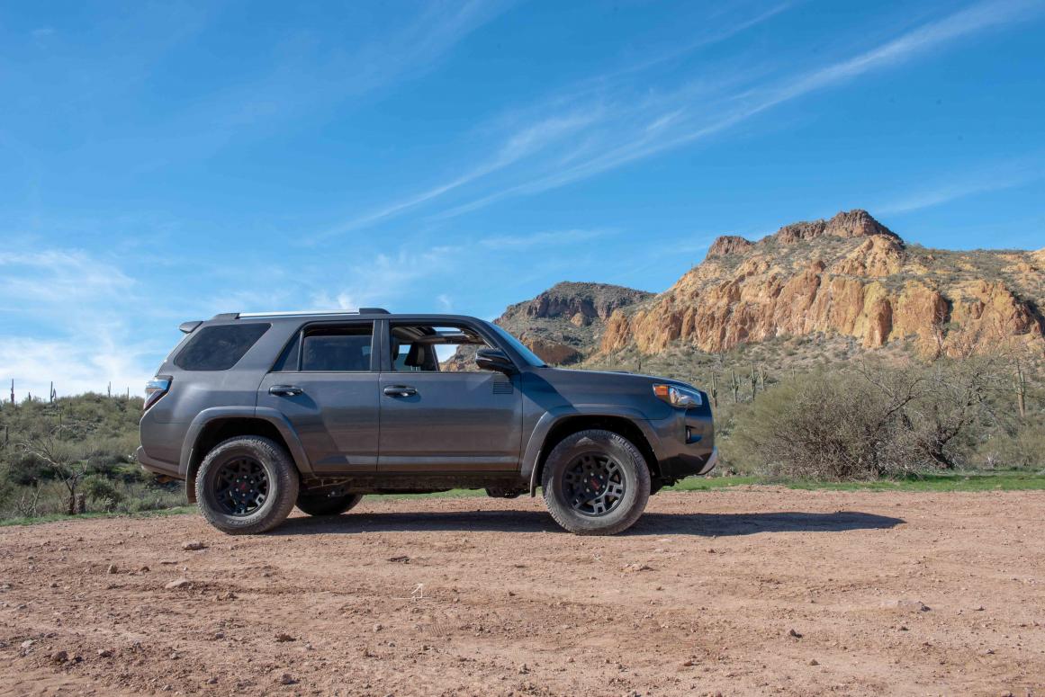

Nearly all stock and did great out on rocky trails. Definitely wanting on board air and a lift. I miss the clearance and mods I had on my 3rd Gen. Eventually she'll get there.

the picture on the left (the tall one).
Did you removed the entire liner?
Relief cut and flatten the inside seem?
Is that just black paint then to cover it up?
Didn’t remove it, just painted over to seal it up. I trimmed off the pinch welds and trimmed off the plastic cap.
appreciate the feedback.
So really the only thing you trimmed was the pinch welds in the red circle bottom right picture (that are behind the valance cap) - is that correct?
