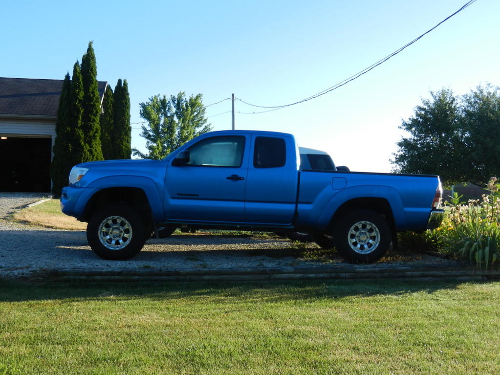

At the 2nd notch (.85) you should still see some rake. I have a V8 and originally went with the 3rd notch (1.75) and it came out with 1/2" of rake in the back. I then moved it to the top notch (2.25) and added Toytec Superflex rear lift coils. I LOVE the stance now. All that being said, if you go to the 3rd or top notch, you probably will want a spacer or lift coil in there to add the rake. Or if you like the BRO lift, to each there own :banana:

No Bro lifts please just want a Nice level look. At .85 the rake should be way less than stock. Love the V8. Sweet lookin Taco. Not.
