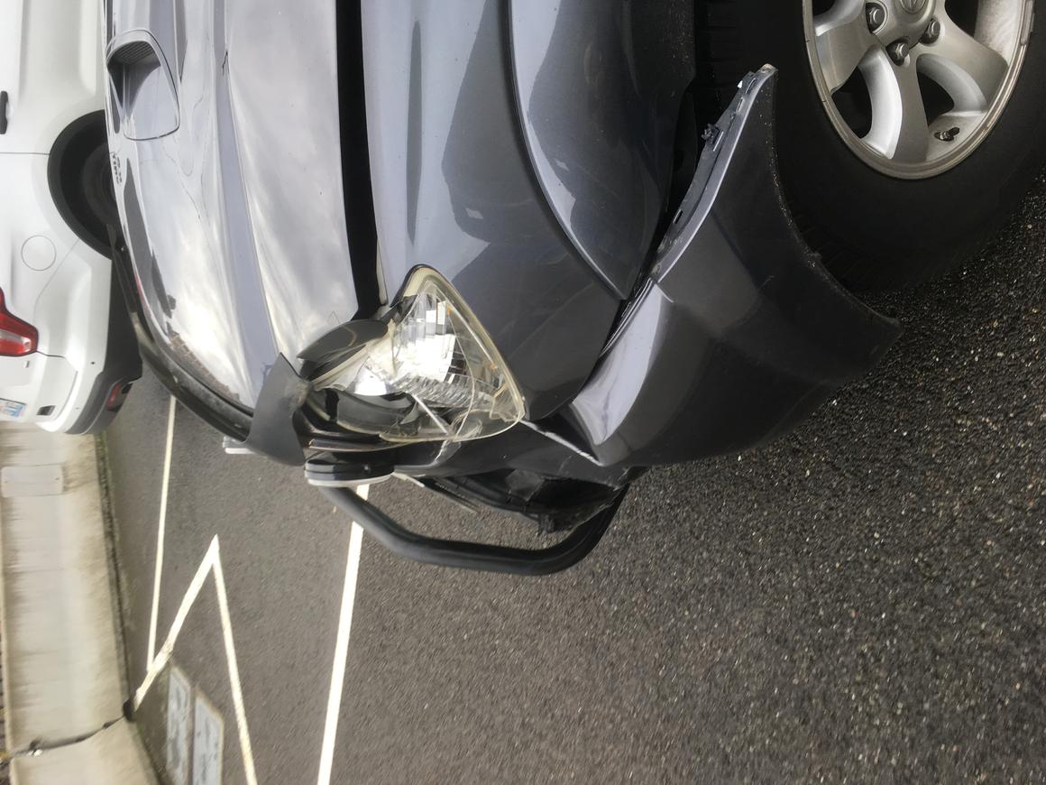

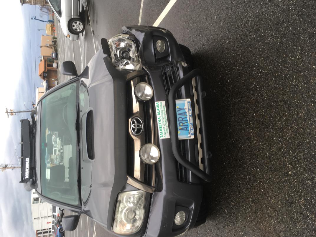

So now I'll have to check alignment. Don't think that the radiator was damaged new bumper lights install check left front tire may replace (brand new Michelin Defender) lights alignment help me think? Steering ?
This came a complete surprise.

im not that familiar with the 4runners but i know my tacoma had bumper brackets and frame mounts under there that would bend really easy, so easy that it must be on purpose to cushion the impact but it can really throw things out of whack with even a soft tap at 10mph, so you might have a permanent crooked bumper unless these brackets and mounts were straightened or replaced first.
crawl under there and compare left side to right side and take a few measurements,
