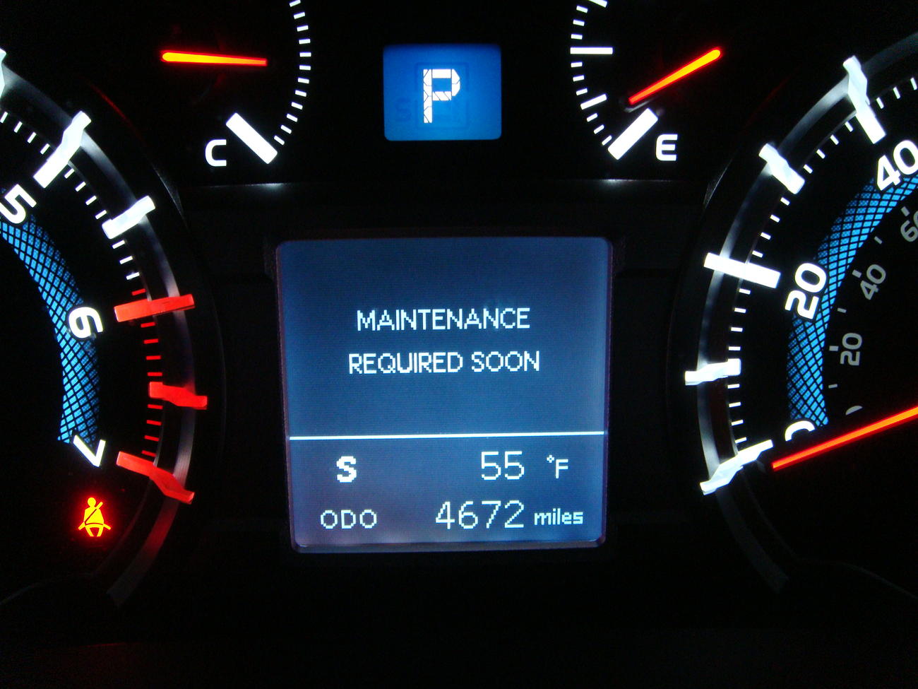

hey fellas i thought our oil change was at 10k. my maintenance light come on today at 46xx miles. or is there another maintenance at 5k?

It's only a basic timer , it starts every 4500 miles flashing then it'll be on constant at 5000 miles just reset it yourself, it means nothing. It's just a reminder

just looked up in the owners manual, it's basically the same way as resetting the oil procedure. can you chime in on that.
Yes same procedure, I do mine with my service as I do all my own maintenance. It's good to know how to do sometimes the dealers forget to reset after a service .Push down the reset button turn the key wait .... Super easy.
got it, thanks for chiming in. i will reset it tomorrow. so basically this light comes on every 5k and you just do the required maintenance and reset the light. it's a little different than my tacoma.
I have always found the message "maintenance required" a little funny. People seem to equate "maintaining" the vehicle with "omg fml something is terribly wrong". An oil change light would probably make better sense - given that the new 14+ have a frigging screen it should literally tell you what to do, not give some bs cryptic message that anyone who didn't read the manual will not understand. Every 5 k, rotate your tires - they will last a lot longer, and then reset the light. At 10 k have the oil changed and reset the light.

So just to clarify then, the "Maintenance Required" light does in fact serve as a reminder for the periodic oil change, right?
Mine also lights up every 5k miles. But, as I understand it, the suggested oil change frequency for synthetic oil is 10k miles for our 4runner, right?
that seems to be correct.

Yes - it will show up every 5K miles. I don't know if it is still a standard thing, but when I bought mine, I got free maintenance for 25K miles. I also got a small booklet (despite never actually getting an owner's manual - different story :mad2: ) highlighting what needs to be done. They do all of that for free. I don't have it with me right now, so I can't 100% confirm, but the short version is this:
Tire rotations every 5K miles (so I will get 4 of those)
Oil change every 10K (2 of those)
Air filter (under the hood and in-cabin) somewhere around 15 or 20K, I believe
I think that pretty much covers it.
From what I understood every 5000 miles is considered a maintenance period. The message is first maintenance required soon and then it becomes maintenance required.
