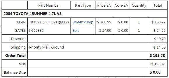

The timing belt kit I installed this last weekend on my Runner was from Rockauto and included pretty much everything you need. Timing belt, water pump, pulleys, tensioner, and gaskets. I bought the serp belt from them too, see order below. I bought from the dealer the thermostat, thermostat gasket ($5...what a rip), and 2 gallons of coolant. You will need rtv for the water pump/ thermostat connection.
Some people say the pulleys and tensioner will last 200k. Okay... what if they don't? You saved 10 bucks now to take the engine apart again when/if they go bad before the next belt.
