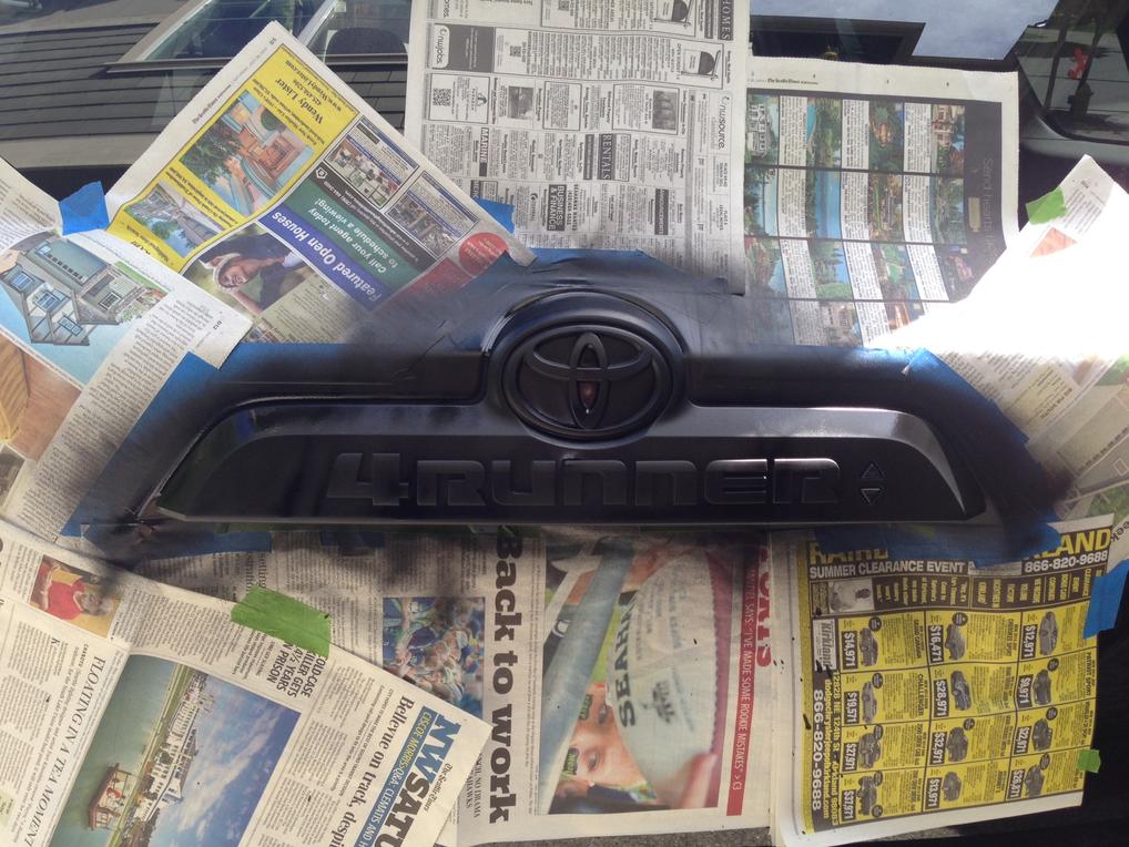

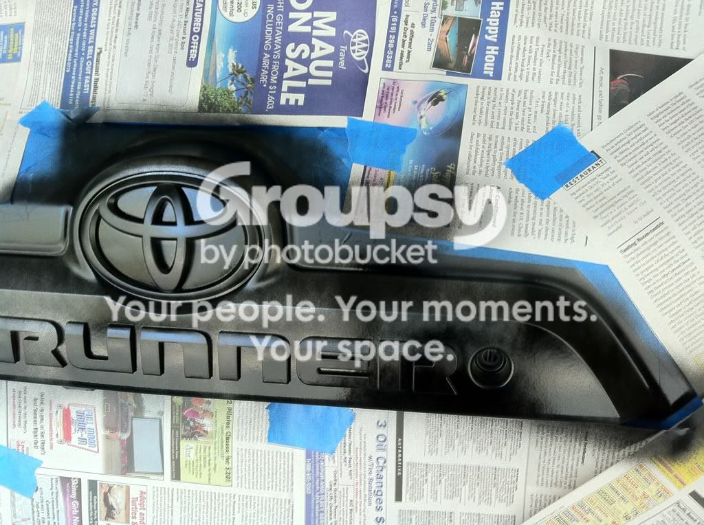

So after blacking out the chrome lace along the bottom and the door handles... I decided to give the rear emblem a shot. I think it turned out looking great and it's so easy to do...

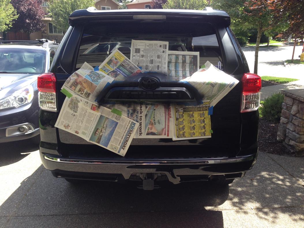

Tape around the area with newspaper. Spray 5 coats waiting about 10min between coats (Don't worry about taping perfect lines since its ok to get it on your paint since you will just peel off any excess later):
2adb3fc9.jpg~original
Remove the tape and newspaper 10min after the final coat. The excess plastidip on your paint will start to come right off along with the tape. Any additional plasti dip can be peeled away very easily without taking off the plastidip from other pieces since there is a gap between them.
5f73c285.jpg~original

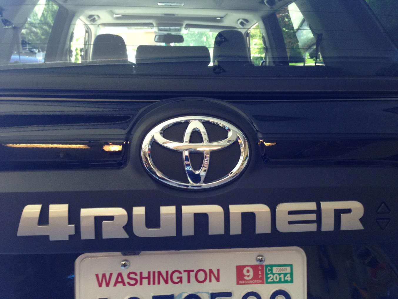

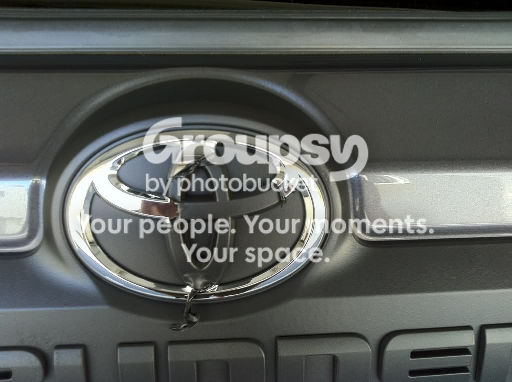

Using a toothpick to not damage the painted chrome, pick away at the emblem to create enough of a hole for you to grab and peel away the plasti dip:
b289e9d3.jpg~original
Here is a picture after removing the plasti dip from the toyota emblem:
56f356db.jpg~original

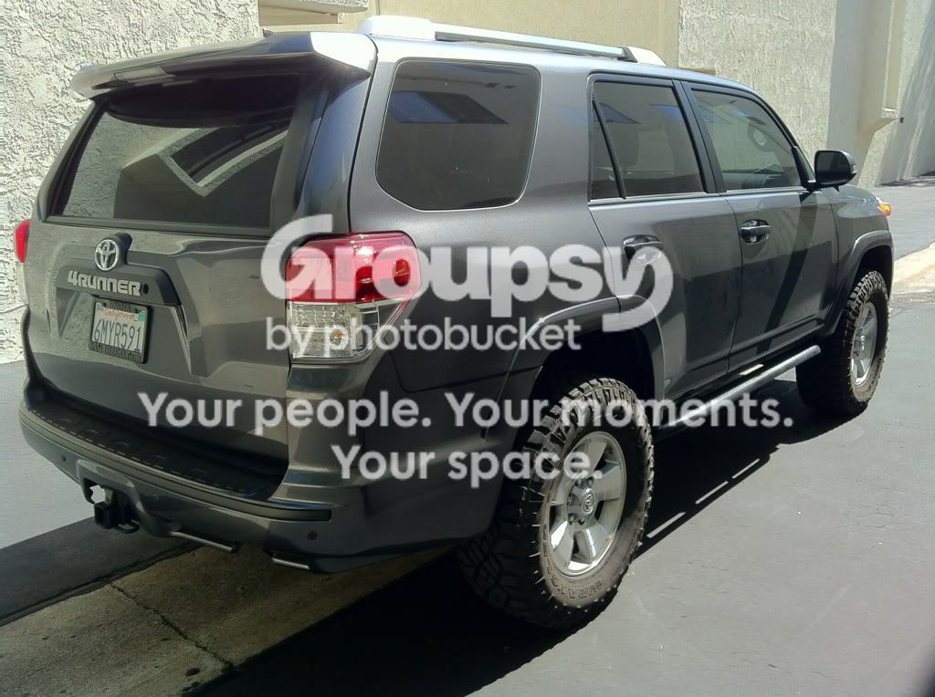

And here is a finished look after removing the plasti dip from the 4Runner logo:
9cd26cc7.jpg~original
I like that better than the TEs rear valance, as the "4Runner" lettering on the SR5 and LE is not bright chrome but has a metted finish. I may have to do this to mine.
That looks great! I am glad to see that it can be done without removing the garnish from the vehicle.

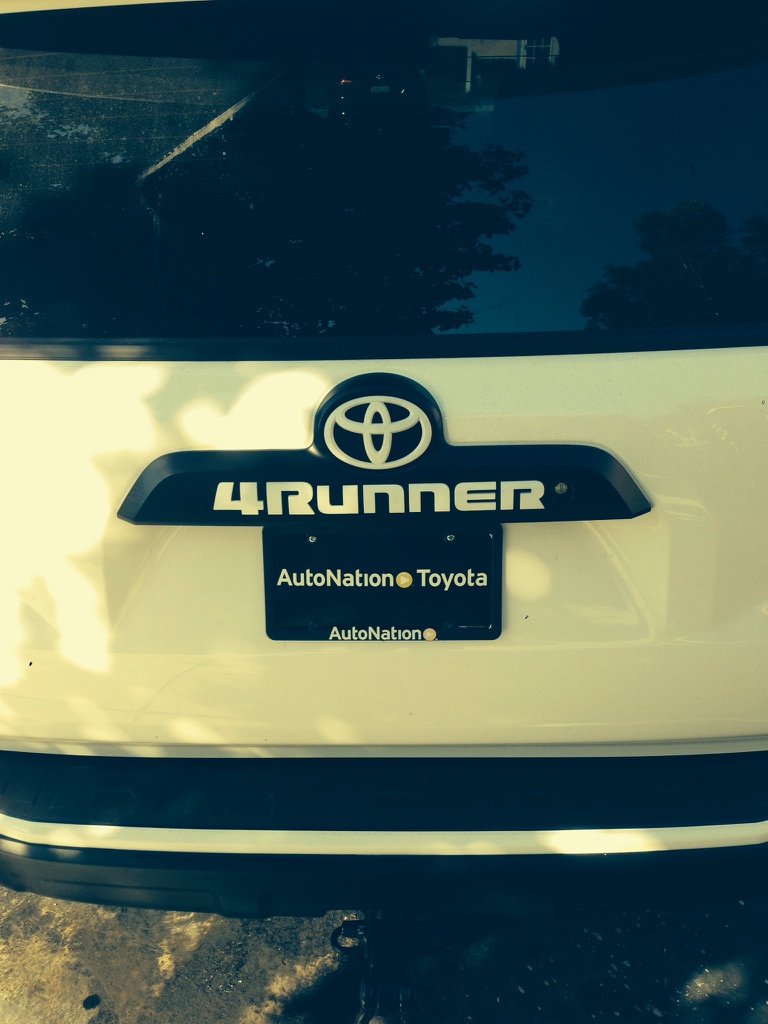

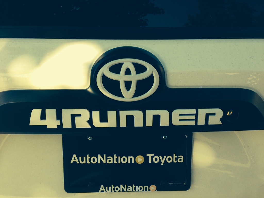

I grabbed a can of white plastidip and am going to turn both front and rear chrome logo's white. I'll post pics when I'm done
