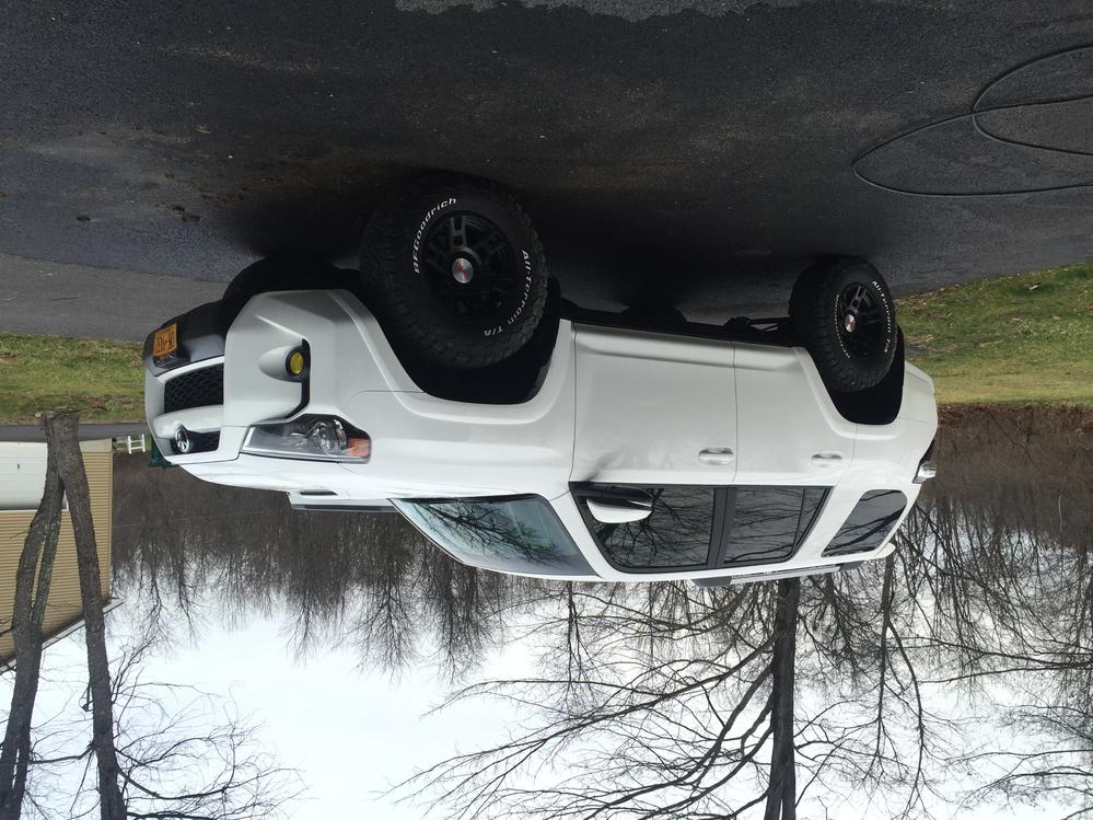

Well long story short. Loving the new 4Runner since I sold my 1997 3rd gen. Got 1300 miles on her and finally got to doing suspension today. Wheels installed. Tomorrow is alignment. Now just waiting to get windows tinted, lamin X for fog lights and black my front and rear bumper valances.
Bilstein 5100's 1.75" front (3rd clip from bottom)
Pair of OME 10mm spacers top of rear stock coils (20mm each)
BFGoodrich AT KO2 275/65-17 E load tires
FN F(x) Wheels matte black
Removed factory side steps
First off I'm beyond happy how the truck drives and handles now. Along with obvious looks. Sits perfect to me.
Last, a HUGE thank you to Dustin at FN wheels. Hands on easy to deal with professional guy with no run around. Wheels are quality and came with lug nuts locking tool and center caps. Excellent pricing, and even my very reputable tire shop who I do a lot of wheels with over the years said they were damn nice quality over how many aftermarket wheels they deal with daily. Were actually round and balanced awesome even with the heavy BF's. Now enough of this. Pics.

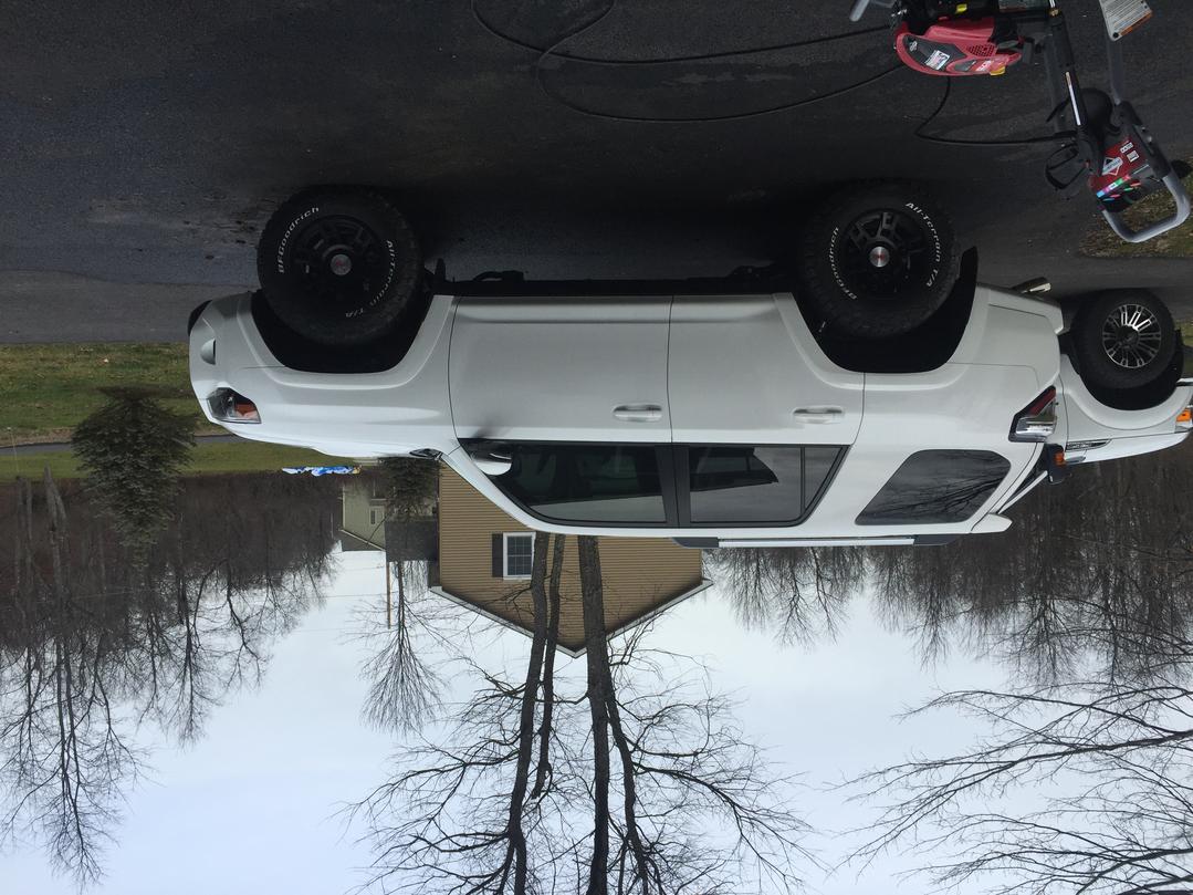

Stock next to our Tacoma (5100's .85 front stock rear TRD wheels 265's)
