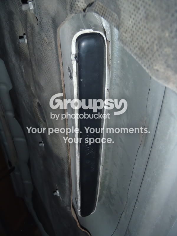

In this picture, you can see how it was made functional. Basically the back of the hood scoop insert was cut off with a dremel. You can also see in this pic how I blocked it off. That black piece can be easily removed if I want to run with it open.

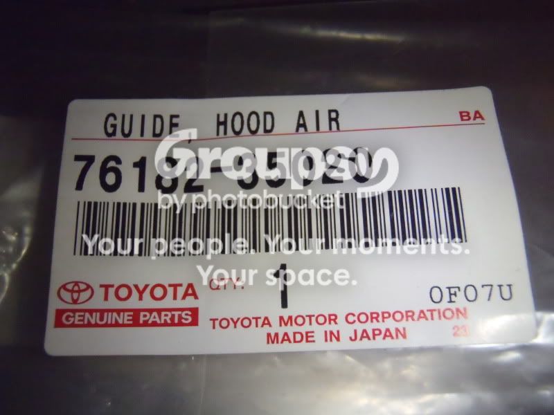

This is the part # for the black peice. There should already be one of these inside your hood scoop (assuming it's factory). If you cut the back of the insert off, you'll end up cutting the back of this peice off too, but it's cheap if you want to have an extra for blocking it back off when you need to.

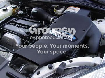

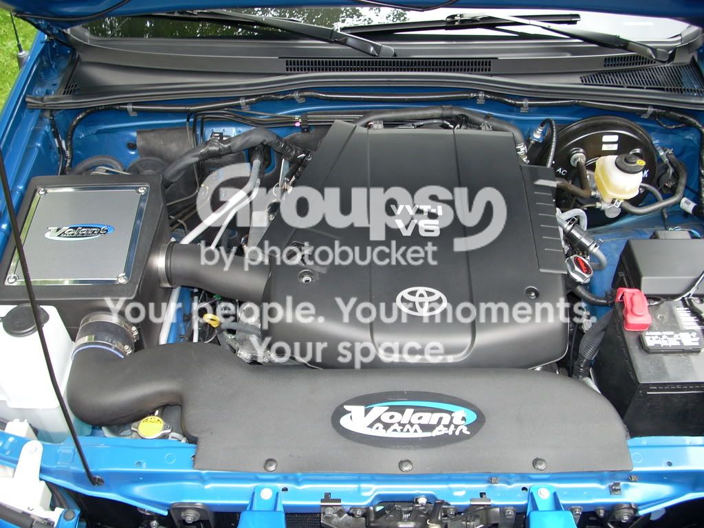

if you can find some way to make this thing work with the 3rd gen you can have a ram air effect. i think its too big for the scoop but someone with some "smarts" might get it to work. this one is for the newer tacomas
38640_lg.jpg~original
This is awesome just what I was looking for I can deff fab this at my brother shop. Do you know.the website where I can find that ?
just go to Volants website and search for "ram air kit." its I'm not to familiar with how it will work with our trucks but depending on the modifications i think it can still be possible.
If you do make it possible i guarantee some of "Scoopers" will be sending you some $$ for what you fabbed up

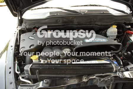

here are some pics i found of your different options
the tacoma one
33172300013_large.jpg~original
not sure what truck or car these are for but they have all kinds of options
volant_ram_39420_cinstall.jpg~original
36057.jpg~original
