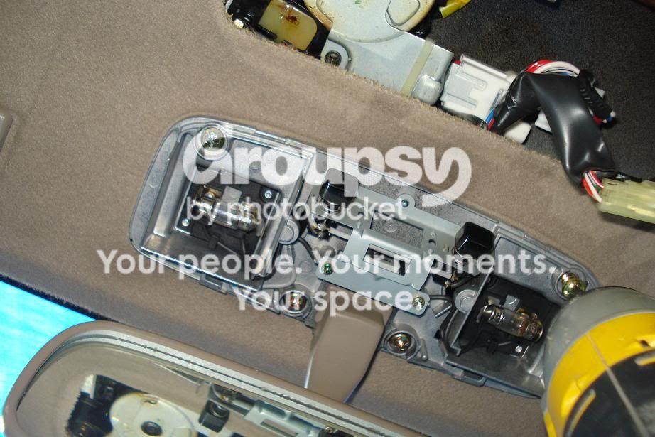

I can't believe I need to ask someone how to pull off the cover of the maplight assembly (the one attached to the rear view mirror). Thanks.:wow:
Find yourself a flat screwdriver and just start prying off the cover and it will pop out..bulbs are the fuse type ones- 12v 5w.
yup you got it..from the base of the cover where it meets the headliner..pry off from several locations though...
30.jpg~original
there should be little slots in the front of the light cover where you can out the flat head screwdriver in. The bulbs are BA9 i believe
EDIT: Oh never mind yours i different... sorry
