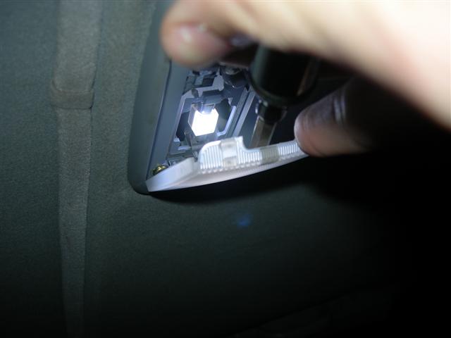

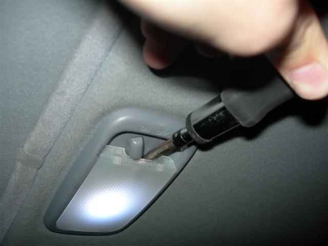

B broncosi New member Dec 7, 2006 #5 i got you step 1: Attachments dscn2929 (small).jpg 32.2 KB · Views: 1,620

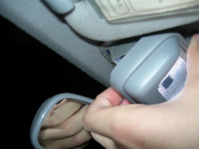

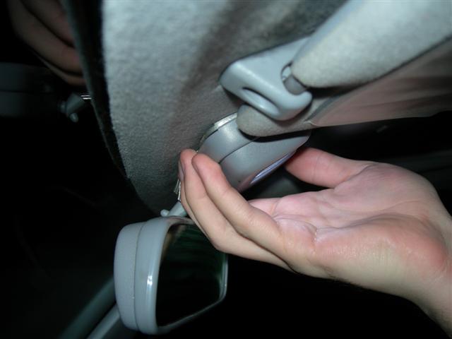

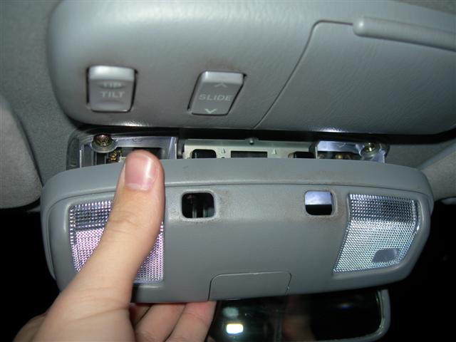

B broncosi New member Dec 7, 2006 #7 and for the map lights: step 1: Attachments dscn2932 (small).jpg 29 KB · Views: 1,687

B broncosi New member Dec 7, 2006 #12 haha yea cant say that i havent tried that with some other parts of my t4r. But yea just grab the back and pull down then when it comes loose pull the assembly straight towards you to get it off of the 2 black push buttons on the front.
