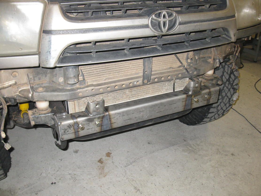

I attached a pic of our new crossmember. It simply slides over the frame rails. Level the bumper on the fenders and across the grill and weld it on. Most muffler shops can do this for a very decent price.
So is yours a steel plate that you weld in? Why asking is because the front x member is 2x3 box!
Its .250 wall C-channel with gussets in the C-channel for support. Then we provide .250 wall out plates. This covers the crumple zone in the frame as well.
Its designed to slider over the outer frame rails and weld in place as shown above. It will require some trimming of the original bumper mounts on the end of the frame that can be done with an angle grinder. Its no more grinding than mounting any other aftermarket bumper.
