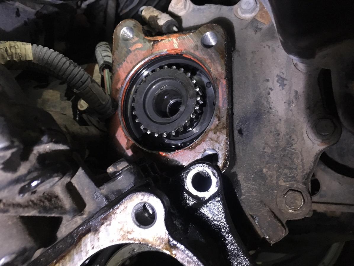

Hi [MENTION=1795]sschaefer3[/MENTION], I just switched my 1st gen Tacoma to manual hubs and I wanted to use a manual hub jack shaft that I have. But when I pulled off the ADD jack shaft, my front diff had this gear sticking out which is what the sliding collar in the ADD locks onto, so I couldn't slide in the manual hub jack shaft. For now I have a hose clamp locking the ADD shift fork in 4WD. I'm wondering how you got the manual jack shaft to fit. I may have missed something obvious, it was 2AM and I was getting delirious at that point.
That gear thing comes out, you pop it out, it is like the inner end of a CV axle. Then the long single shaft of the manual hub jack shaft goes into the hole the little gear left.
I can't thank you enough for the information! So I was getting tired and delirious. I'm going to try popping it out with two heel bars.
