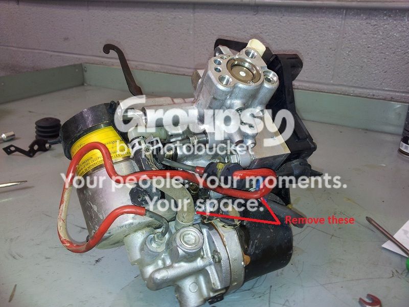

Where did you get the O-Rings/Rebuild kit for the 4th Gen 4Runner's Hydraulically Assisted Master Cylinder Unit? I've got my old one that failed due to an o-ring so if can get replacements its a good used unit I'd like to keep around.
Well, the short answer is, I have not rebuilt my T4R brake master cylinder. While I have rebuilt a few for other vehicles in the past, my Runner's MC is good. However, in answer to your question, I went on an online hunt for a rebuild kit. Couldn't find one. I suppose that's because you can purchase a remanufactured MC for $23.00 at Advanced Auto.

I absolutely doubt that, I haven't found a single credible aftermarket supplier for the 4th Gen's system. I checked Advanced Auto's website and while they list a master cylinder, I have a feeling its not the correct part.
I could be wrong, but I don't think I've seen any aftermarket support for the Toyota system on the 4th & 5th gens yet.

http://www.toyota-4runner.org/4th-gen-t4rs/120125-hydraboost-brake-assembly.html
Not to mention I don't know if any auto parts store wants the liability of selling just the master cylinder section as that still requires owners/end users to tear apart something Toyota does not consider "Serviceable."
