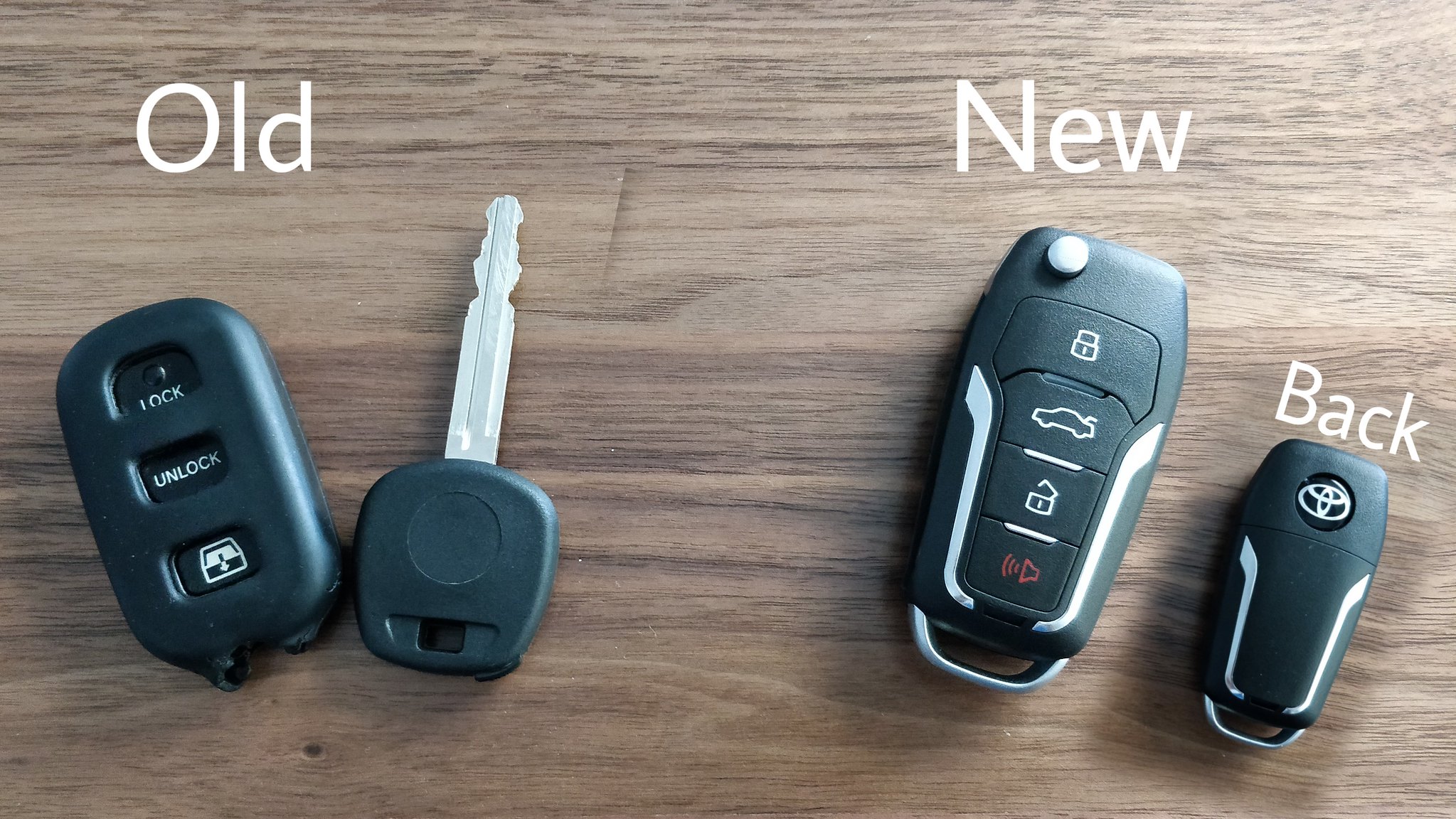

Hey Forum, so I have a problem. Turns out the only key I have for my 05 4runner is a gray valet key. Realized this after 2 years of ownership.
I called dealer to ask how much it costs to make a new master key and they are around $200. Can anyone else do this? Any suggestions???
I really don't mind using the valet key as I have been but recently I purchased an all in one switchblade style key and when I tried the self programming to allow the key to start the vehicle, that's when I realized it can't be done since I don't have a master key.
Thank you
Ok so I found a locksmith who did it for $50. Amazing.
I now have a master and he programed my new all in one while he was at it. Sweet.

I bought the same fob/blank key as the guy above. Gotta get the key on ebay, then find a locksmith to cut it off a current working key.

I just called a local locksmith. He provided an Ilco brand key which was much better than what I found at Amazon. I ordered the fob from a different seller. It works and I was able to program that myself, given the instructions. It is much lower quality, but it does work.
