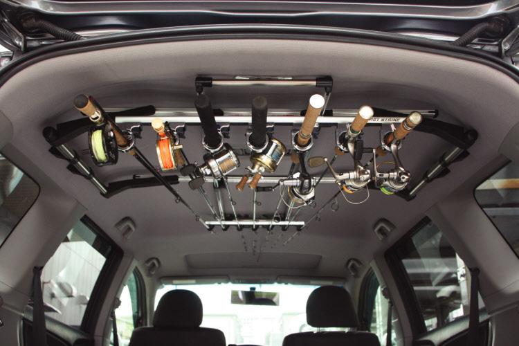

Hey man, I'm at ODU on campus right this minute. If I were to get something to hold my fishing gear, it'd be inside the truck.
I like this idea:
I really like that idea, I haven't seen or heard on anything like that. Don't really need anything for fishing until next summer so I'll have some time to look into that option. I've read through your build and have been looking around for your rig. I'm in an off campus apartment right off Hampton BLVD in Larchmont so I get to have my vehicle and work on it.
