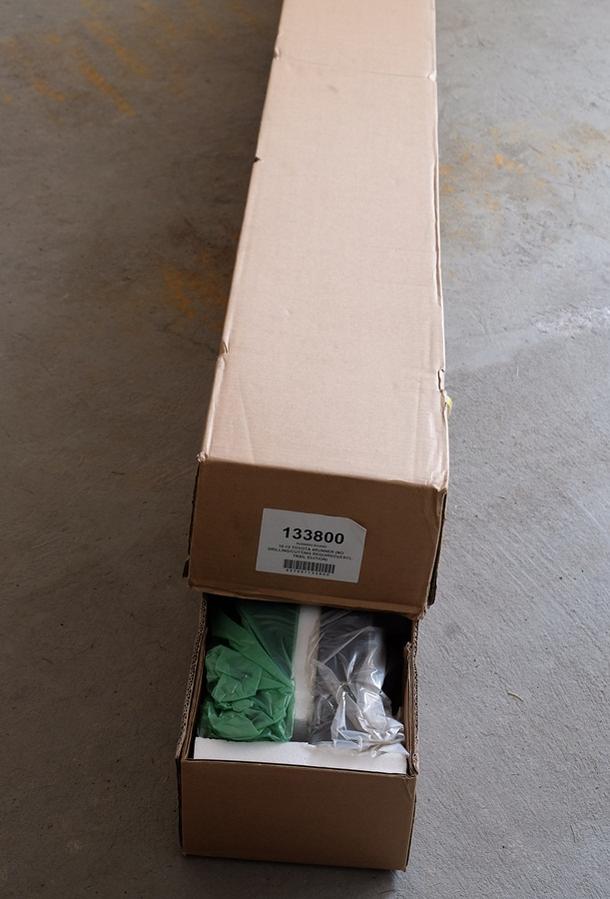

To begin, here is the box. Note the awesomeness of the factory packaging.

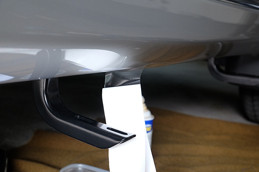

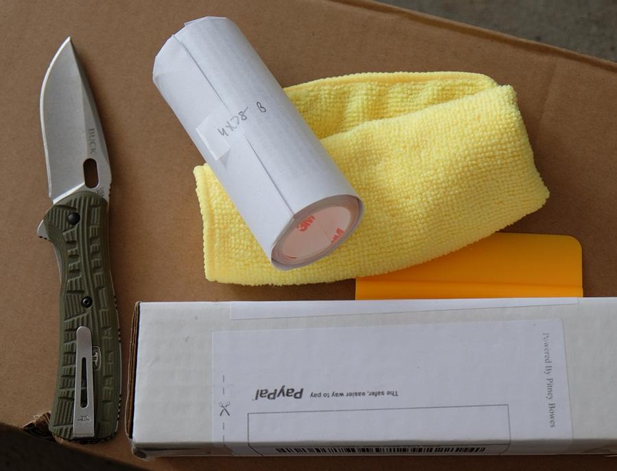

The Ionic running board design includes a rubber skirt that closes the gap between the rocker panel and the top of the running board. I bought a 4" x 78" roll of 3M Paint Protection film on ebay, about $22 shipped. Cut that into (2) 2" wide stripes and apply it to carefully cleaned rocker panels so the running board skirt doesn't wear paint. (Admittedly, this is overkill. Where the running board skirt touches the rocker is well out of sight.)
Here's the 3M film

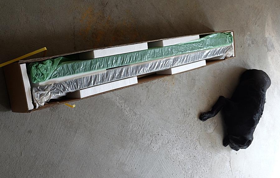

Check out this factory packaging. Everything arrived in 100% flawless condition. Exceptionally well packed.

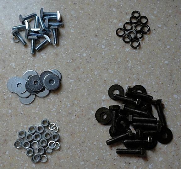

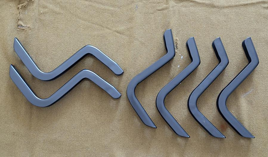

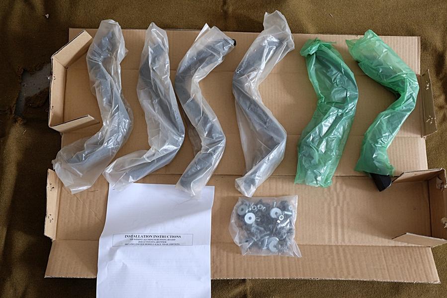

The running boards are a no cut and no drill design. They attach to the truck in the factory holes where the rocker panels are bolted into the truck. (Remove factory rocker bots, add running board bracket and Ionic supplied bolts.) The brackets are beefy.

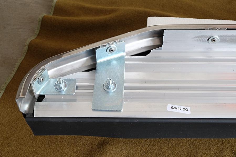

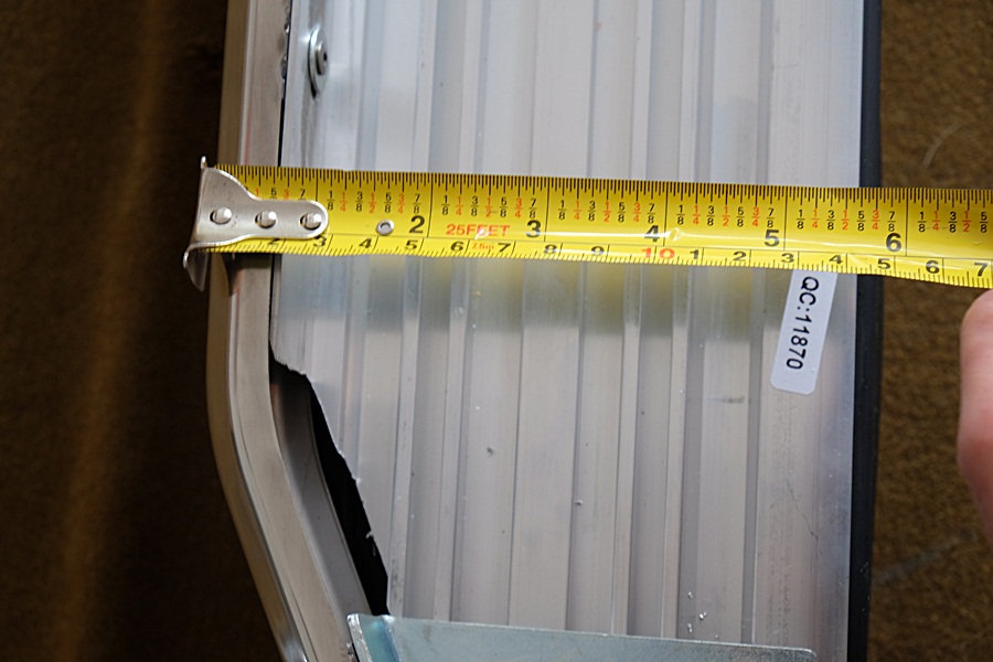

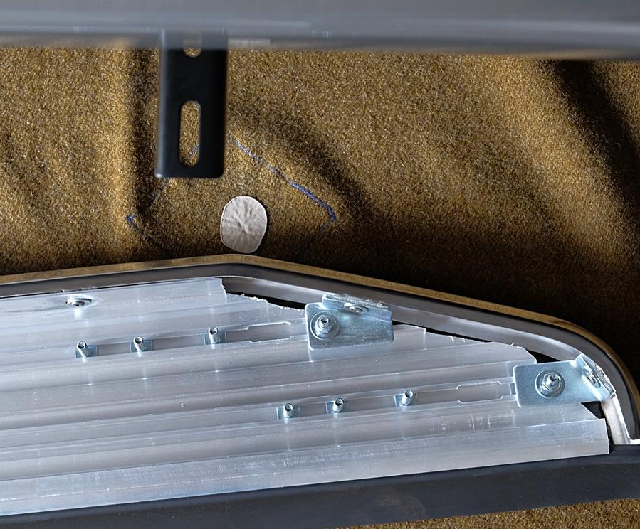

Here are some pictures of the underside of the running board. They are nicely made. The step is a little less than 6" wide. You can see how T-nuts are fitted into the running boar channels. the t-nuts, in turn, bolt onto the brackets attached to the truck at the rocker bolt points.

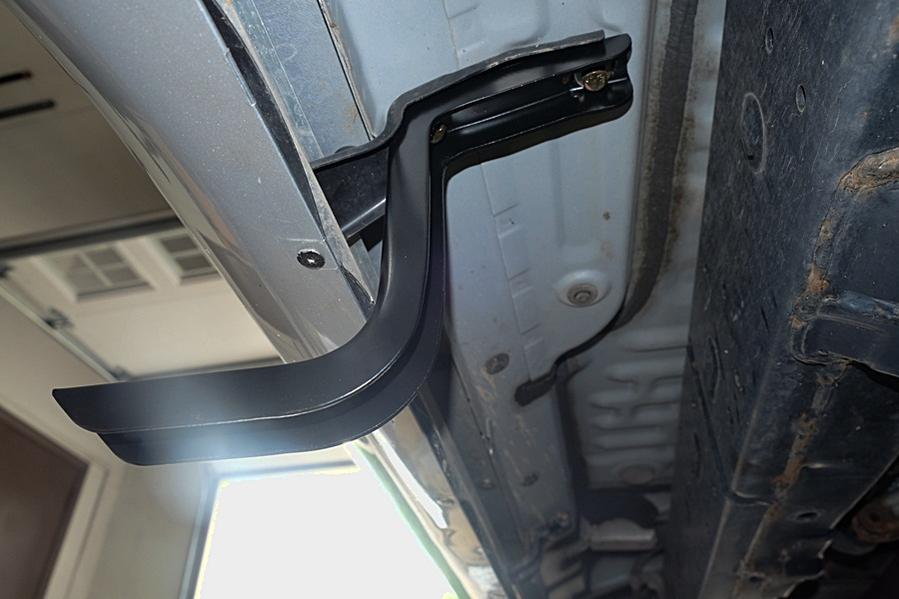

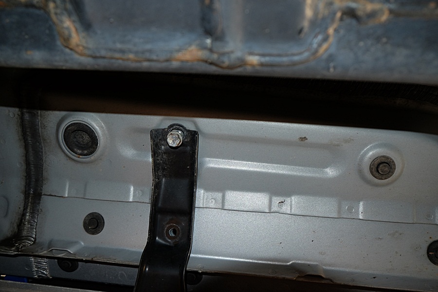

Here are pictures of the brackets going onto the truck. Very straightforward. 3 brackets a side.

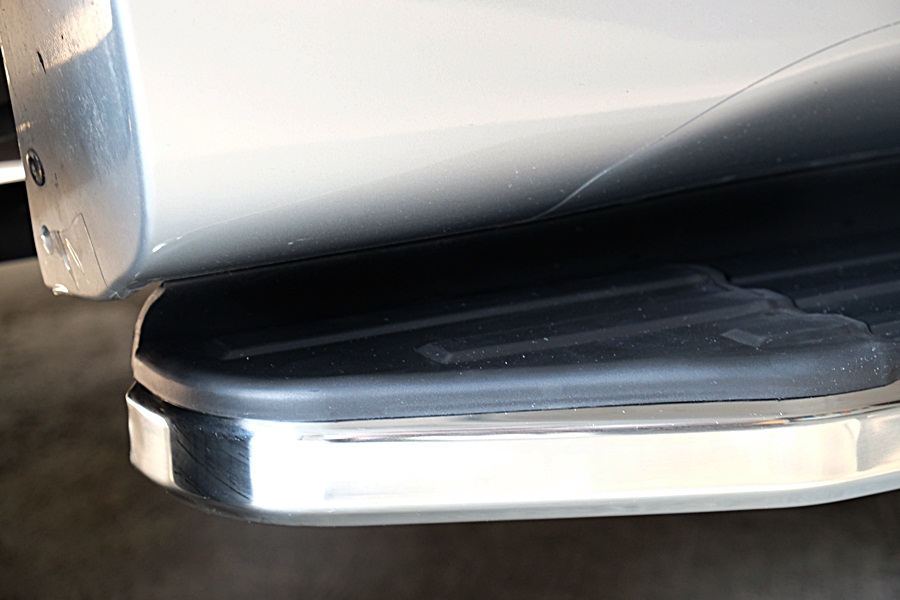

Sa-Weet!

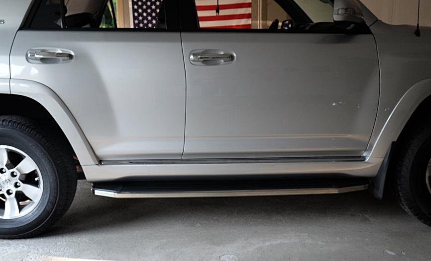

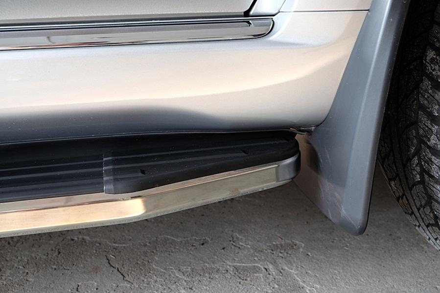

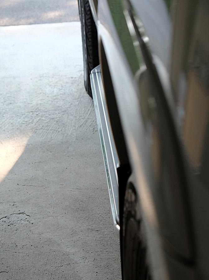

The running boards have roughly an inch of adjustment in width. I have them pulled out as far as they will go. As for width, check it out........
In summary, I am very pleased with Ionic quality, price, shipping, and ease of installation. Functionally, they give enough step so you can actually get a foot on them. Aesthetically, they don't look bad to me at all. At $319 shipped, I would buy them again in a second. If anyone has any specific inquiries, requests for add'l photos, autographed picture of my dog, please let me know. Happy to help out....
