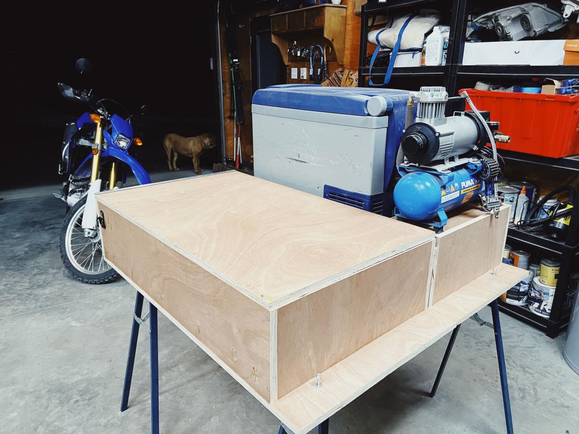

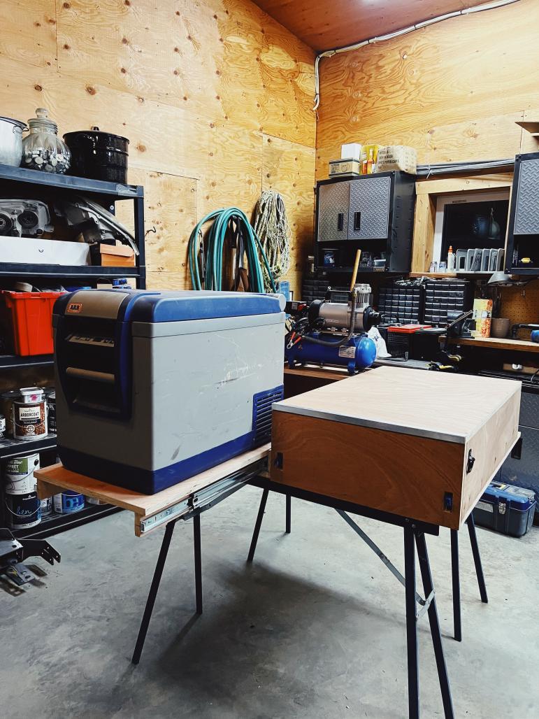

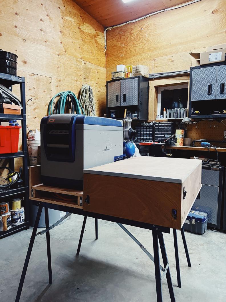

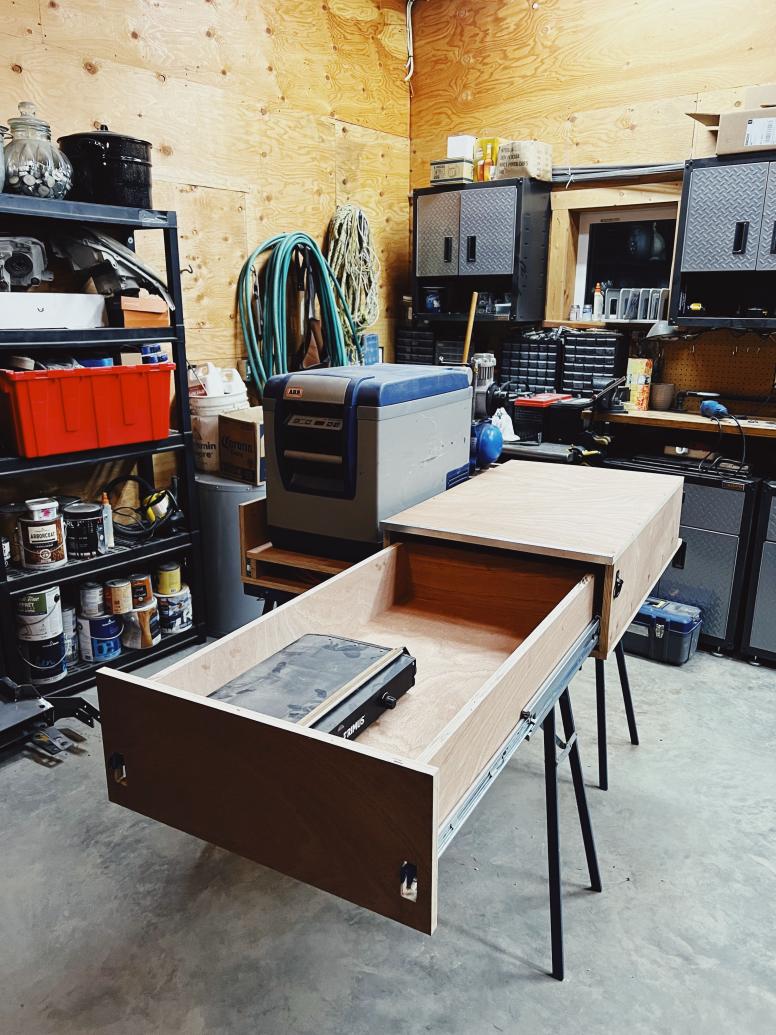

A little update on my sleeping platform - I ended up making a few changes to the design as I went along. A couple key pieces I wanted were the locking drawer slides that could take some weight as I plan to use the top (floating top not yet made) as a cooking surface. Then I really wanted a fridge slide as most of the one's that you can buy from ARB or Alucab are $500. The last thing I ended up finding a way to make work due to my bro [MENTION=63060]rickashay[/MENTION] pointing it out to me was to have a spot for my Puma Compressor. Stoked with where I've got it to.
Need to get some sanding done and clear coat it before I throw it in the truck for the summer. Then to install the piano hinge for the passenger side which will fold open when the rear seats are folded up. :fishing:

Thanks man. Yeah having the rear seats was key for me cause I'm finding I need my truck for more day to day use then full time camper/wheeling use. I also built it so the drawer side is 1 piece and the slide side is another piece so it's easier to take in and out of the truck if need be.
