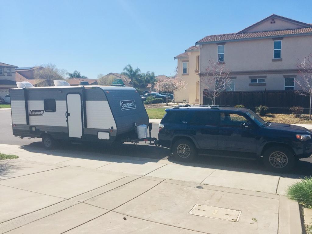

2016 4Runner Trail Premium
External/aux transmission cooler added
Redarc brake controller
Firestone Airbags in back
2021 Coleman Lantern LT17b 2900 dry/3300 when loaded (estimate)
Blue ox 750 weight distribution hitch
Always drive in S4. Tried normal “D” a few times and even on flat ground it dogs. Hard. Hitting hills, drop it down to S3, rarely S2. Gas sucks but you’re moving around 9,000 lbs with a V6 so what do you expect?
I wouldn’t go any heavier than probably 4,000 lbs total. The sway isn’t the issue with the proper hitch, the trailer brakes work great when set up properly, its the lack of power. You’ll get there, it’ll just take a little longer walking up the hills.
