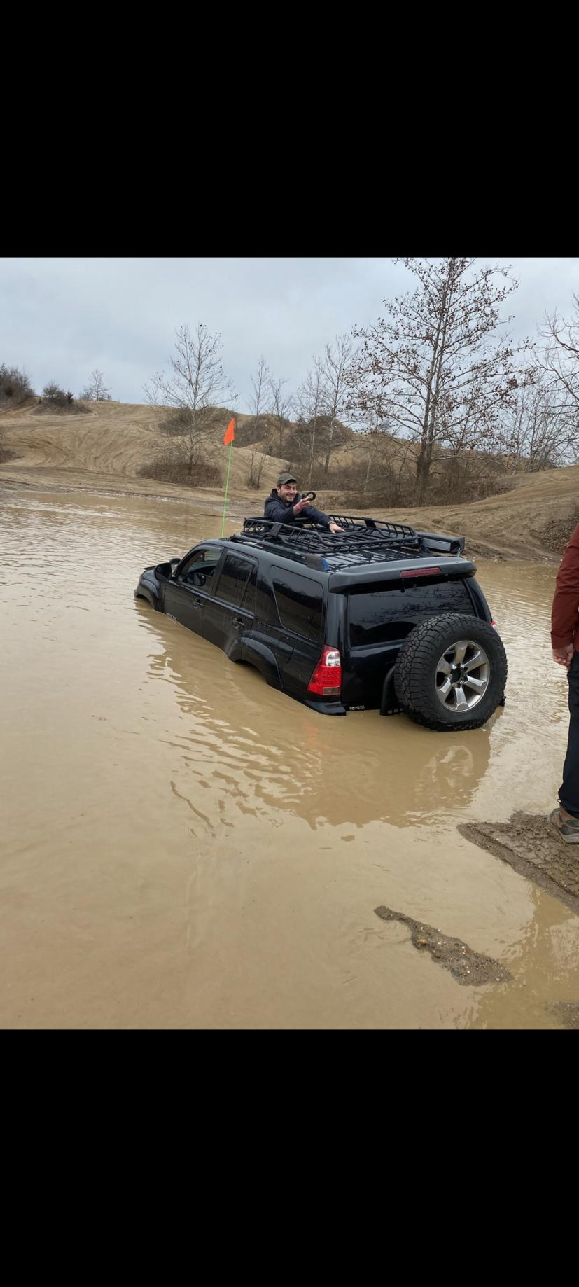

That's quite a bit of water. Would it get into the passenger compartment? Is the 4runner sealed well enough to keep it out?
as long as you maintain forward movement, and have the doors fully closed the 4runner will keep water out even if it is above the bottom of the doors, if you get stuck in said situation, prepare to get your feet wet though
Like said above, be sure to keep moving. I got stuck in a water crossing and had water come in. Water came in and soaked the 4x4 computer (under glove box) and I was stuck in 4 low. This trip made me decide I didn't need a snorkel. You will run into electronic issues before you run into issues with water coming into the intake.
