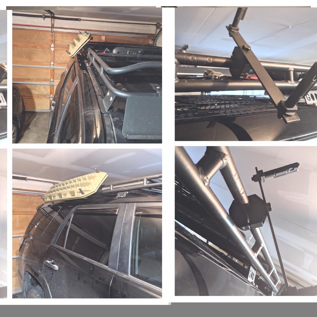

So i have an old Gobi rack where the bars can't move, so the only place to mount them requires them to be on top of the bars. I wasn't happy with that. Some mounting pins and a couple pieces of steel later. The bar mounts came from the previous owner. I think they may be custom. Haven't found anything like them elsewhere. They were used for a low profile tent mount.

I think those are mounting tabs for light bars. Typically sold as mounting clamps for round bars or something like that.
