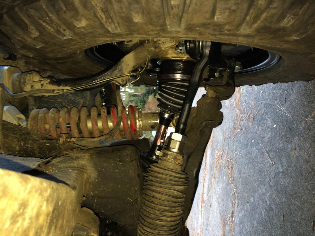

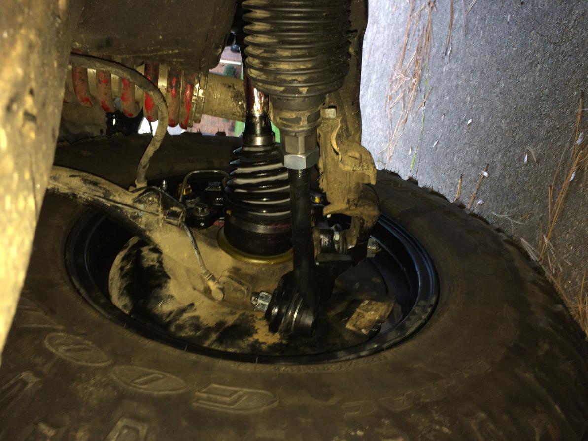

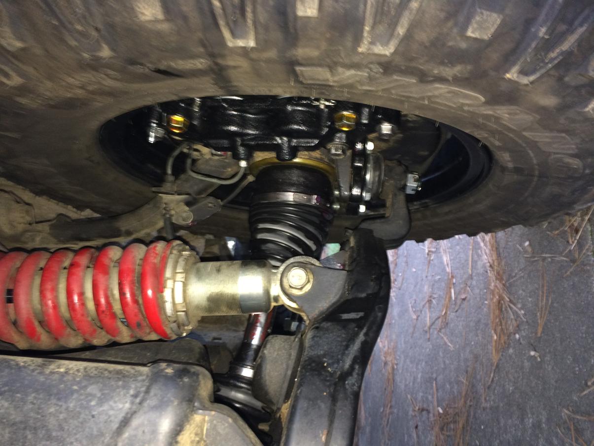

LBJ: Installation went well for the most part... installed all 4 bolts on both sides with blue loctite and torqued castle nut to spec on the bottom connecting it to the knuckle.
Note: there was one issue - I couldnt get the castle nut on one of the lbj's to tighten. The lbj seemed to spin with the nut as I tried to tighten it. I read somewhere that it would fix itself once i put the tire back on and it had some weight on it. It did not. Maybe I need to hit it with an impact wrench?
OTRE & ITRE: Installation went fine, Screwed the ITRE into the steering rack until the rack started to move with it. Felt like it was in the solid. ITRE screwed into OTRE fine and attached other end to LBJ with correct torque specs (~59ft/lbs)
CV: Both cv's went in fine. Attached both to diff and pulled on them and they felt like they were clicked in place. Inserted the spindle in through the knuckle and newly installed rotor & hit the axle nuts with an impact wrench. They both looked/felt nice and tight.

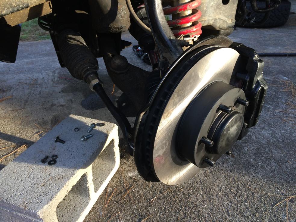

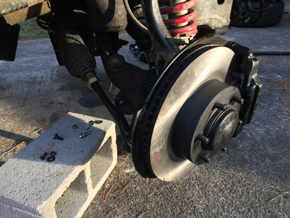

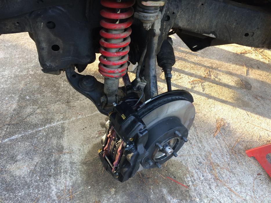

Rotors/ Calipers: After removing the old rotors, I slid the new rotors on. I dont think there is much else to this. As for the Calipers, they went on fine. Nothing to really report here.

Are you sure that you bled all the air out of the brakes? They are big calipers and take a lot of bleeding. For the LBJ did you actually get the nut on there and tightened or are you running with it just loosely on there? I've never heard of that issue.

I fixed the LBJ issue just now by hitting it with an impact wrench. Not sure why it was spinning with my breaker bar.

Did you count threads on the tie rods to try and get the alignment close? I'd get an alignment if you can safely get the truck there so that's ruled out.

Get it aligned. Have them double check everything while they are down there. Those are simple parts to replace and hard to screw up. Double check the torque on everything and if it's all good then get it aligned. The mind has a funny way of playing tricks on you.
Turned out to just be the alignment. It was just WAY out. Anyway thanks for the advice guys. I couldn't have done any of this without this forum. Cheers!

I did use a torque wrench on everything except for the ITRE connection to the rack. When I said "I fixed the LBJ issue just now by hitting it with an impact wrench. Not sure why it was spinning with my breaker bar." I meant that I got the LBJ nut/bolt assembly to stop spinning by using a quick burst from the impact wrench. From there i torqued it to spec.
