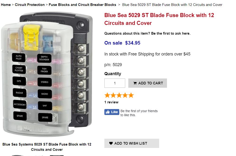

looking for more places to hook stuff up:
Blue Sea Fuse box.

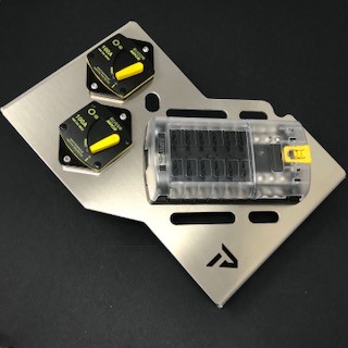

I have two lights I am connecting, both in the grill. I am dropping in a 12 circuit blue seas fuse box with a 100 amp breaker on a power tray.
here is the way I am thinking, if I have multiple wires going to the battery its going to look like crap and introduce a whole bunch of other issues down the road. this way I can turn the whole thing off with the breaker when my dealer says that is causing problems. and I have everything in one place. I will have no issues adding more stuff in the future and then I wont have to redo my two lights I am adding now. I will never come out to a dead battery cause a wire slipped off or any of the bs people have by running multiple wires to the battery.
did I forget to mention its going to be extremely clean? and to be honest, its really not that much more to do it right the first time. but that is just my opinion, then again its my truck

If I run more lights, which won't happen near-term, I'll either use that blue sea fuse box or a Switch Pro - no need to cross that bridge yet tho.
if you look at my other posts on the new powertray, it has two breakers on it, so you could run a winch off of it

IF the amp can draw sufficient power through a distribution block (again, install shop has warned against that) then I would go with this block for the amp and the light:
https://www.amazon.com/Blue-Sea-Sys...8&qid=1517938148&sr=8-2&keywords=blue+sea+150
If I keep the amp connected to the battery and add more lights in the future I'll either go with a Switch Pro or a blue sea fuse block similar to what Dave posted.
this is available from power trays now, I have one going in on 2/26. I am going to use one breaker for the fuse box and right now the other breaker will be doing nothing.
just throwing this out as an option...
