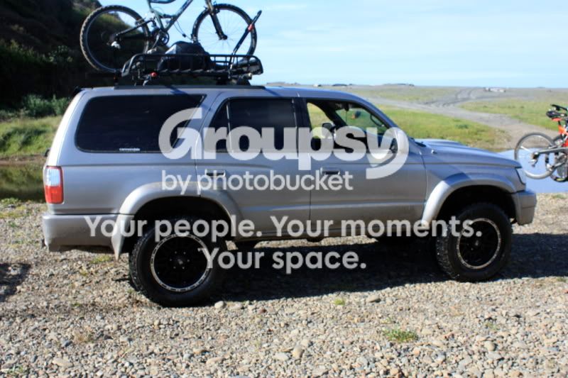

umm i believe that the OME set up starts with like 2 inch front coils and 2.5 inch rear set up. so idk if your shocks would allow that and articulation. if i remember i have the 89o's on my car and it gave me the 2-2.5 lift. and the 891's are 3 inches for the rears
http://toyteclifts.com/index.php?pa...ategory_id=71&option=com_virtuemart&Itemid=53 heres a link you can poke around it gives you the lift sizes and all of that.
this is the 2 inch lift from OME
