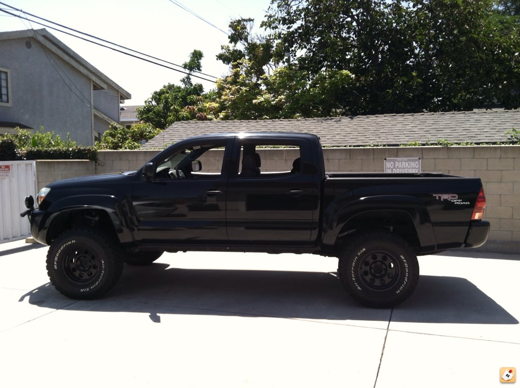

I run them on my Tacoma...love em'
and tried on my 14 runner but they are discontinued!
