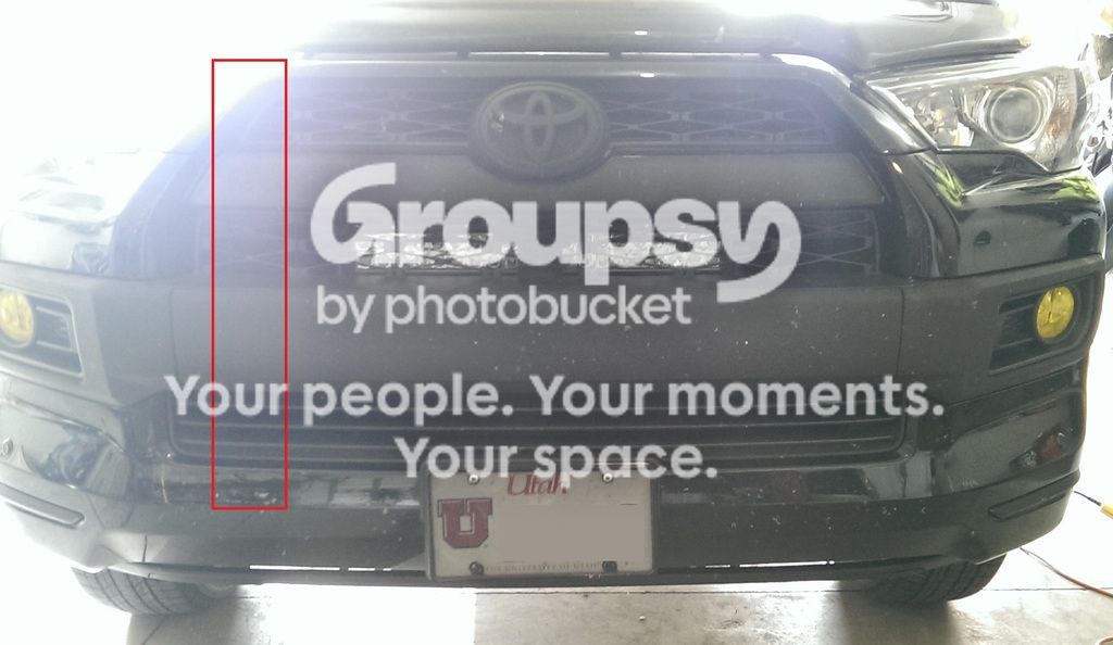

LED bar - Will most likely be the first mod, and most likely will be tucked/hidden in the grill. Been eyeing an OPT7 32" since I'm not needing the specific optics of the Rigids, and I'm uncertain about the Epistar brands? Input is welcomed.
I've got the OPT7 22" in my grill and I really like it for the money. I initially got the 32" but it wouldn't fit behind the grill without cutting out a part of the air dam (approximate location indicated in the pic below in red). It's not a big deal, but I didn't want to do it. I still need to do something about the grill blocking some of the LEDs...
IMAG2143_zpsavqiwzrh.jpg~original

Just pointing out a couple of things....
Since you are considering a SSS Slimline Hybrid bumper and an LED bar, I suggest looking at the SSS Slimline Hybrid bumper first before the LED bar, or the 2 together at the same time....Kevin can make that happen.
See if the bumper, winch and LED light bar all together will work for your needs.
If you install the LED bar first, you may be pulling it back out when you install the SSS Slimline Hybrid bumper.....
Just something to think about...

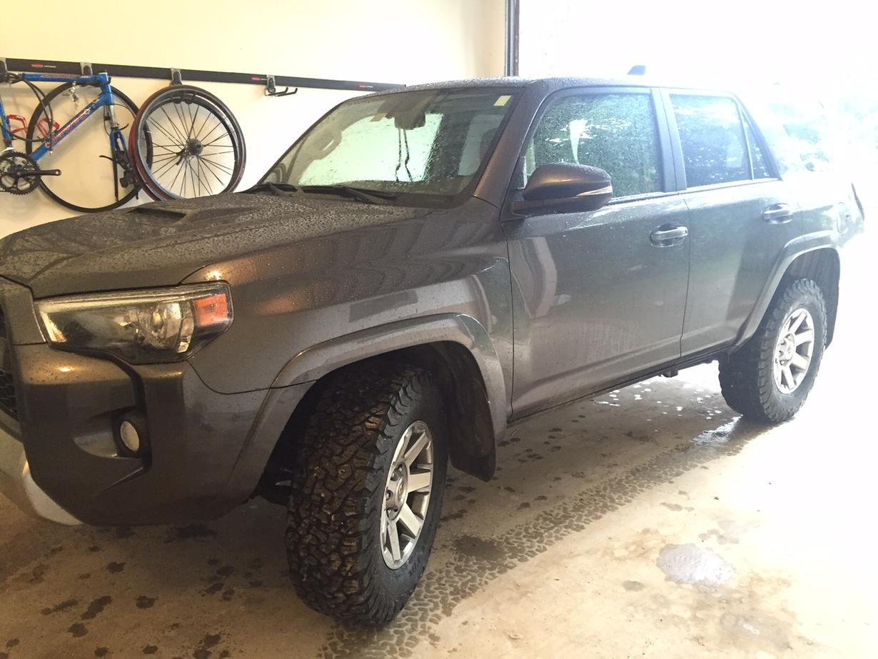

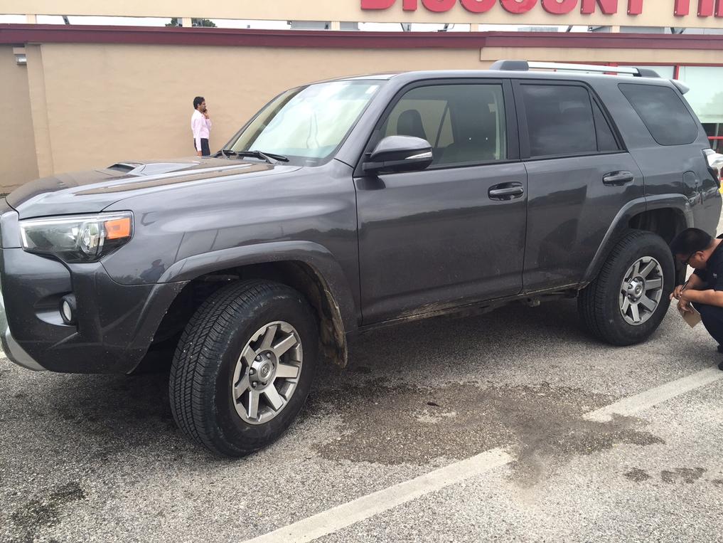

Before shot:

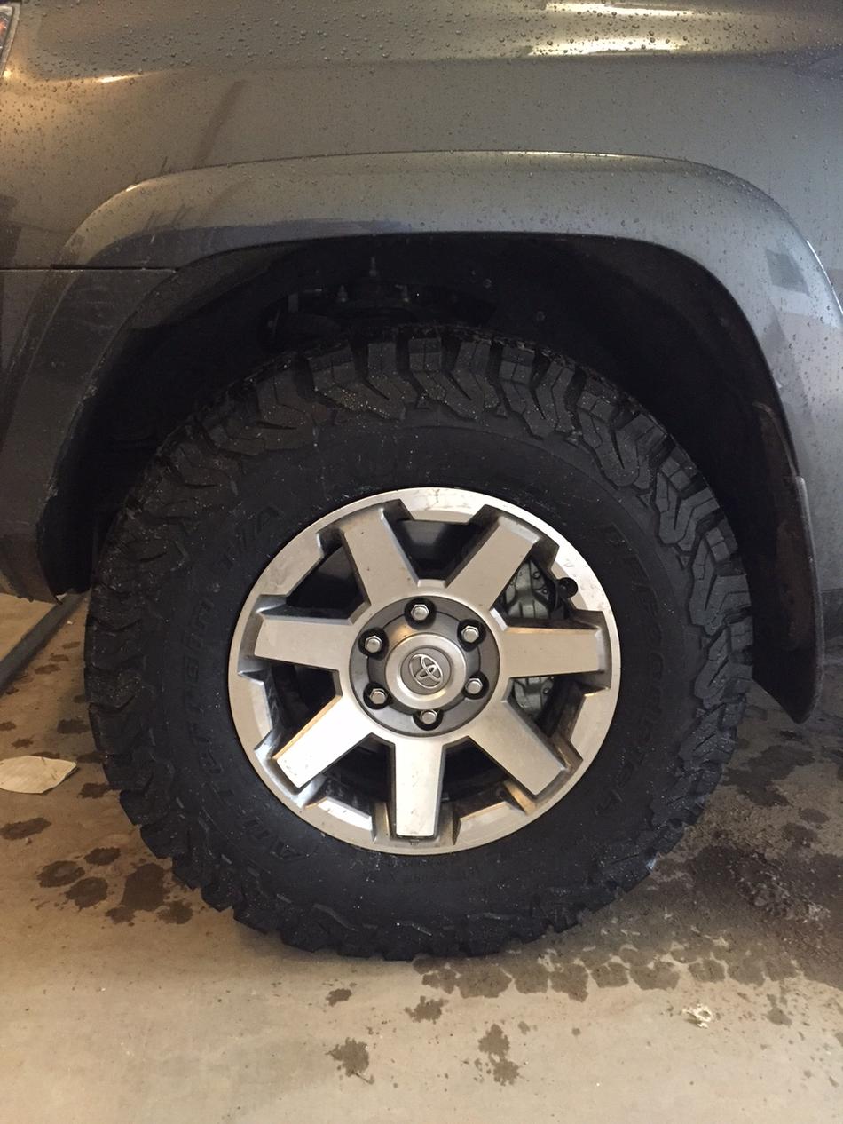

Got the KO2's installed today!
Went for the 275's, and I am pleased. No rub, and it's raining so I did some wet testing before and after getting the tires changed. Definite grip difference from that alone.
Can't wait to see how they continue to perform.
Before and afters:

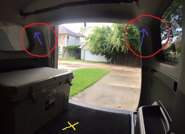

Cargo Lighting Question
Does anyone know how to get the panels off which are circled in red on the attached picture? Further, any idea how much room is behind that panel? I'm going to add some flush mount flood LEDs to light up the rear cargo area more directly. The plan is to wire them up with the rear hatch lights via other build threads I've seen with similar mods. I will place these where the arrows point in blue. Then where the yellow 'X' is is where I plan to angle them which would put them aiming at the back of the second row of seats.

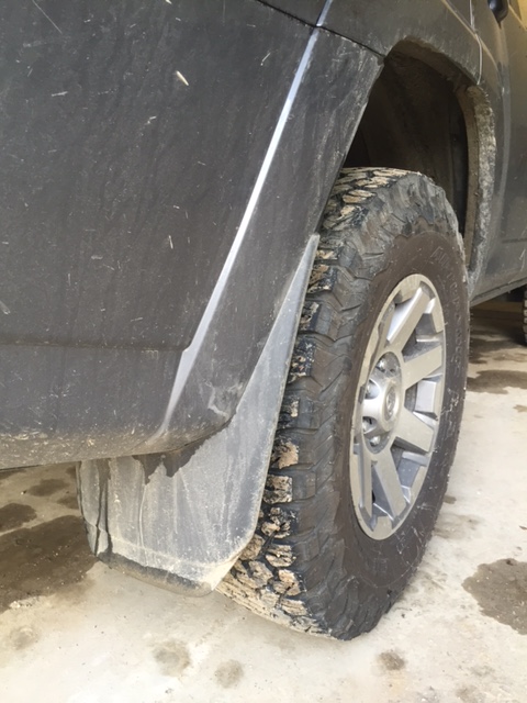

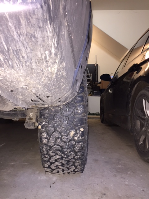

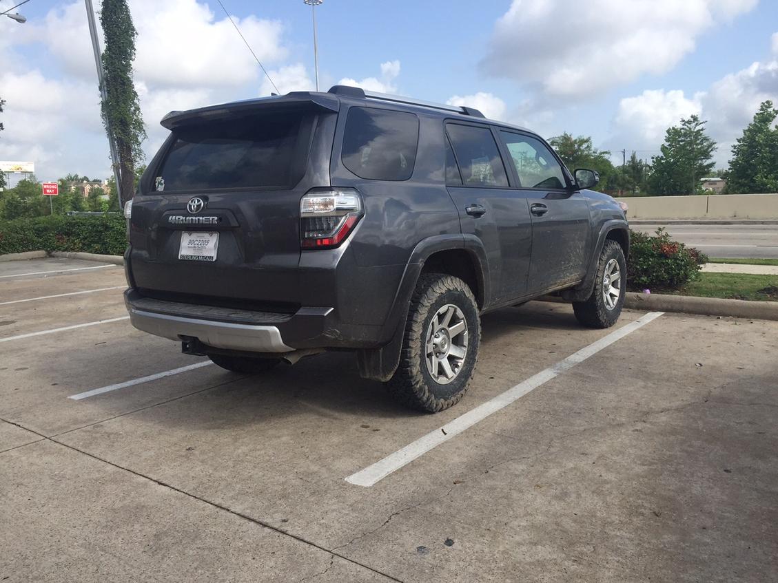

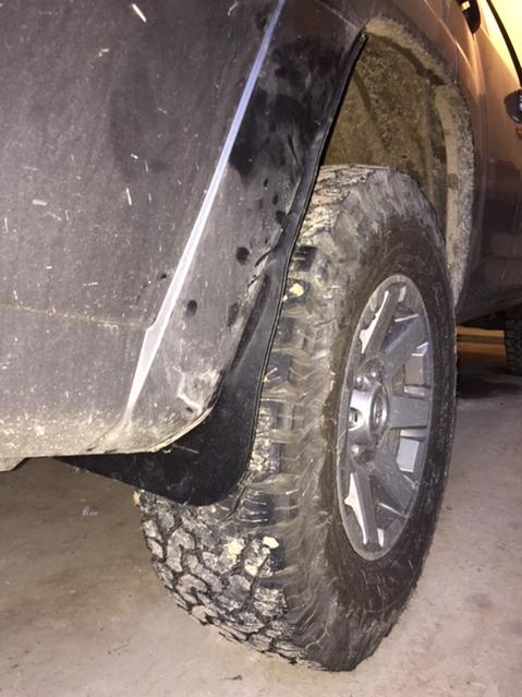

Mud Flaps Deleted
I didn't want mud flaps on my 4Runner when I ordered it, but it came with them installed. I don't like the way it looks. Today I did something about it.
Total time from going to the store, uninstalling/prep/fabricating mud flaps, eating, watching some of the NBA Finals, and finishing the project was 2 hours. This project is also VERY easy.
I took the front mud flaps off with no issue. I then removed the rear mud flaps and was anticipating the "hole" that was exposed after the removal based on other threads I had read.

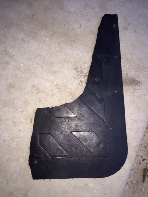

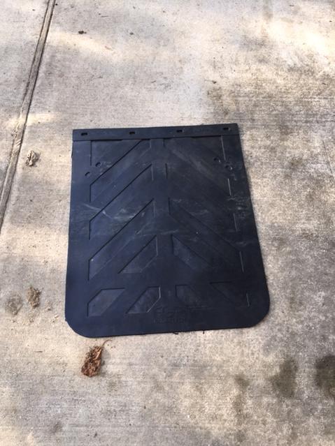

I went to O'Reilly Auto Parts and picked up a generic 18-wheeler mud flap to base my "insert" off of which cost $13.

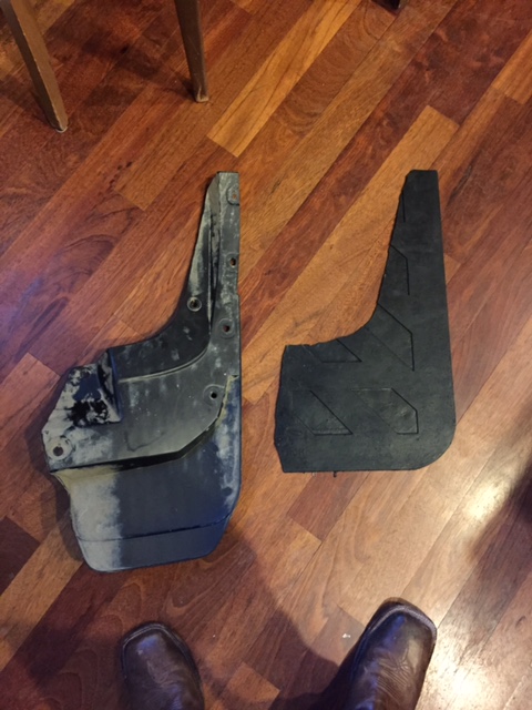

I laid the rear mud flap on the 18 wheeler mud flap to outline, identify where the stock holes are for mounting, and prepare to cut. This 18 wheeler mud flap is generic polyurethane and was easily cut with a sharp knife.
After cutting, I drilled through the markings I made for the holes to mount.

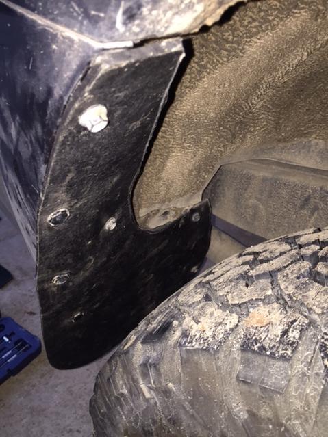

The holes lined up perfectly, and I installed it on the rear mud flap area to which I found that the fabricated "insert" covered everything I needed it to.
After getting everything cinched down and screws tightened, I took the same knife and trimmed the extra parts off of the flap to get it flush with the body.
I'm pleased with the result, and it was much cheaper than having to talk to the dealership to find whatever part they'd want to sell me that does the same thing.
Hope this helps someone who is looking to do the same thing.

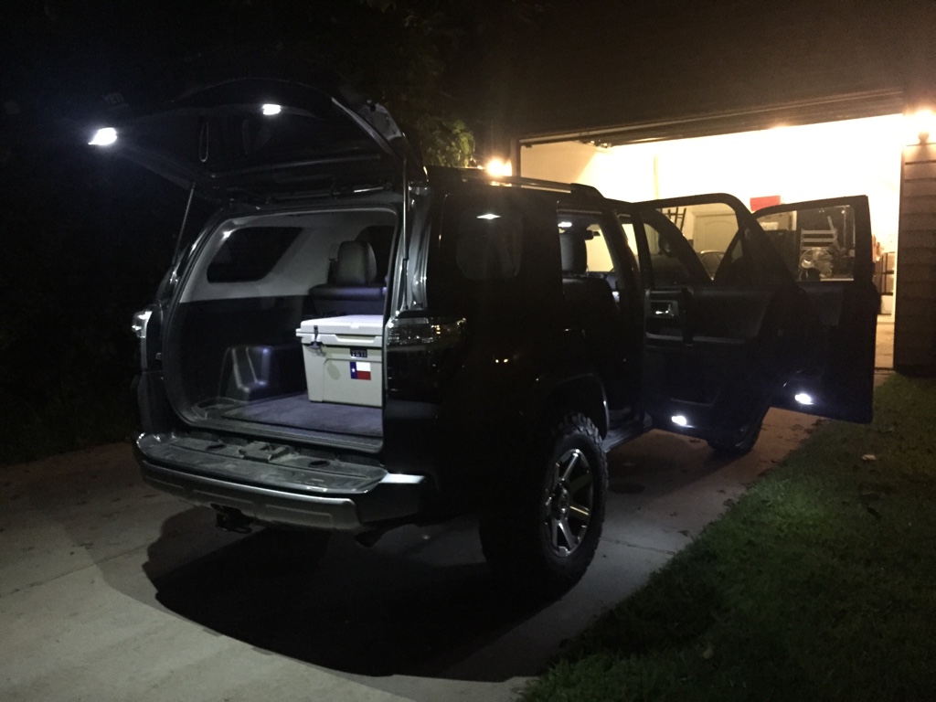

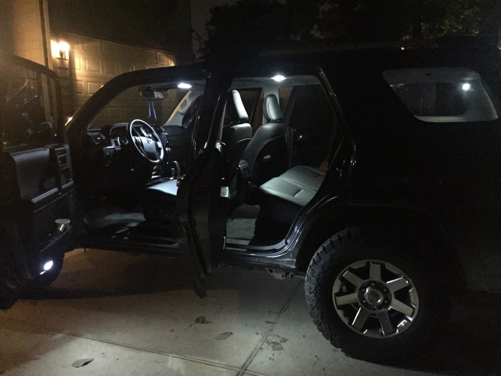

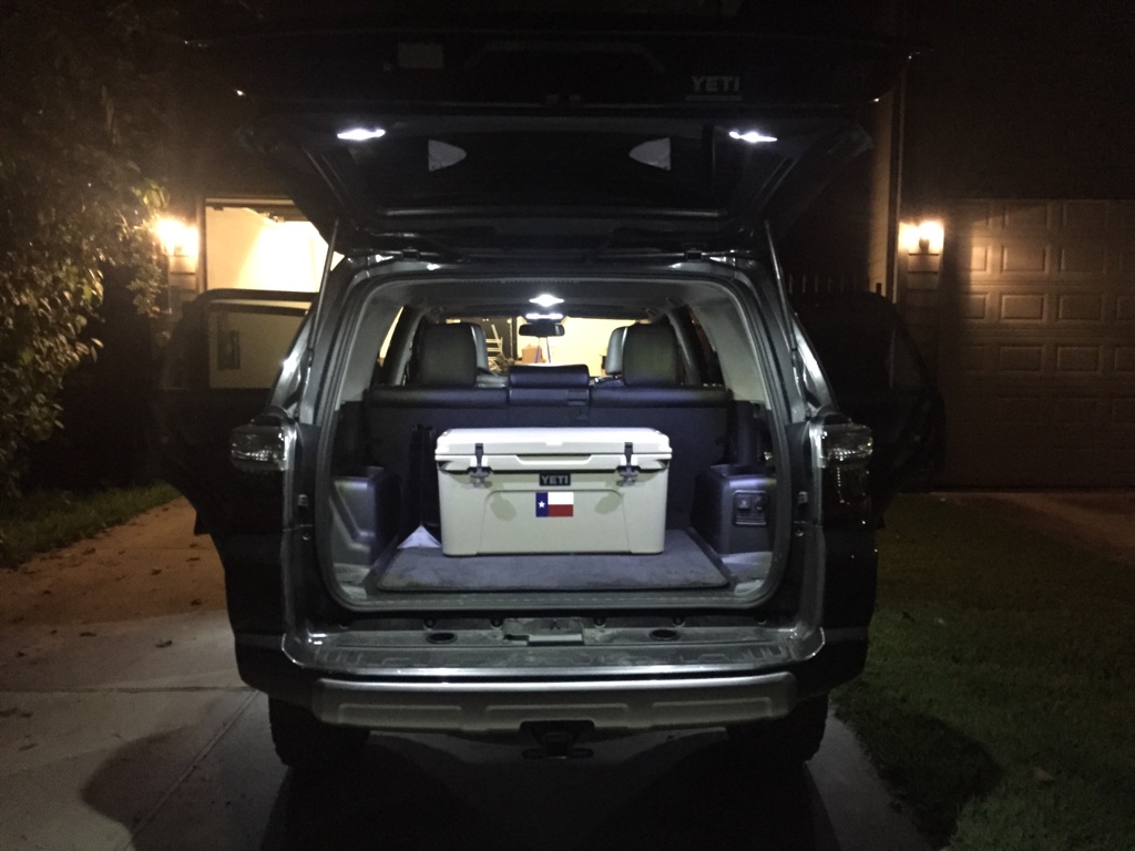

Interior LED swap complete. Used the Yitamotor eBay set and I'm pleased after installing. Maybe a little blue overall but not a bad deal for $20.
With my cargo area LED installation from earlier, now anything in my cargo area appears like it is being shown off at a museum with this type of lighting!
And license plate lights were changed. Haven't gotten around to changing the mirror puddle lamps yet.
