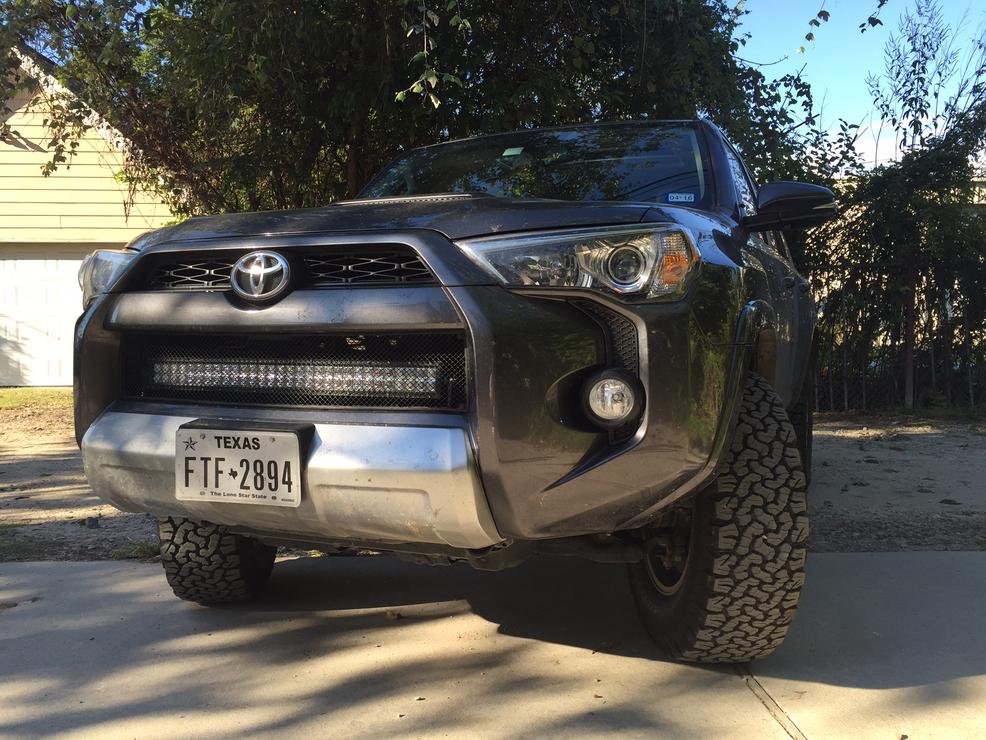

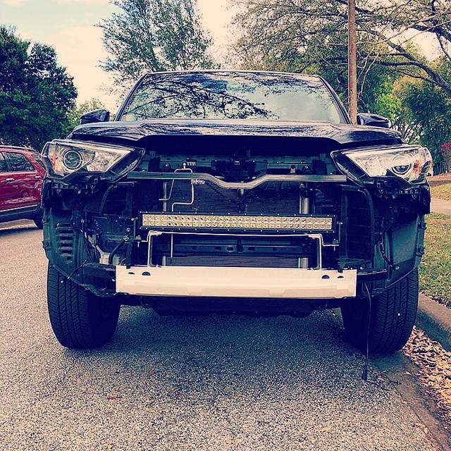

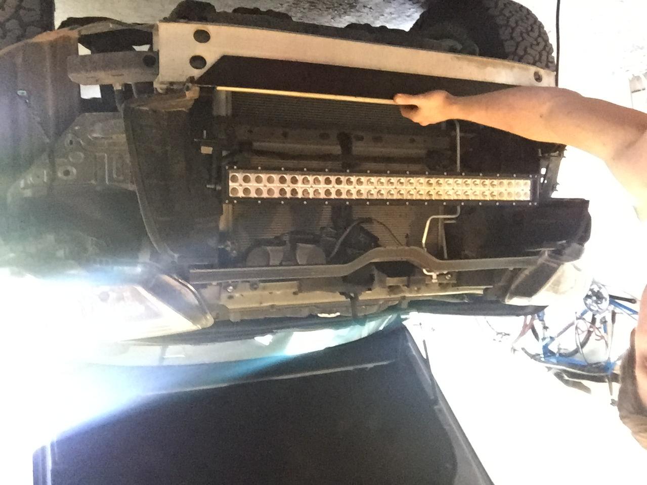

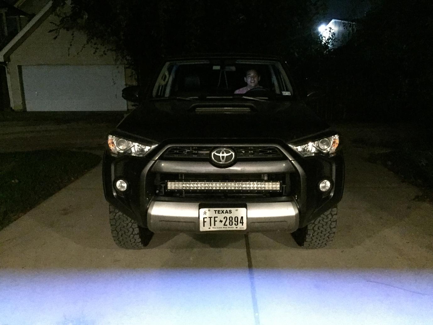

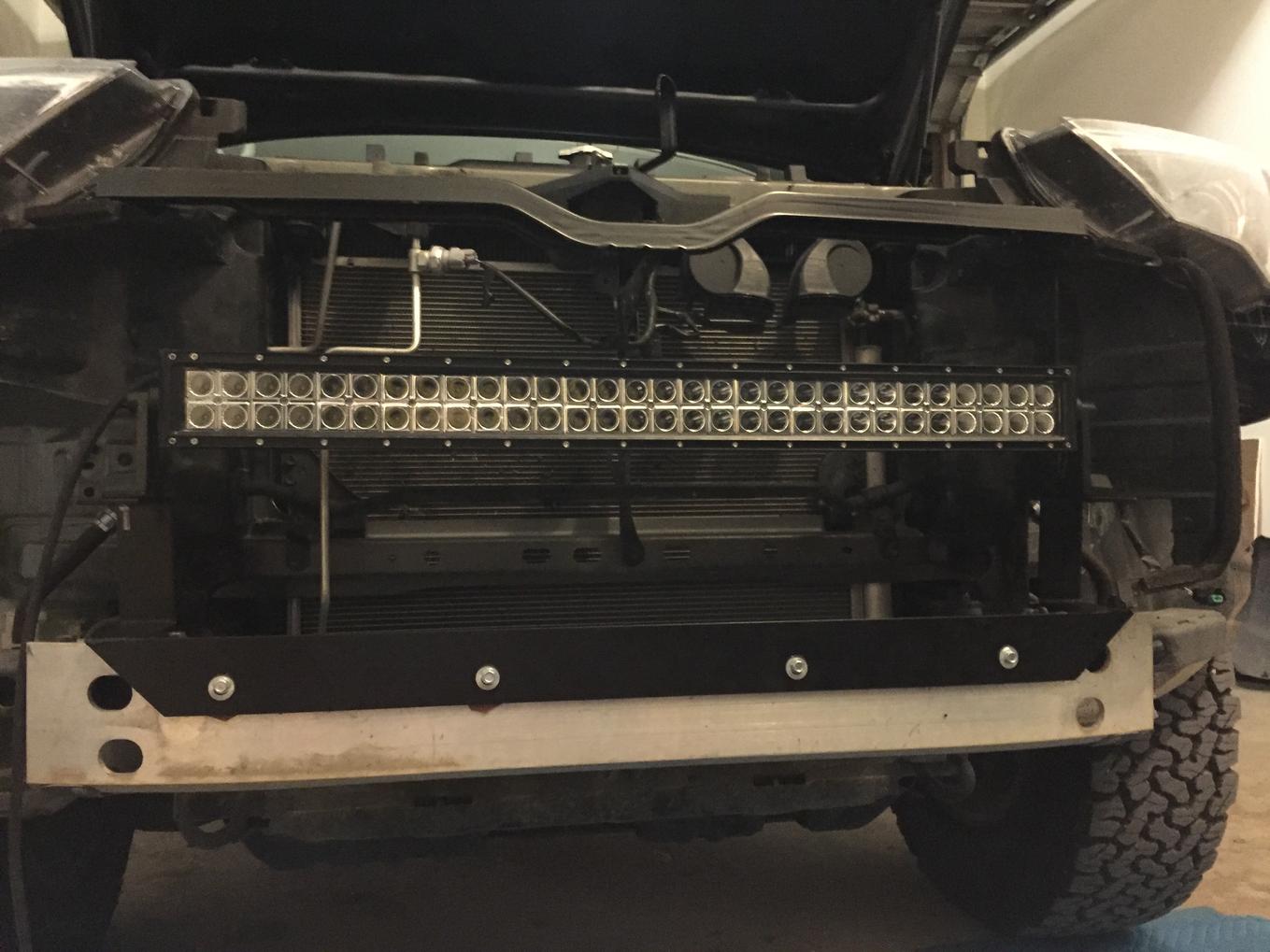

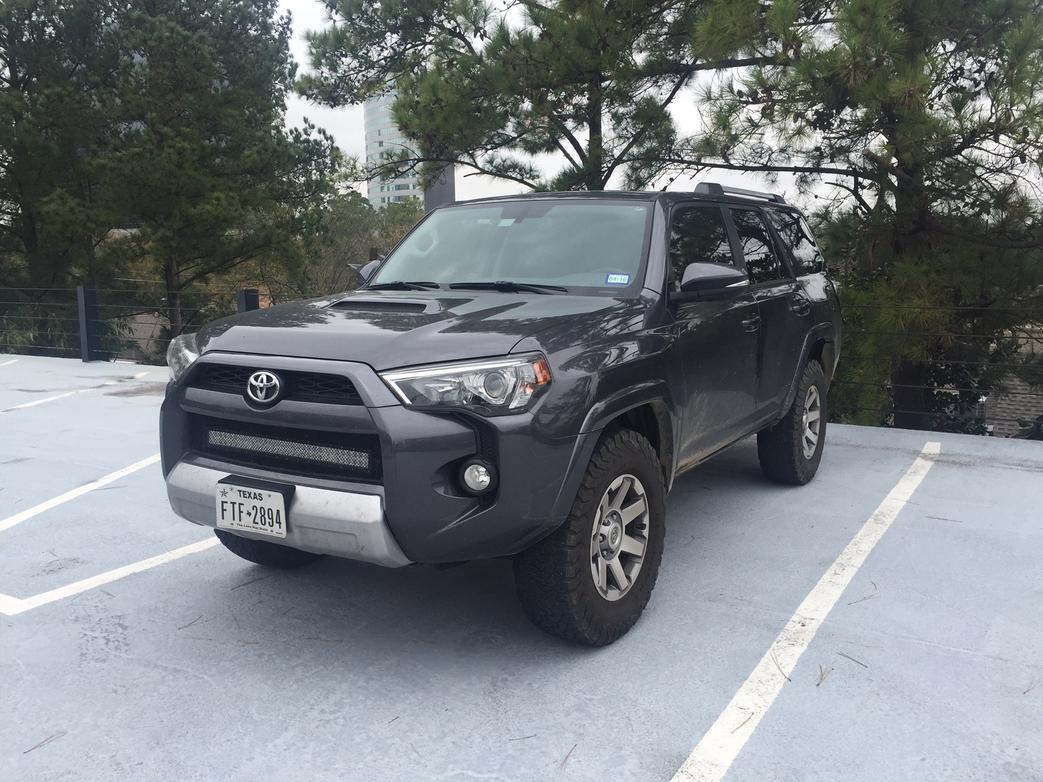

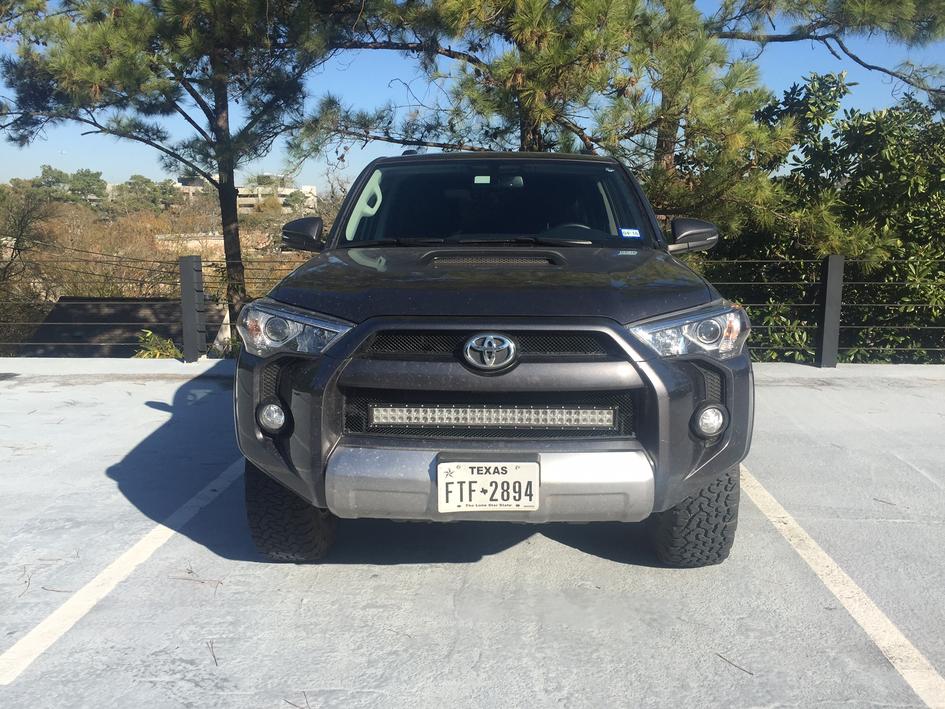

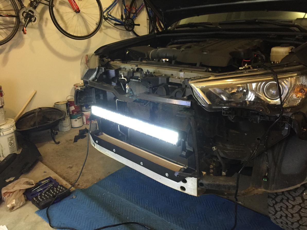

This weekend I finally got around to installing my light bar in my grille.
I had a friend fab up a bracket a couple of weeks ago to my exact specifications that I needed to install it in my grille area.
A little bit of cutting was required on the air dams, but ultimately not much, just enough to squeeze my bar and bracket in.
Removed the front bumper piece, then held the light and bracket in place to see where I needed to cut the air dams. (sorry, don't have pictures of the air dam cutting)
Mounted the bracket by drilling pilot holes into the aluminum front bumper support, then drilled in self-tapping screws with rubber washers on the front, and gasket rubber on the back to prevent additional vibration.
After mounting, plugged up and tested.

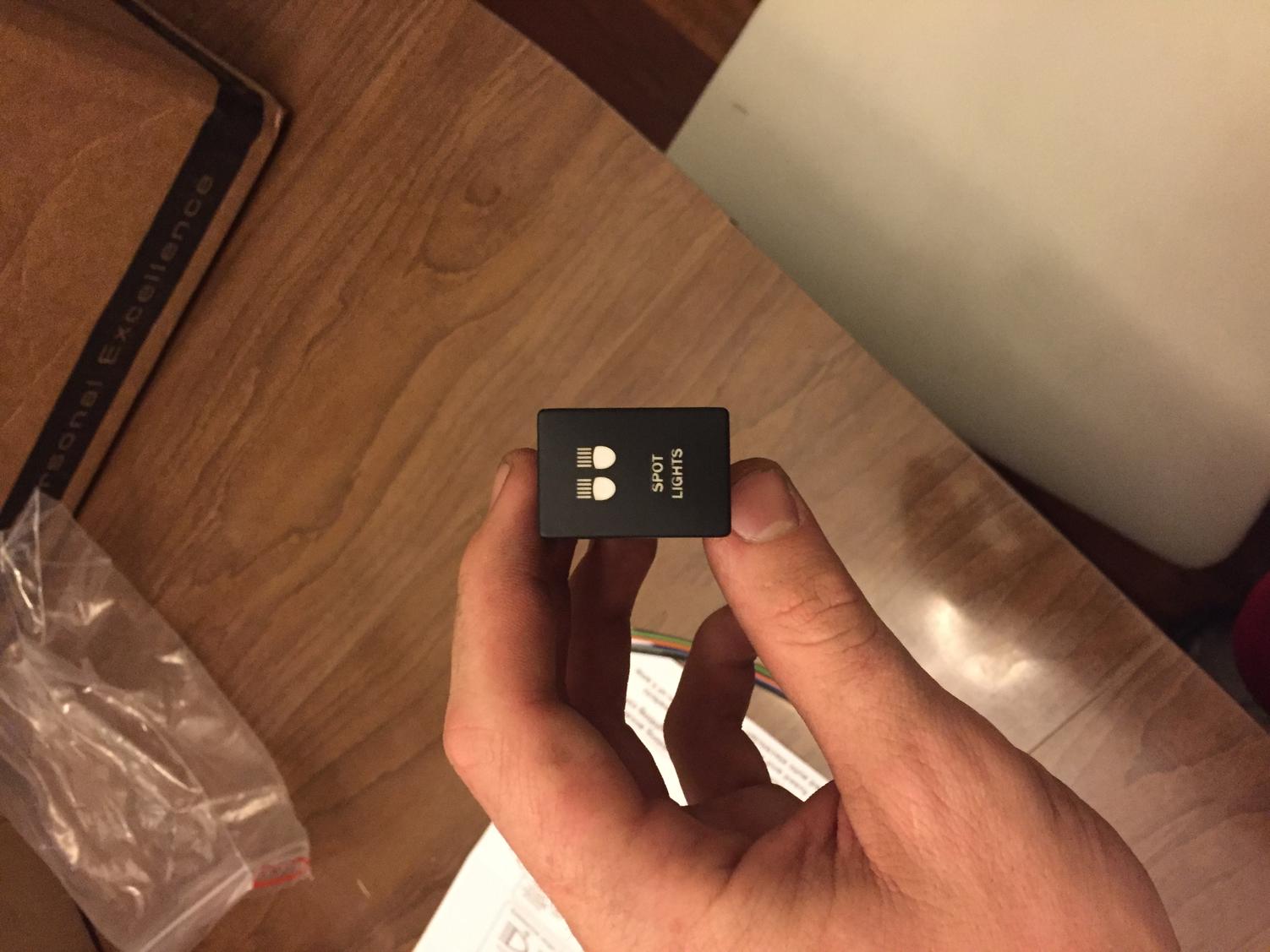

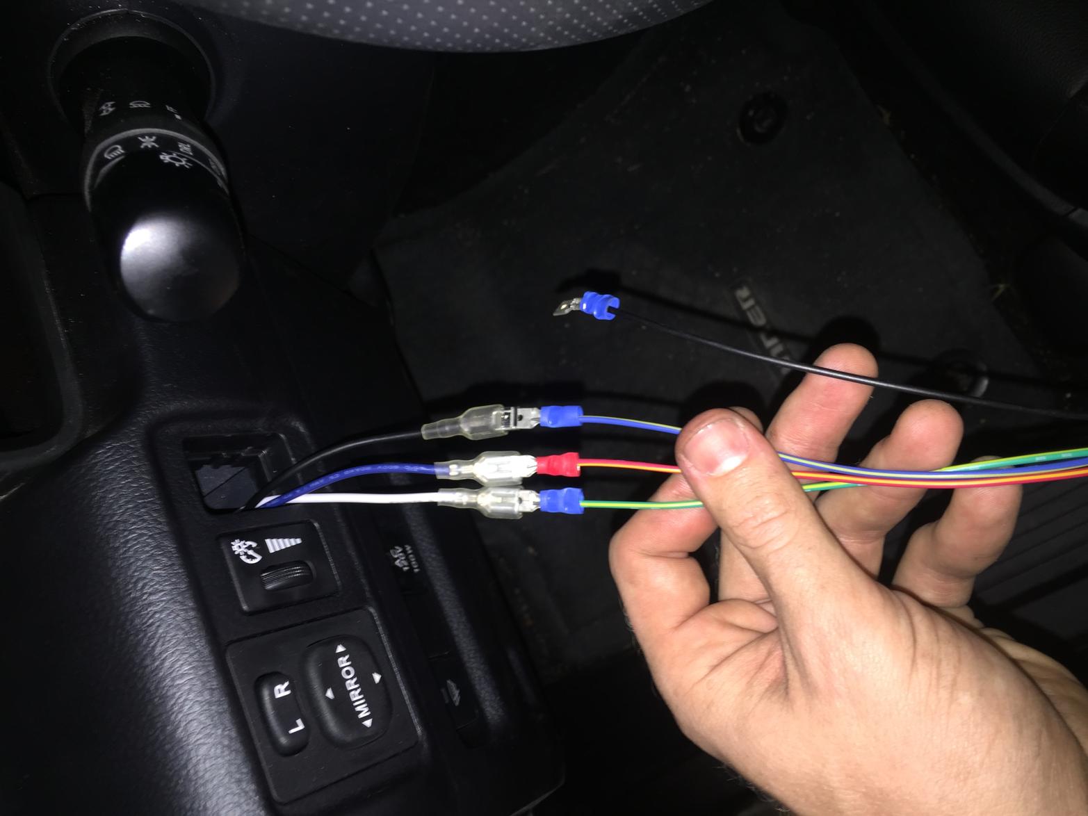

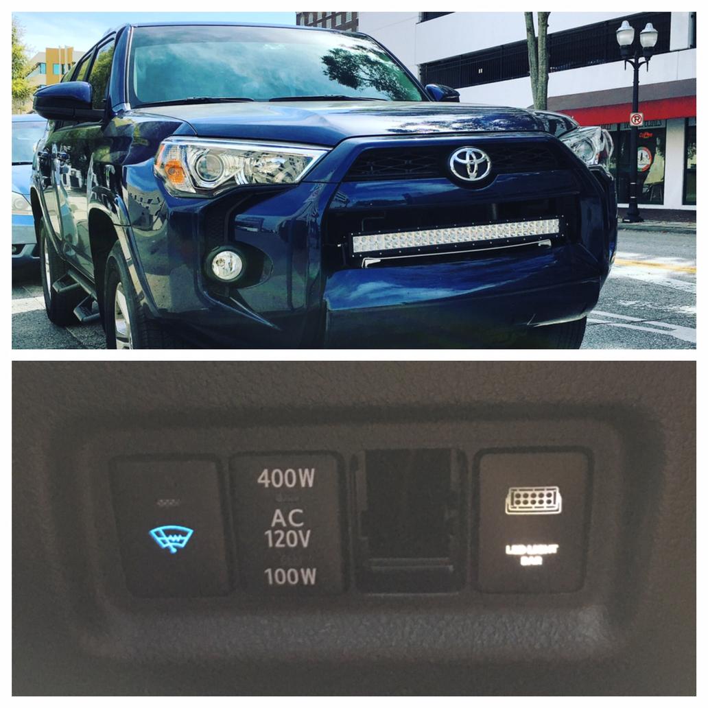

Installed the switch in place of the dummy panel right behind the headlight stick on the steering wheel. Used an AOB switch you can see in the pictures. Cut just enough into the firewall rubber grommet to squeeze the wires through (supplied relay), and plugged it up.
Hadn't finished the lower grille yet, but you can tell that in the pictures attached. You also see that the feet of the light bar supports were pushing up on my bumper...
...con't below...

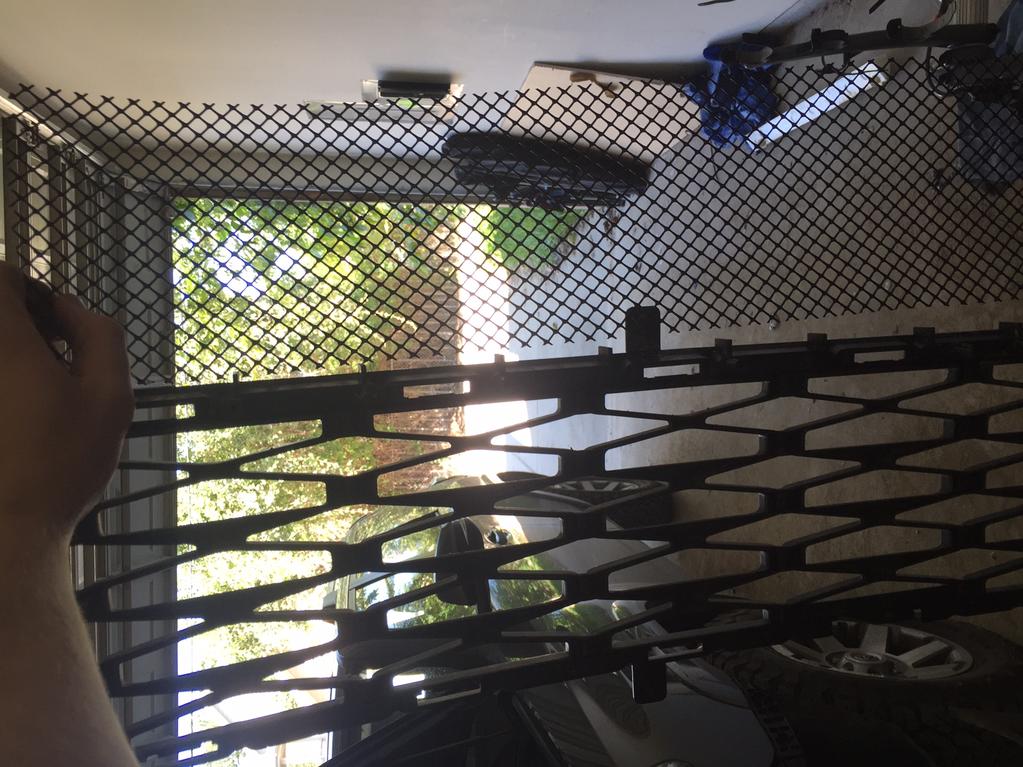

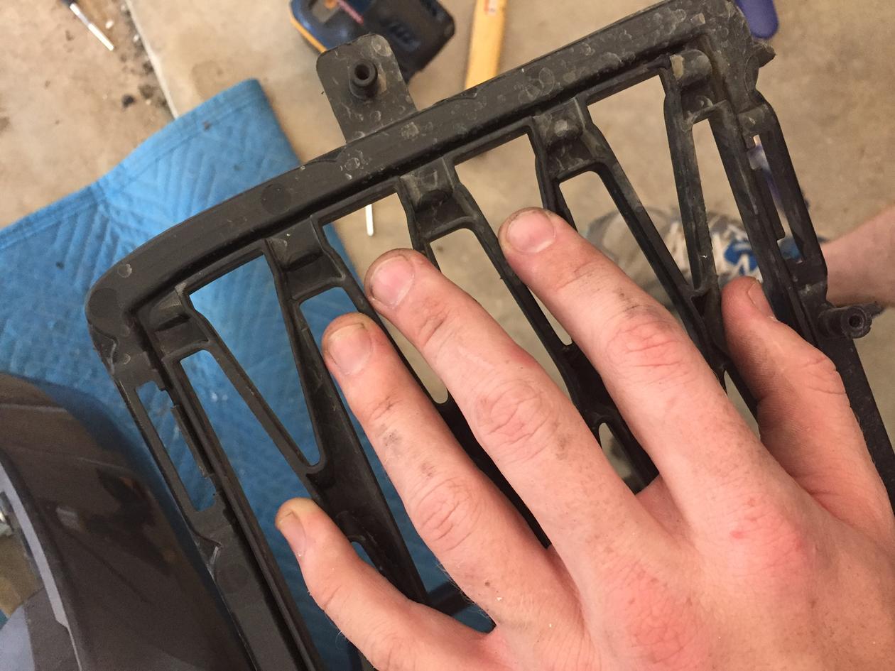

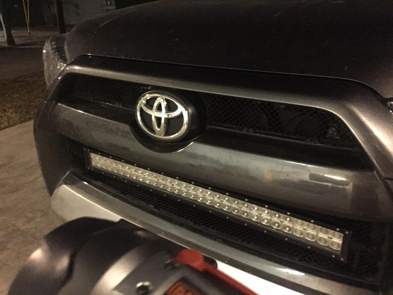

Satoshi Custom Lower Grille:

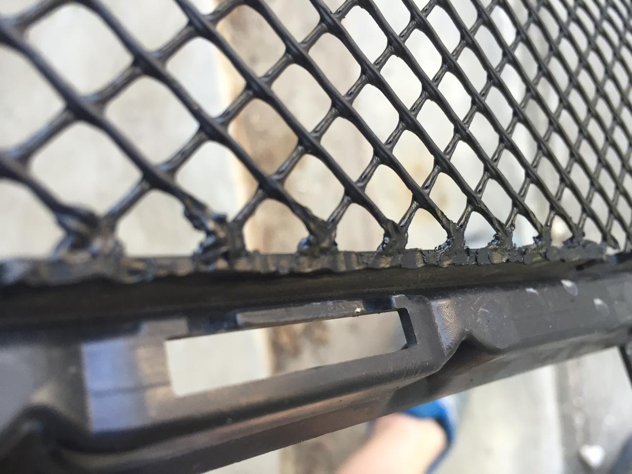

Took the lower grille insert out, and decided to cut it up.
Cut out the interior portions (where my hand is covering) to reuse the grille "frame."

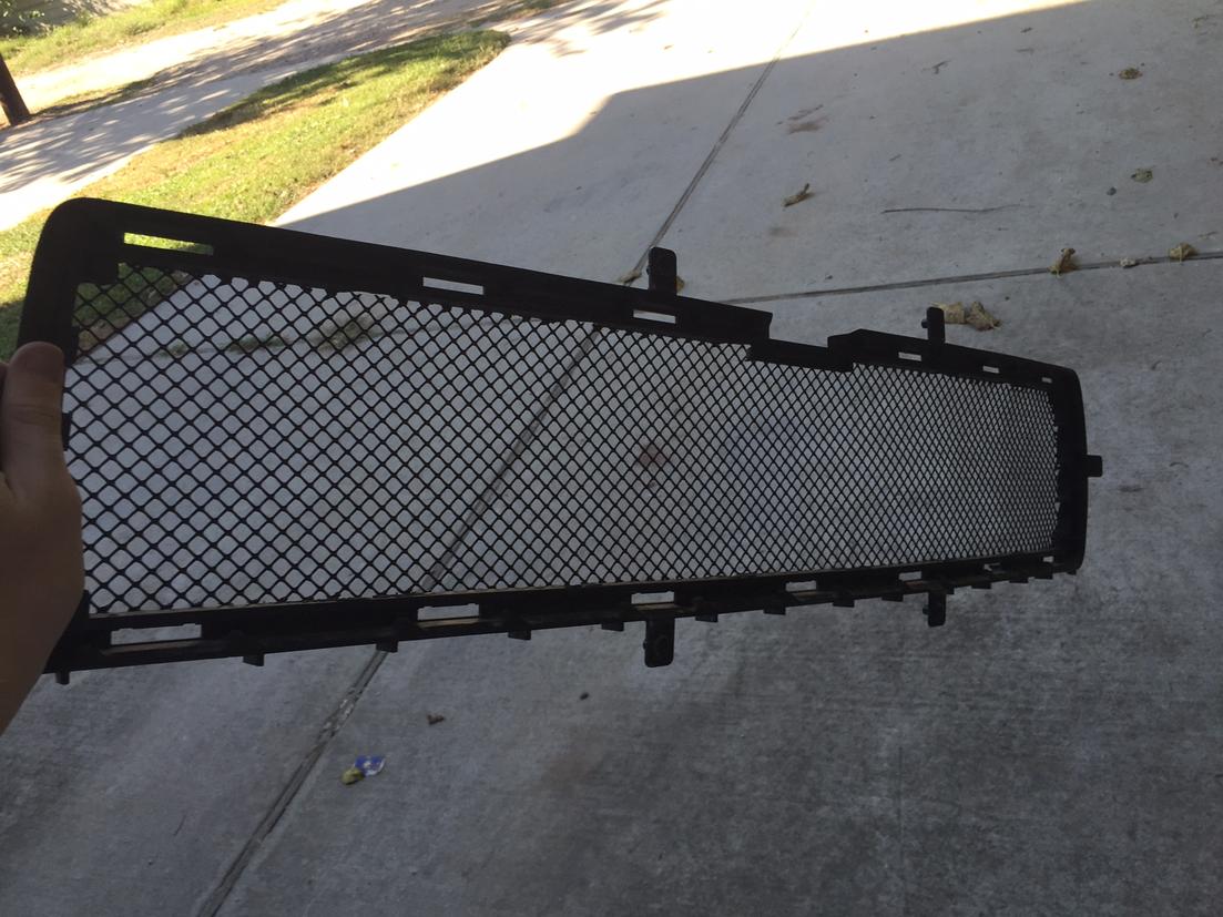

Bought some plastic gutter guard from Lowes (Shop Amerimax Plastic Gutter Guard at Lowes.com) and it was 6" exactly...perfect width for the lower grille. You can see the comparison of the two materials side by side in my pictures.
Then I used a sautering iron to melt the plastics together on the inside of the frame to hide any imperfections. Worked like a charm (as you can see in my picture below).

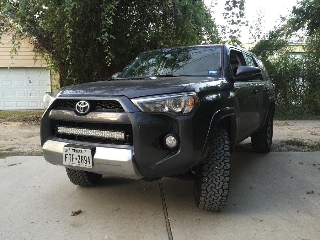

I actually had to scoot the light bar supports back a little to get the pressure off of where the grille clips in, but once I did that it fit flawlessly.
You can see the finished product below. I'm very pleased and have already gotten compliments in parking lots.
Hope this helps!

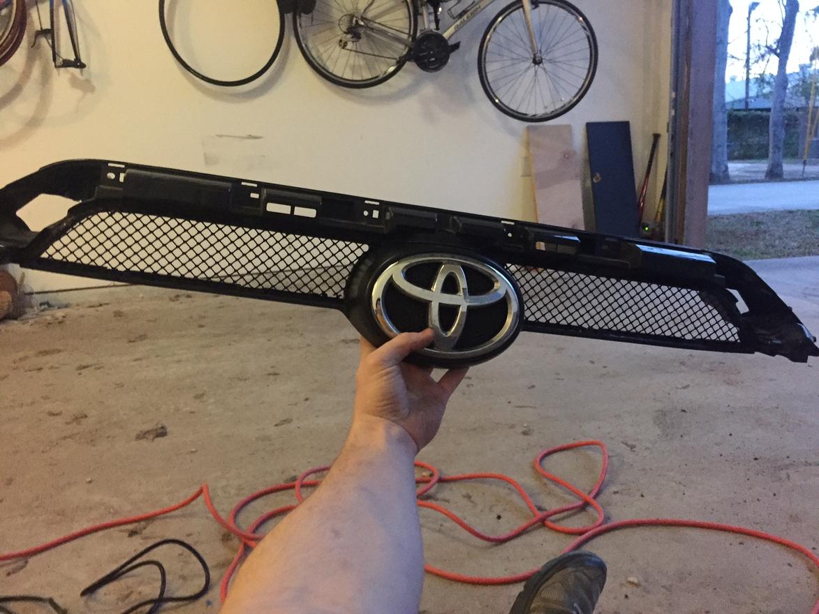

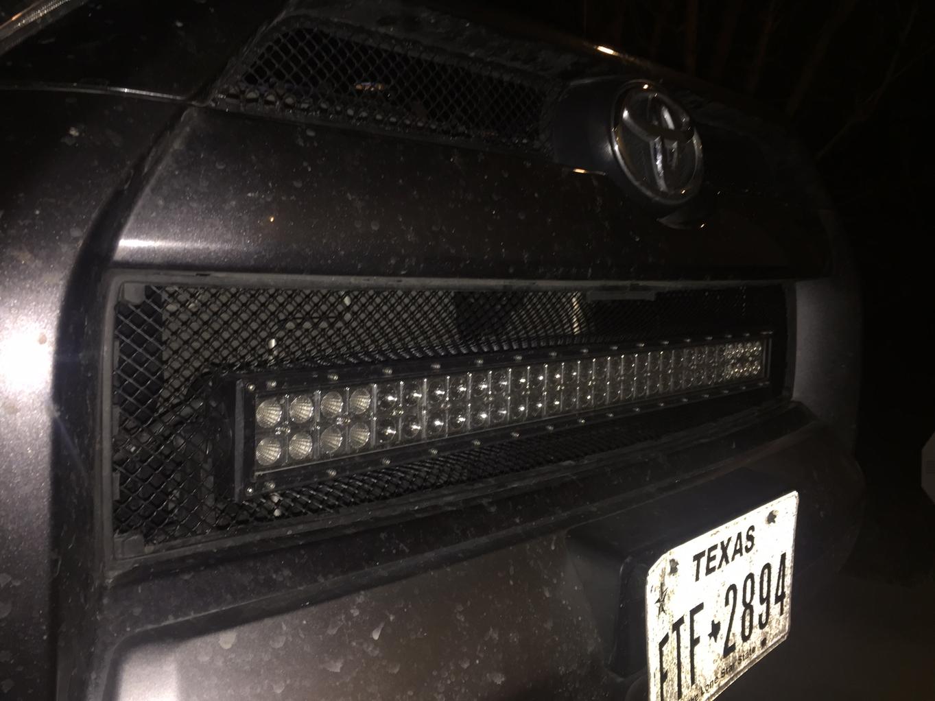

Mesh Match
Finally got around to matching the upper grille section with my lower grille section. I ended up redoing the lower one to let my light bar have the face in front of mesh to not be obstructed anymore.
A couple rough parts if you really inspect it, but that's because plastic welding is never the cleanest anyway. Looks pretty good from an overall objective viewpoint as it matches the hood scoop faux mesh as well.

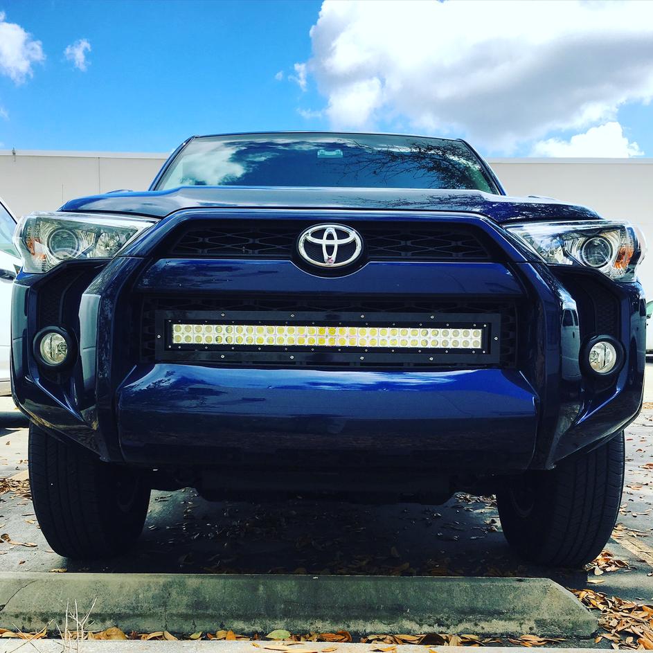

Thanks Mbumpus for you blazing the trail with the 32" Lightbar install in the grille. I decided to take on this project myself and did not realize what I was getting myself into...lol those pieces on the sides of the aluminum bumper really do get in the way but I managed to make it all work! Let me know what you think bud. I think it really turned out to give it a clean look.
Man that looks great!
I think this location is the best and most discrete location, but still completely functional.
Glad to see someone else follow my lead! Hopefully more will follow OUR lead now!

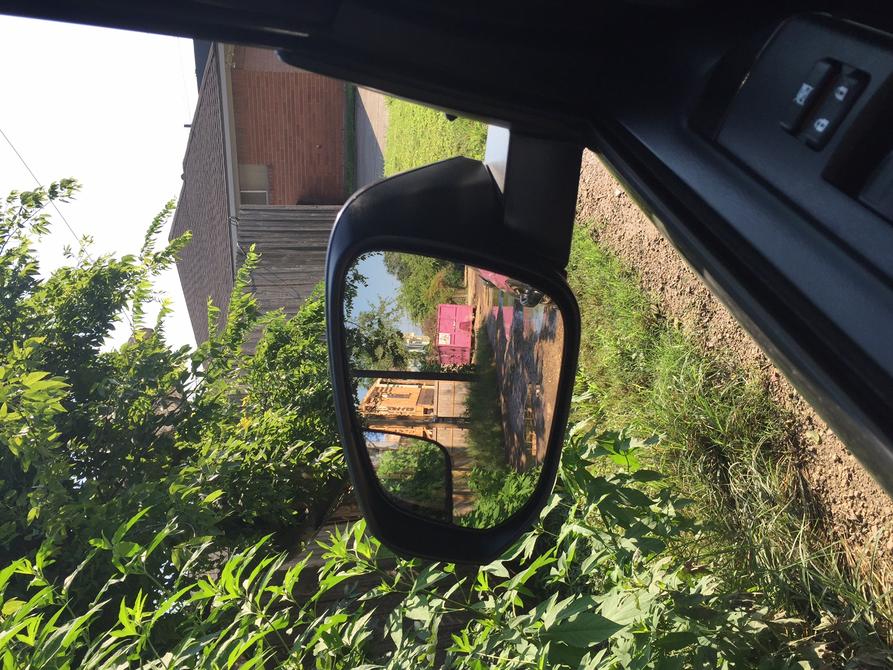

Ordered the RAV4 mirrors for the blind spot retrofit and they were a breeze to put on. Literally took about 10 minutes.
1. Angle both side mirrors all the way down and in
2. I took a flathead screwdriver and stuck it behind the top right of the mirror to get my fingers in a lightly work around to loosen the clips holding the mirror in
3. Pulled the mirror off the clips completely, then disconnected the heating element plug which is located on the top, inner corner of both mirrors.
4. Clipped the heating element plug back on and placed my whole hand flat on the mirror to apply light pressure until the first "click" was heard indicating the mirror was back in place.
5. Repeated on the other side
6. Cleaned fingerprints off the glass
Pics attached. Will add daylight pics tomorrow.
Edit ** - added daylight pic, but does anyone know how to get the pic to rotate?!

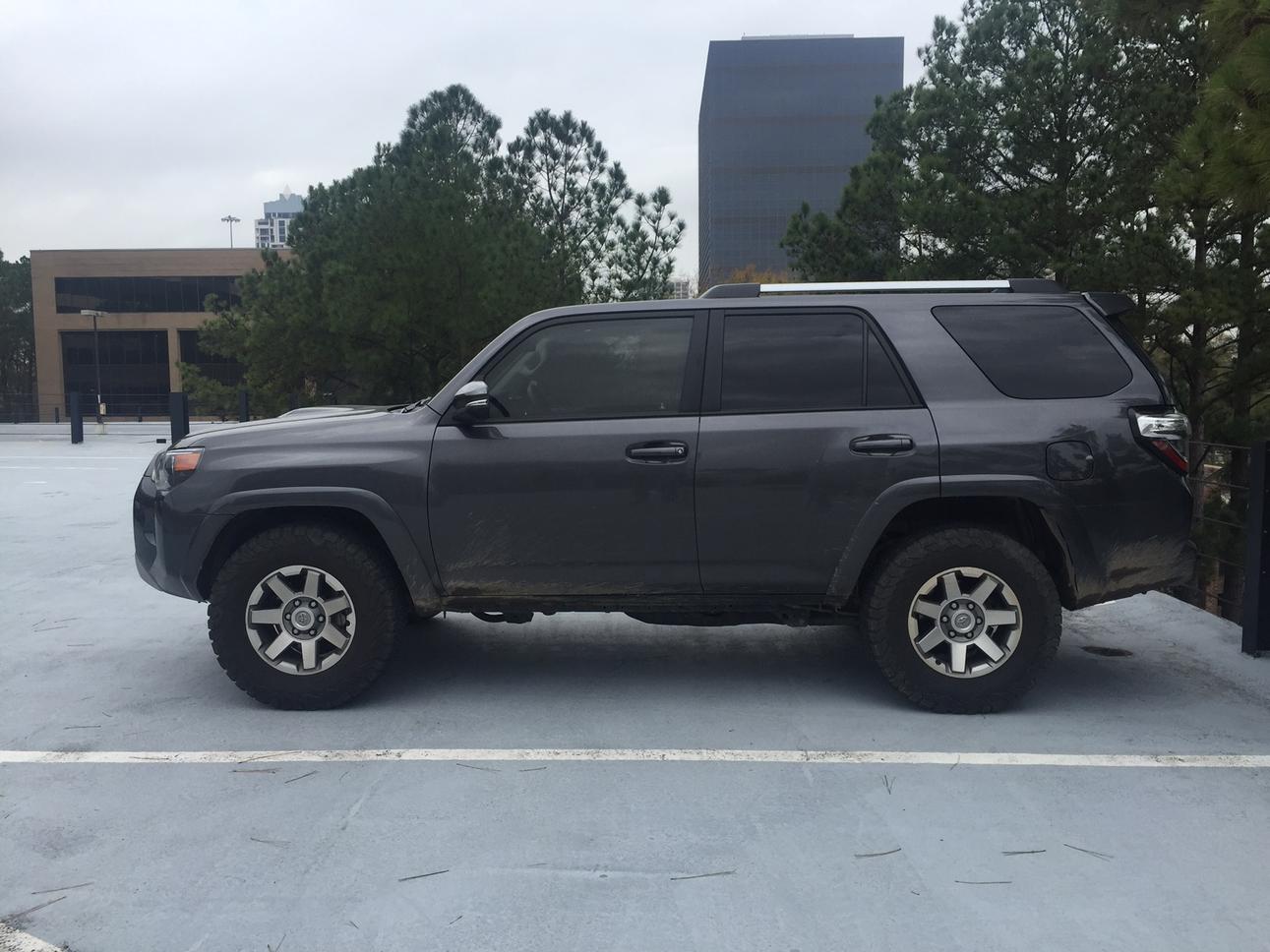

Took off my roof rails to overnight them to [MENTION=145761]Manny228[/MENTION]...trading for '10-'13 trail black rails!
Really easy process.
Pop off the black caps at the 3" and 7" marks with a flathead screwdriver to reveal bolts underneath
Then unscrew those bolts with a metric socket number 12, and it all comes off nice and easy
Boxed up, ready to go!
And now I have a bald 4Runner while I wait...
Got the '13 Trail rails in and put em on!
Make sure you have rubber washers if you do this switch. Otherwise your rails will be loose!
I got these from Lowe's and they worked perfectly:
Finished product (with my Thule crossbars on top)
