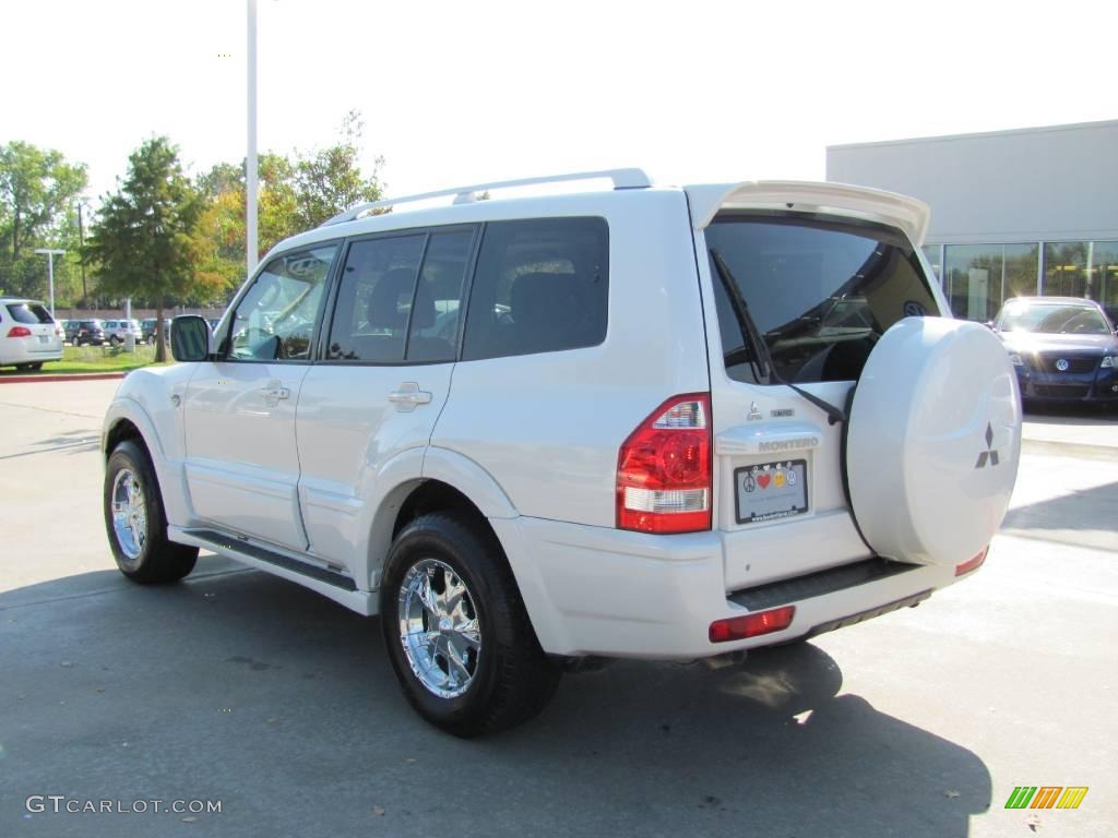

The look reminds me of an 03ish Montero. Especially the white one.
