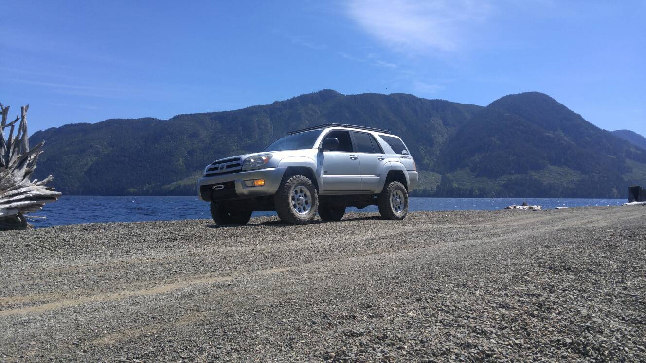

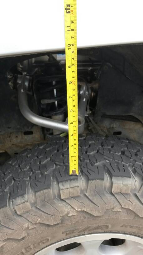

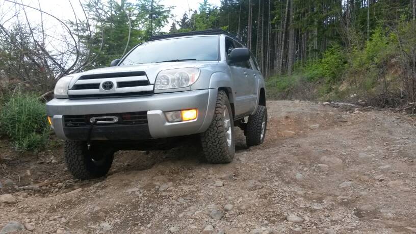

Hey all,
So here's the low down. I've got Bilstein 5100s @ the 2.5" notch, and FJ coils that had an unknown amount of mileage on them when I installed them. I'm starting to think they might have already been tired and sagging when I got them. I really don't think I got anything close to 3" of lift.
I also have a 1" body lift installed. It just doesn't look like 4" of total lift... Currently sitting on 275/70r17s and looking to go to 35s eventually. Might have to get some new springs!

Don't discount the weight of your winch mount and winch up front as well, that can sag the front end an inch.

I measured before and after the winch, and I only lost less than half an inch.

Sounds like you got 2.5". If you were shooting for 3" and then added a winch and bumper I'd say you are about where you should expect.
Plus the 1 inch body lift though. So somehow I only have 1.5 inch of suspension lift. Maybe 2 inch without the winch.

Another thing you need to consider is that the fender opening geometry is different between 03-05, and 06-09 model years. I believe the opening is slightly larger on later years (06+). So RonJR's measurements may not apply directly to your rig.
Also, you can't make the assumption that your travel envelope is determined by the amount of tire-to-wheel well clearance that you have. Odds are your lower control arm will bottom out on the bump stop before your tire reaches "full stuff" into that fender.

Yeah, the tape mwasure was there just because. I realize that number is irrelevant. And you're right, my bump stops on my LCA stop it much before full stuff.
