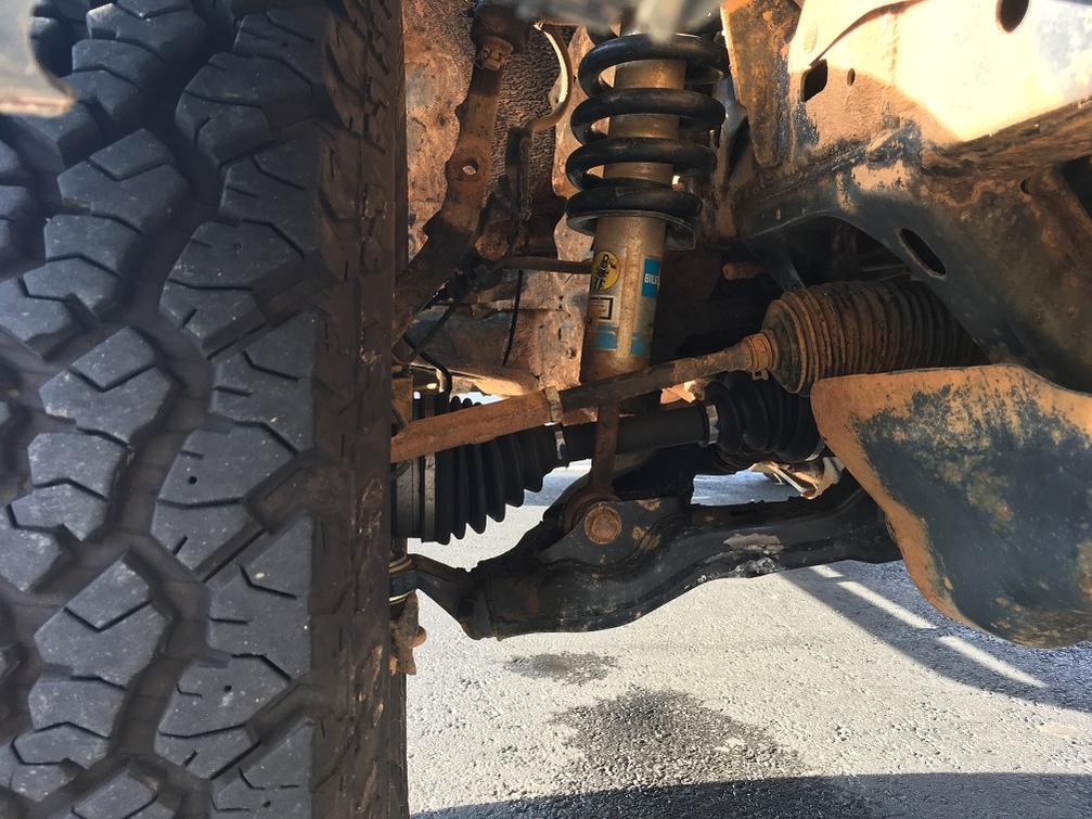

So my mechanic says that the way my lift is set up currently is dangerous because of the steering angles and angles that the CV axles are at... I have a 2008 4WD V8 with 5100s and OME 885s. I have seen plenty of other 4th gen runners with the same or similar set up, and I haven't read or heard anything about them having the same issues I seem to be having.
I went to get an alignment today and my passenger side inner tie rod was very very loose and they could not complete the alignment because of it. I just had all of my tie rods replaced less than 5 months ago, and also had my passenger side CV replaced less than 2 months ago. My mechanic said that everything was tight when it left the shop and he thinks the angles of my suspension are stressing my steering components.
Can anyone give me any input? Am i missing something?

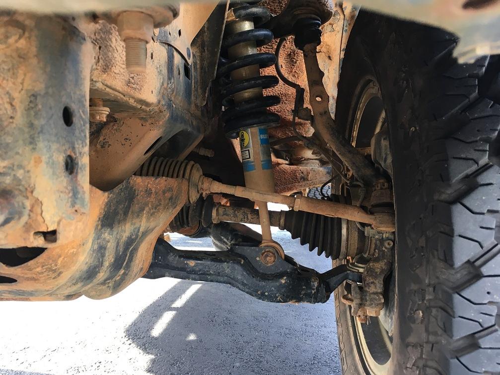

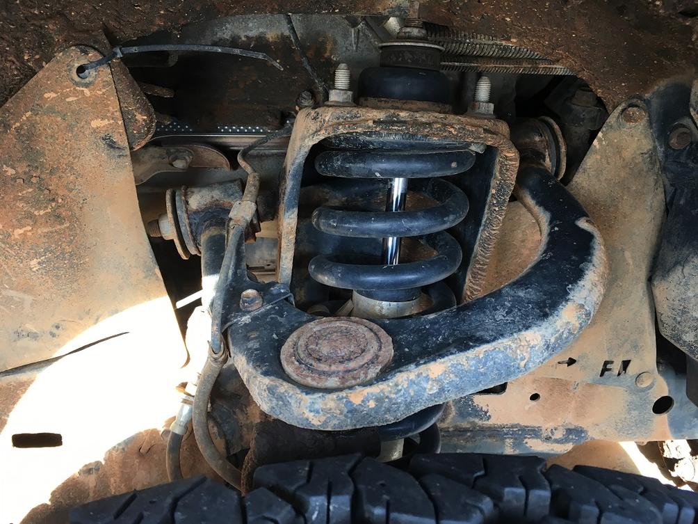

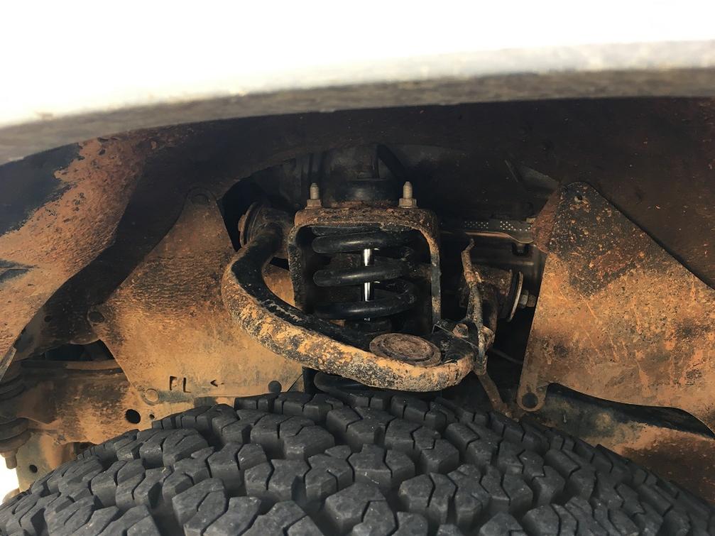

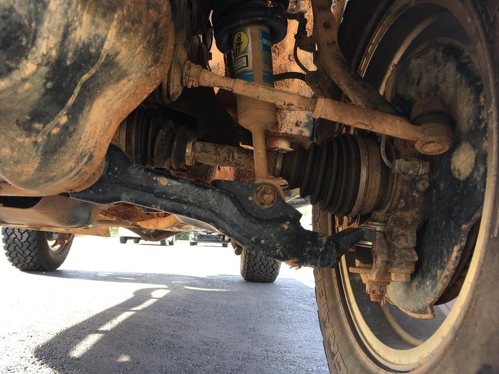

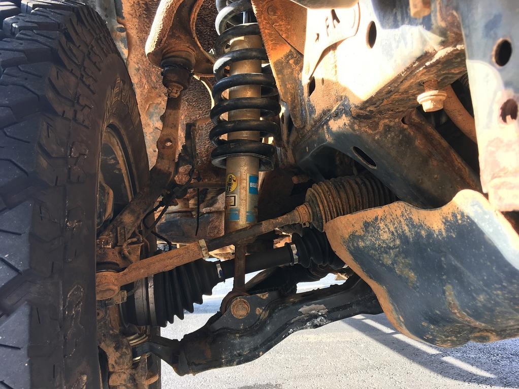

How tall are you? Pics of angles would help. Uca angle, cv angles, tie rods, etc. Take a pic of the front shocks too, the mounting perch.

Not sure how tall she is at the moment. I don't have a measuring tape with me. Here are a few pictures i just snapped:
>>>> no expert here but <<<<<
I don't see anything bad in those pics. In fact, your angles look better than mine. Then again, I'm new(er) to IFS and a bit, umm... :der:

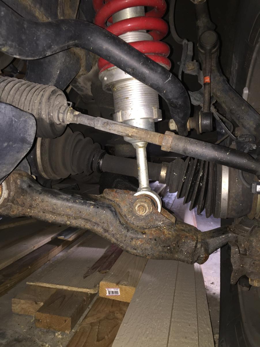

It doesn't look too bad from the photos. To help with the alignment you need to get new aftermarket upper control arms. Do you have a diff drop? Those cv angles look similar to mine and I have the kit installed. I have a 3 inch toytech lift.
It doesn't look too bad from the photos. To help with the alignment you need to get new upper control arms. Do you have a diff drop? Those cv angles look similar to mine and I have the kit installed.
I do not have a diff drop...
This is what I am saying. Everytime I take my truck to the shop he is saying it look sketch, but I have a "mild" lift in comparison to a lot of 4th gens I see...
I plan on getting new UCAs here soon but that shouldn't fix the issues that my mechanic is claiming there are.

[MENTION=93846]BigMike[/MENTION] - I hate to say it but, it might be time to look for a new mechanic, someone more familiar/comfortable with reasonably modified vehicles.

I have been thinking that.... I may take it to a local 4WD place and see what they say.
I don't have a dif drop, you don't need it unless you go 3.5"+ of lift.
Those angles look great. Either he used cheap parts, next time ask for receipts or other proof, or do it yourself. You'd be surprised how easy it really is. Make sure you check inner tie rods too.
