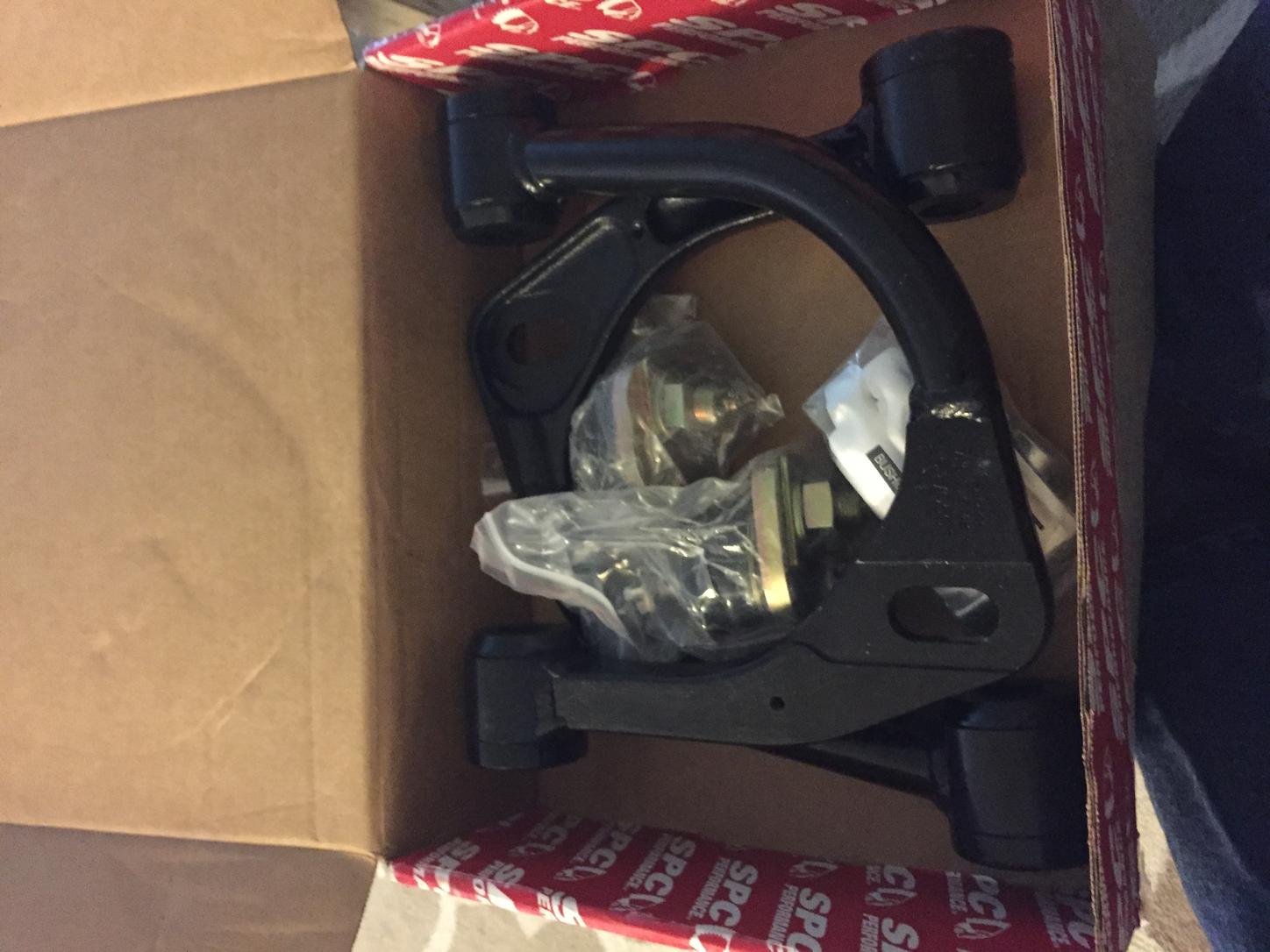

I probably beat it up off-road to be honest. I have a box at the house with some SPC arms to throw on soon...
