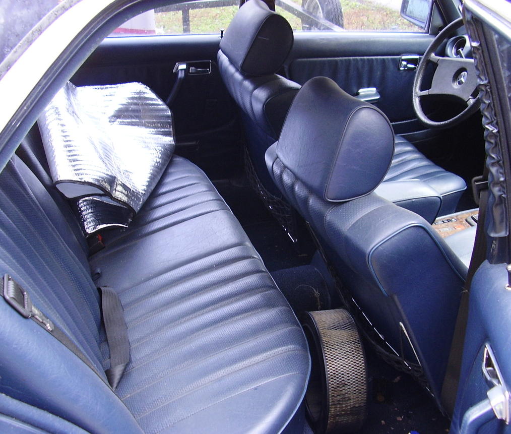

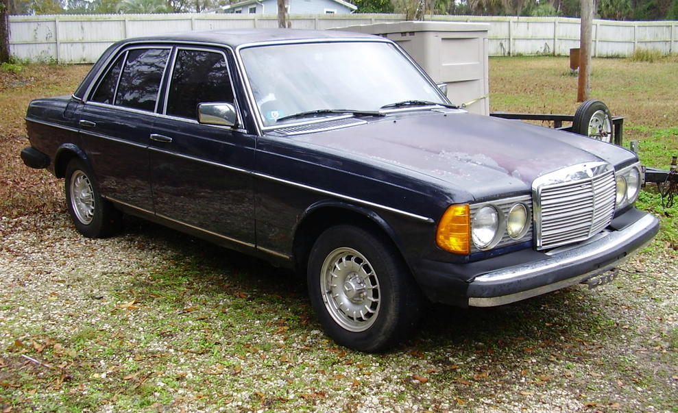

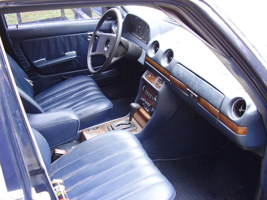

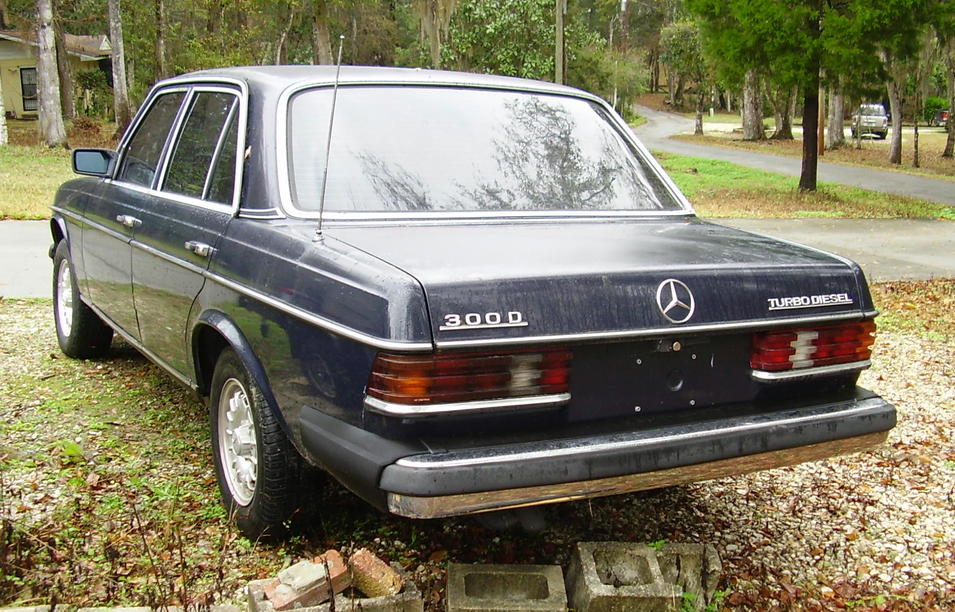

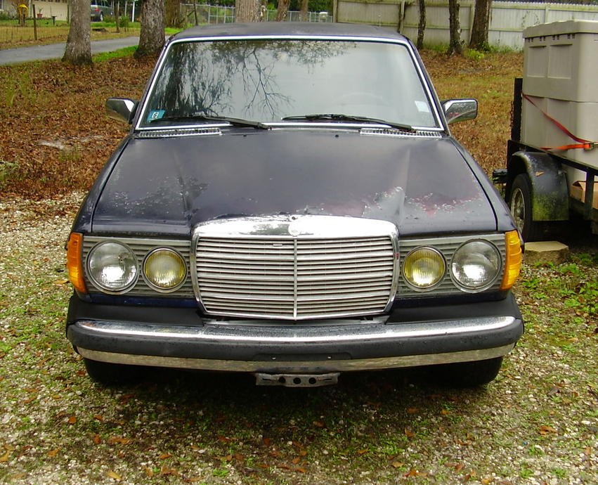

I just bought a 1982 Benz 300 Turbo Diesel car with 162K on the clock, the car runs great!!
here is my new Benz:party:

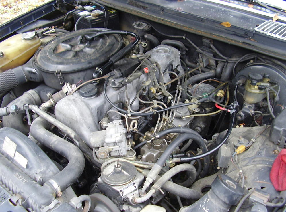

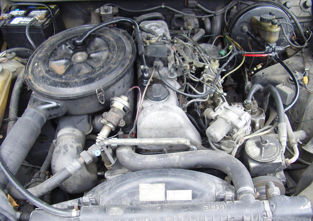

Hey guys here is the engine shots:)
I think I'm going to fix up the Benz as a driver then tag it for a month or two. I want to drive the car with diesel power to see how I like the performance and drivability. I should get a good idea of the fuel economy as well since the car weight and 4Runner weight is near the same.
